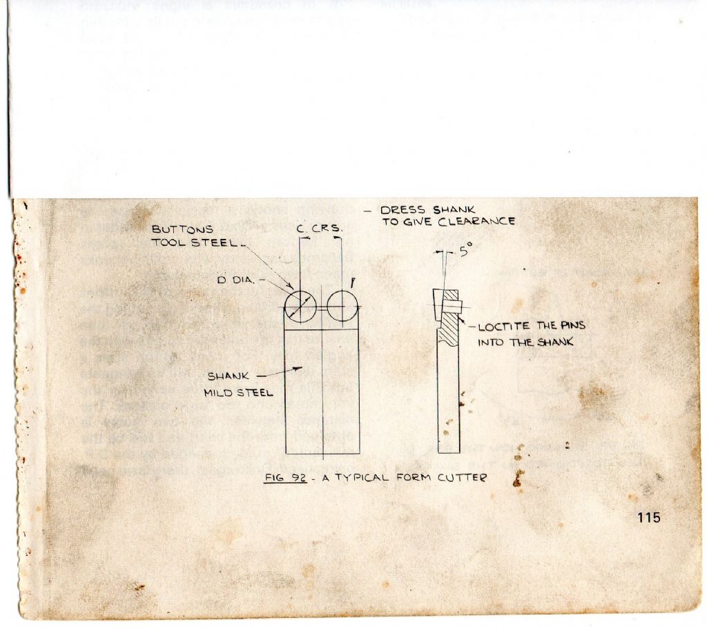

            Varying tooth thickness ,cause the sides of the cutter blank not
            parallel.
            Build a Eureka device and or make a two button tool
            to cut both sides of the gear cutter at the same time.

                                  A lot of your problems can be resolved by boring and facing one side
                                  of the cutter blank and marking that side and later on using this side
                                  as the datum for mounting the blank of the finished cutter on the arbor.
                                  The other side of the blank must be parallel to the datum side to
                                  0.00 or as close as.
                                  Secondly a two button tool will automatically give a constant width
                                  on all of the cutting teeth. Referring back to the photo in my previous post
                                  these 2 button tools some have parallel turned buttons that are hardened
                                  and then loctited into the holder,in the absence of a dro system a cheap
                                  clock gauge about £10 from China can easily be set up to give the
                                  required spacing, a metric clock gauge reading in .01 can be easily
                                  read to subdivide that to half or quarters.
                                  The holder seen here is the one in the book Gears and gear cutting
                                  and the clearance is provided by the 5 deg angle on the front.
                                  The only problem that you face then is the minimum spindle speed
                                  of your lathe which seems to be around 200 rpm ,to cut silver steel
                                  with hardened silver steel tooling at the diameter that you have you would
                                  need to be below 50 rpm , if you are unable to make adjustment to the
                                  machine to get down to these speeds the next best thing is to
                                  use a mandrel handle.Coating the tooling and cutter blank with RTD
                                  will make it a lot easier.
