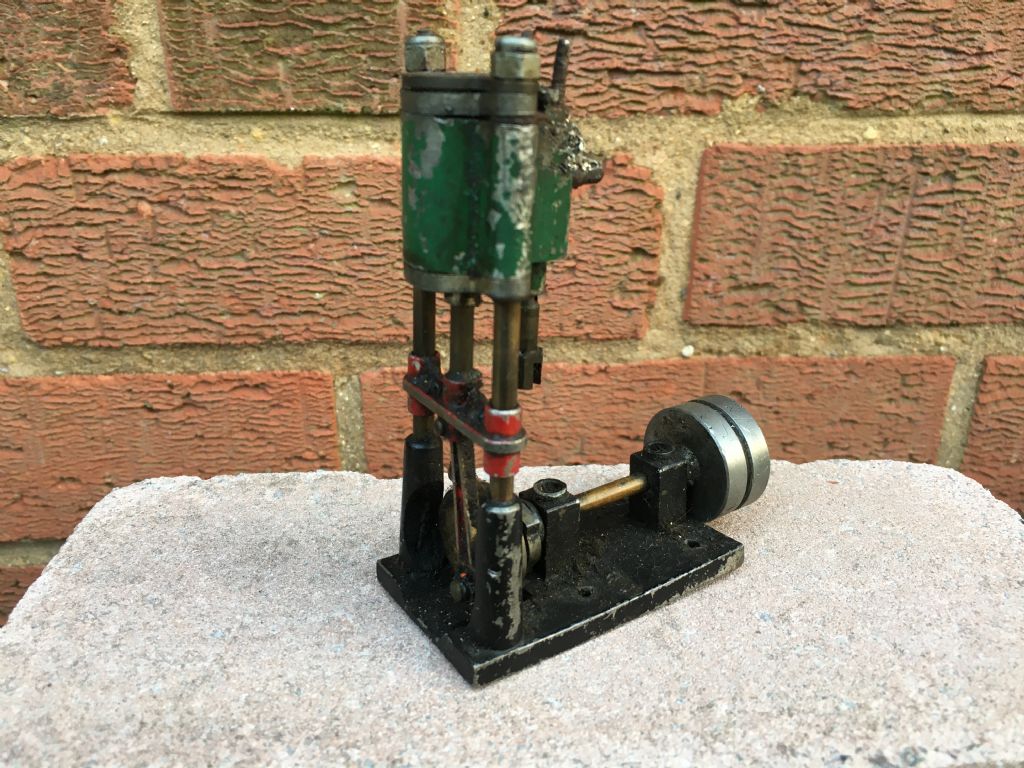

            This is a rather poorly NDC belonging to my son, the eccentric sheave is part of the crank disc.
            Regards. Mike.

                The strap and rod are broken and a solder repair has been attempted in the past. It seems to have just melted more of the rod away though.
                Mike.

                    Thank you so much for that Michael P, No excuse not to make one now!
                    I would probably have ended up with one of the bearing blocks between crank and eccentric had I not had those images.

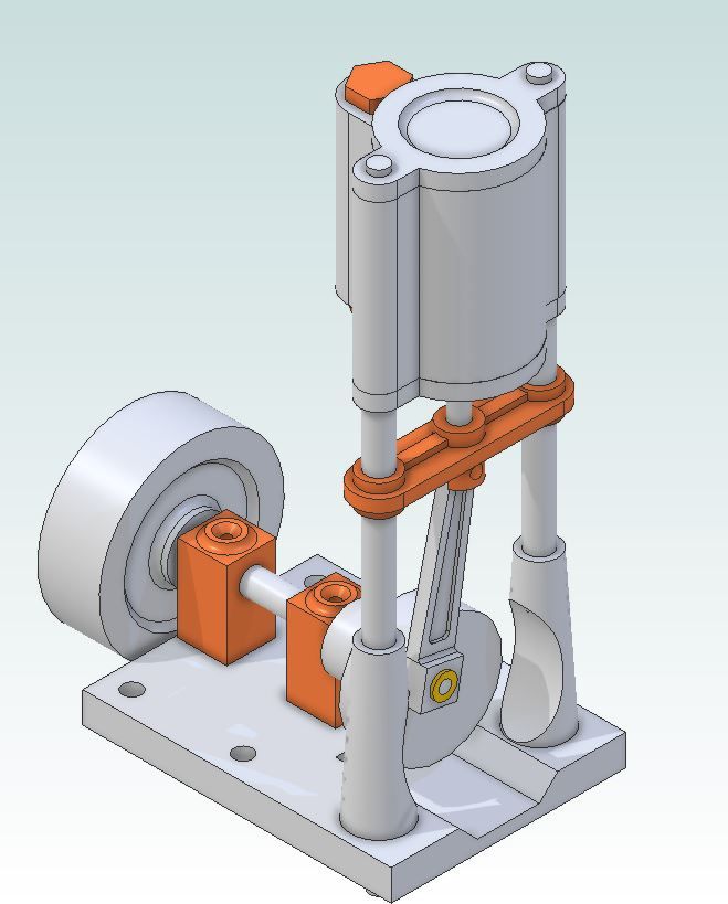

                                  I've made a start, decided on steel bearing posts with bronze bearings rather than solid bronze ones.
                                  Fresh out of the pickle.

                                      A bit more progress over the last week, cylinder still needs a bit more work and then the end covers will be profiled to a similar shape. I think this is the smallest flywheel I have made for an engine so will be interesting to see how it runs, I don't expect it to turn over as slowly as I like but that's not really what it was designed for.

                                        Almost done, just a lock nut to make and file down some plugs once the JBWeld has set then should be ready to try on air.

                                              Well the JBWeld set overnight but still needs filing down and I have not made the locknut either but thought I would try it on a bit of air. Locked at TDC the first time but an adjustment to the valve rod length soon had the valve centralised and off it went. Should be better with a decent air connection, gland packing and the aforementioned locknut plus a lick of paint but here is the rough and ready version.

                                                  Well the old Advert said it was enamelled in red and green so I did not have much colour choice, I also opted for a black bed as per Michael's photo.
                                                  I'm quite pleased with how it turned out and considering the small flywheel and short conrod runs reasonably slowly. Also allowed my to do my first double acting piston valve as I had only done single acting before and first time with rod cross head guides.
                                                  A video of it running, the table it is sitting on makes it sound a bit loud but soon quietens when I pick it up, it stopped because I put my finger over one of the exhausts. Also looks like a bit too much endplay in the crankshaft so will move the flywheel along a bit.
