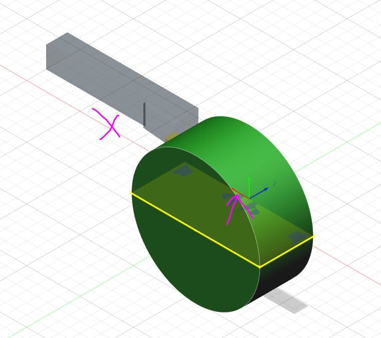

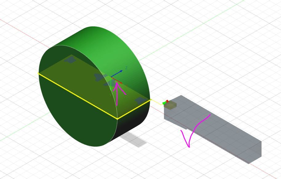

          When you do the setup of the stock make sure X is facing towards you then the tool comes up on the correct side. You can also edit the tool for forward or reverse rotation
          Should then cut like this view rotated as if looking fronm rear tailstock end.

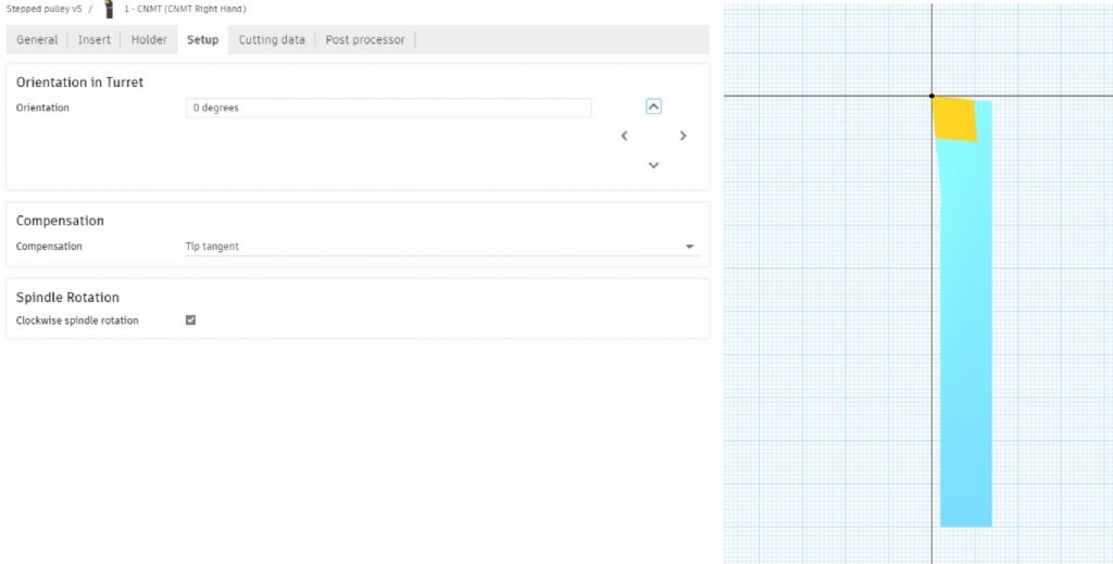

            When you select the tool use the Setup option in the Tool menu to orientate the tool correctly, you can Edit the tool after selection if you need to change anything.

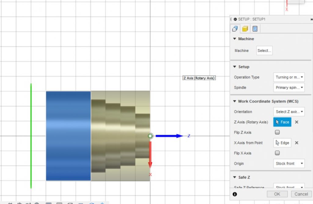

            Also when completing the work setup you can Flip the WCS direction for Z and X axis.
