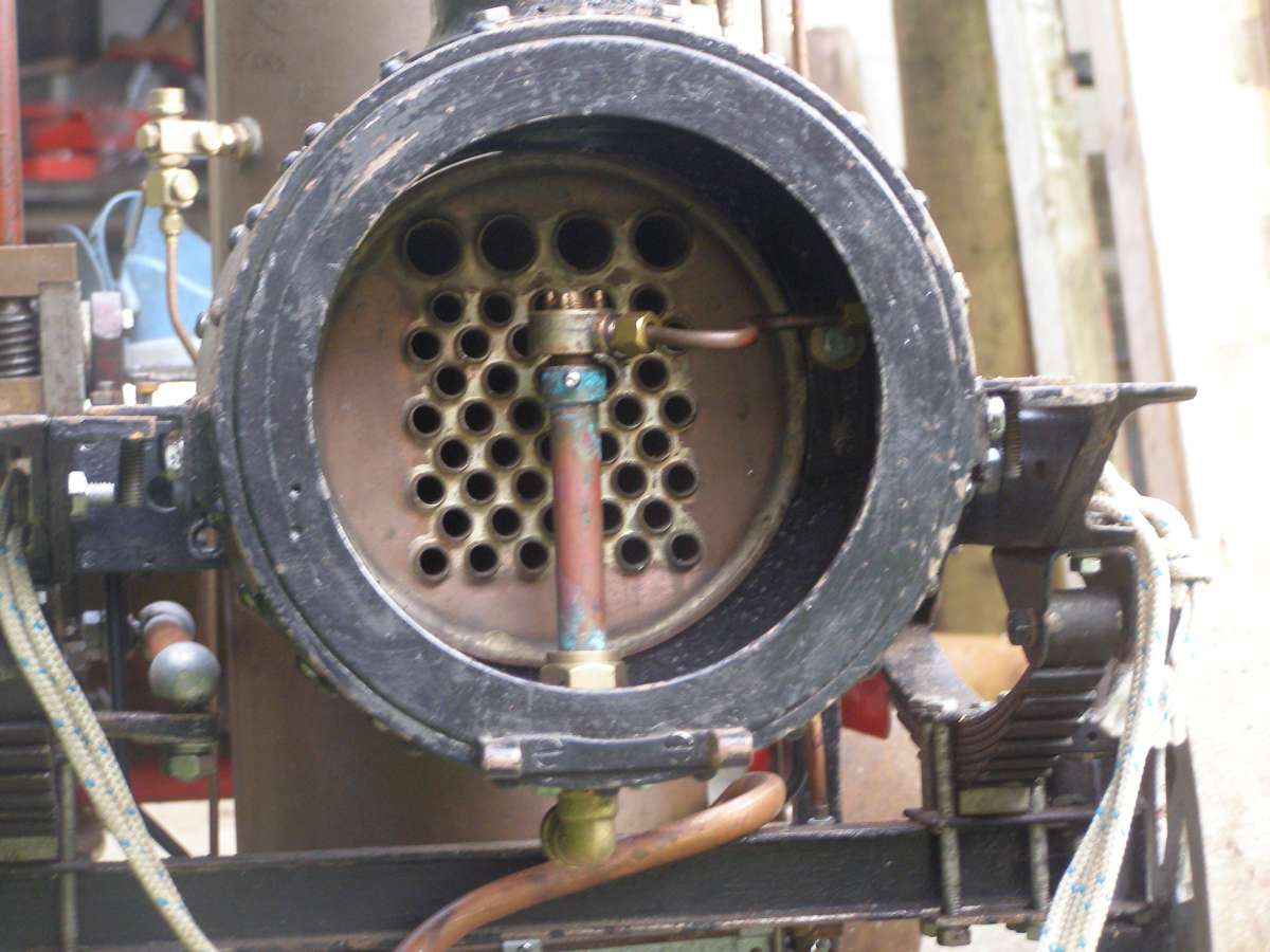

            I’ve looked more carefully and realised there is in fact far more room in there than I thought. The chimney choke is in the roof of the smoke-box.
            Putting the pipes to and from the superheater under the lagging is exactly what I had in mind – I think I had already said so. The smoke-box is considerably larger than the shell, allowing specially-made bulkhead unions through the adaptor flange. There is one for the blower pipe too, though I later re-routed that to a side-entry elbow. I can revert it to the original through-flange fitting.
            I don’t want them in the bunker for three reasons, apart from appearance: heat-loss / lagging difficulties, vulnerable to damage, and also because I am making the major assemblies like the superstructure to be readily removable for servicing.
            The two bunkers are joined together and held to the chassis by just a few screws through their floors, tapped into the chassis rail flanges.
            The smoke-box is not fastened to the boiler but apart from the plumbing, is held by just four screws and nuts into two brackets: remove them and slide it forwards. A cradle behind it supports the front-heavy boiler on a simple wooden Vee-block.
            Similar principles apply to the footplates and seats, platform and canopy. (The last, similar to that on a traction-engine, seems to have been an optional extra in 1908!)
            If I arrange things as above, the difference between prototypical and model pipe-work might not be too noticeable, and the driving regulator would be disguised as the starting-valve.

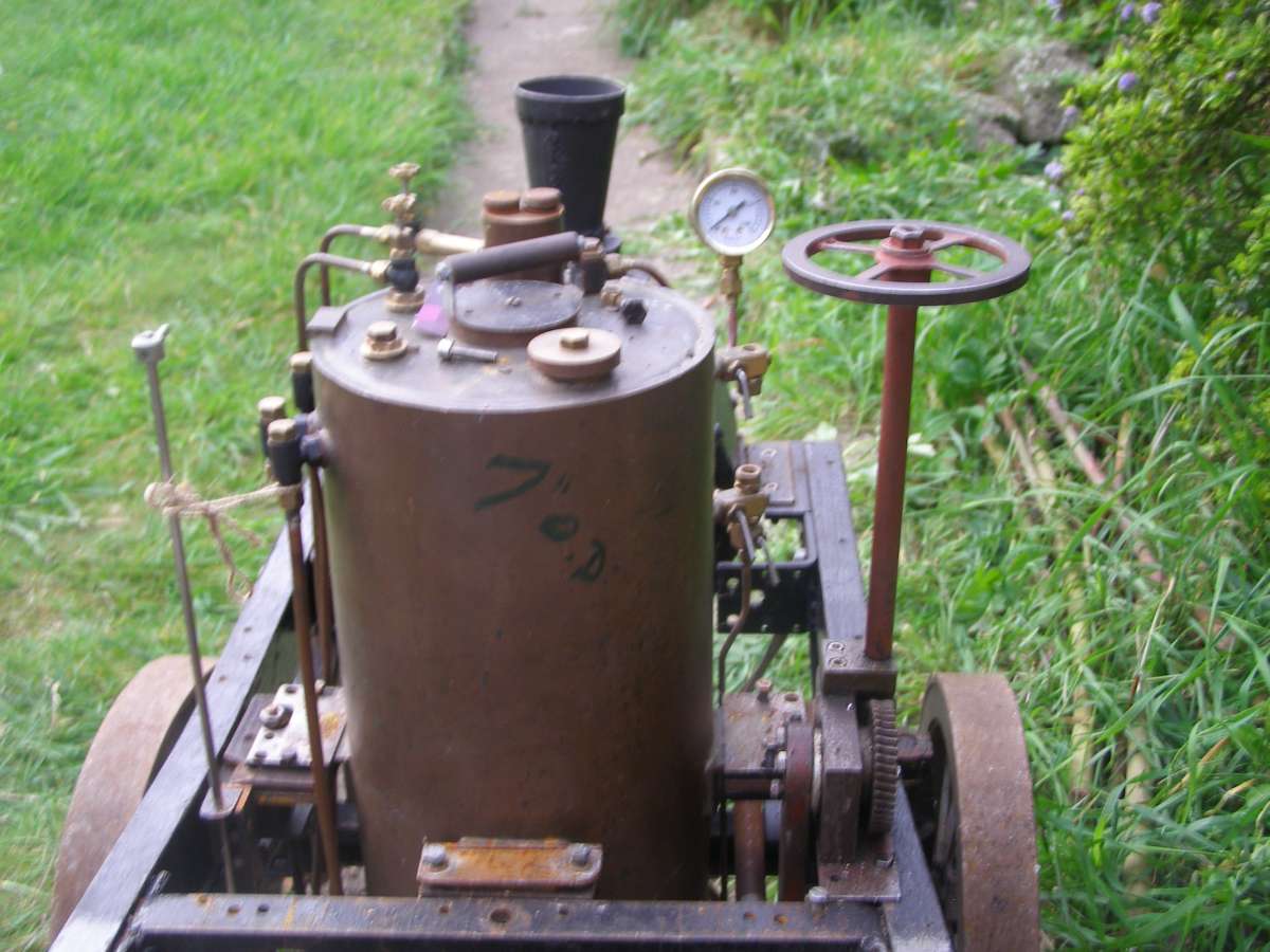

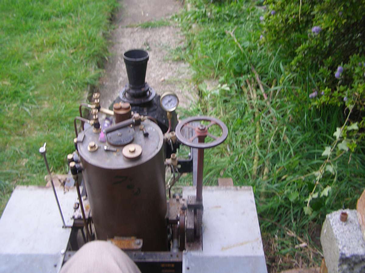

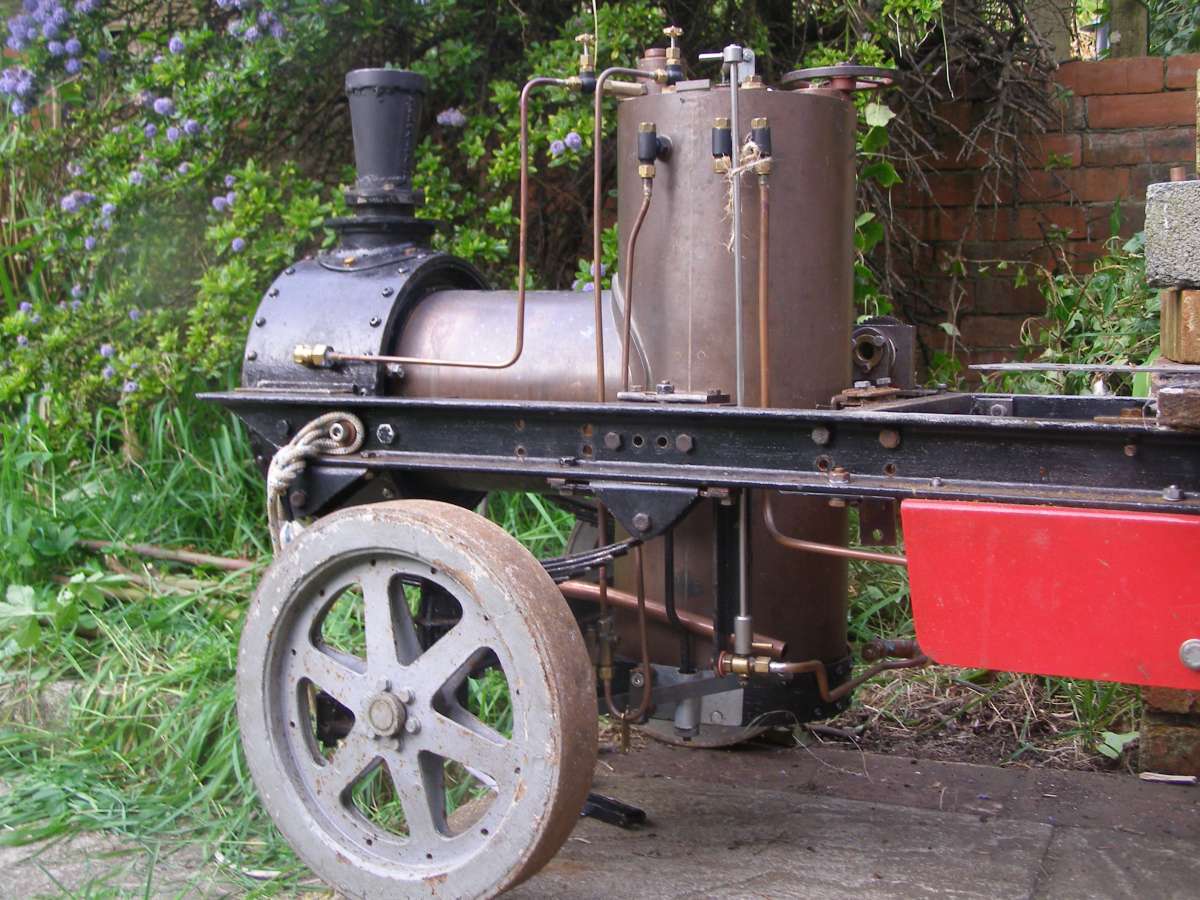

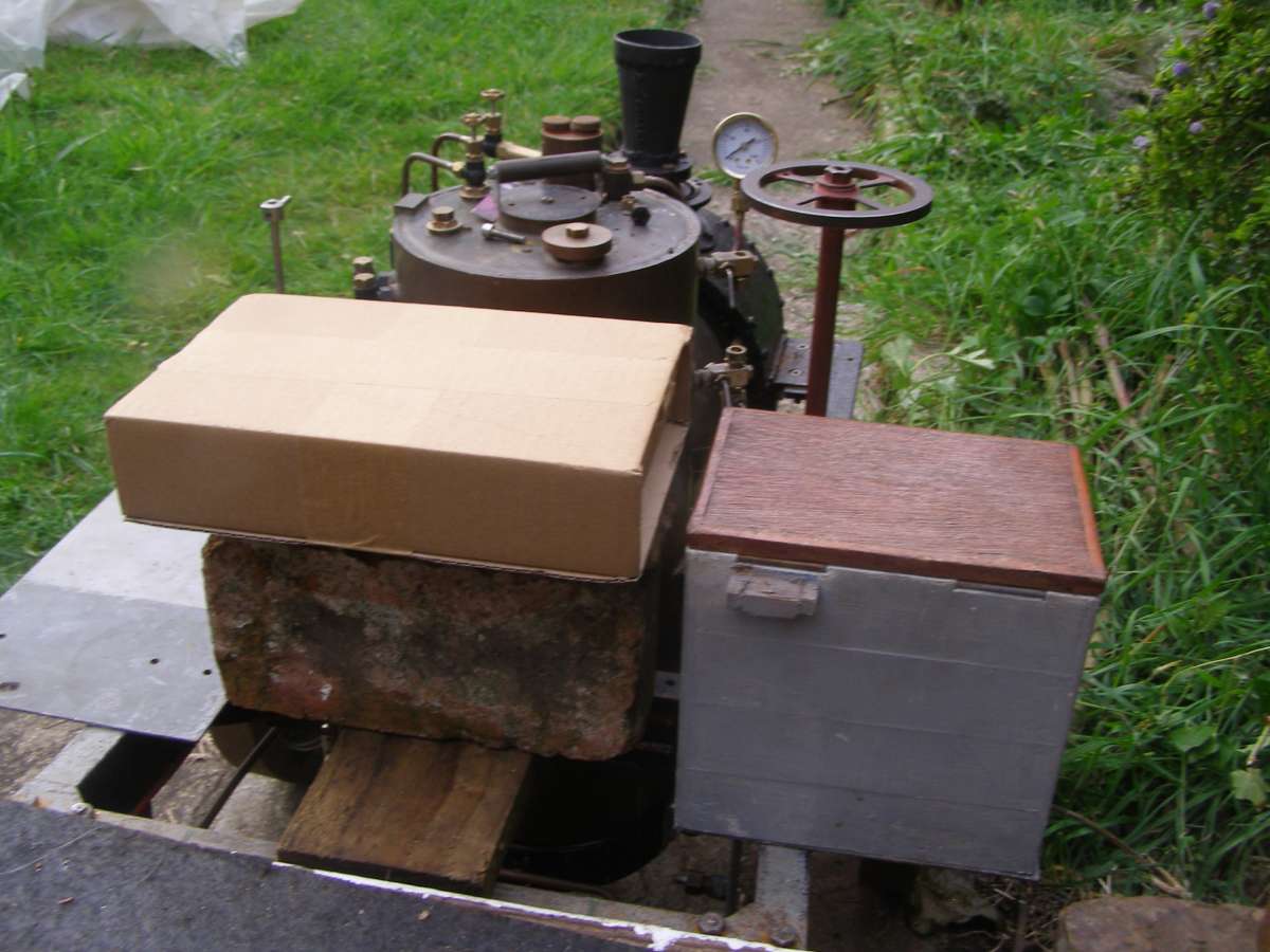

            I took these photographs this evening so now we know what we are up against:
            Approximate driver’s-eye views with and without the engine’s location very roughly approximated, and the darker grey areas showing the model seat positions. The steam take-off is the bronze disc, yet to be fitted with the correct flange-joint studs. Its central detail is a blanking-plug for hydraulic test. Temporary steering worm gear, and the steering-wheel is under-size and due for replacing. The pale oval thing is my knee as I perched on the vehicle!
            HLDV 08-05-24 View fwd engine approximated
            HLDV 08-05-24 Drivers Eye View 2
            HLDV 08-05-24 Front view fwd
            General view of the near-side. The original through-flange blower-pipe union is just visible behind the pipe. The superheater in and out connections are similarly placed on the off-side. Those extra holes in the chassis are now surplus to requirements, reflecting changes as I went along. The injector water-valve is an old motor-cycle type petrol-tank cock. The ash-pan is visible with one of its two suspension-rods. It proved extremely difficult to make a dropping grate and pan assembly for this, and my efforts merely created a horrible confection of steelwork.
            HLDV 08-05-24 NS Boiler
            Smoke-box. Flues approx. 11/16″ bore (how do I fit two pipes and their spear in that?). fire-tubes approx 3/8″ bore. 44 of ’em if I counted correctly. The original blower union is visible, blanked with a stainless-steel screw and nut. The wiggly pipe lying underneath is the engine exhaust-pipe disconnected so I could make the boiler front support. The axle-beam, made to represent the vague photographs, consists of two lengths of folded 14swg steel channel welded back-to-back and dressed to resemble a single I-beam.
            HLDV 08-05-24 Smokebox 2

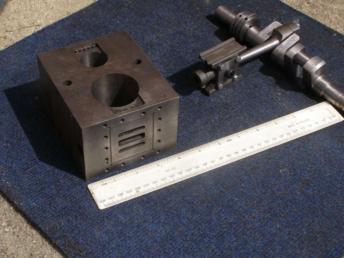

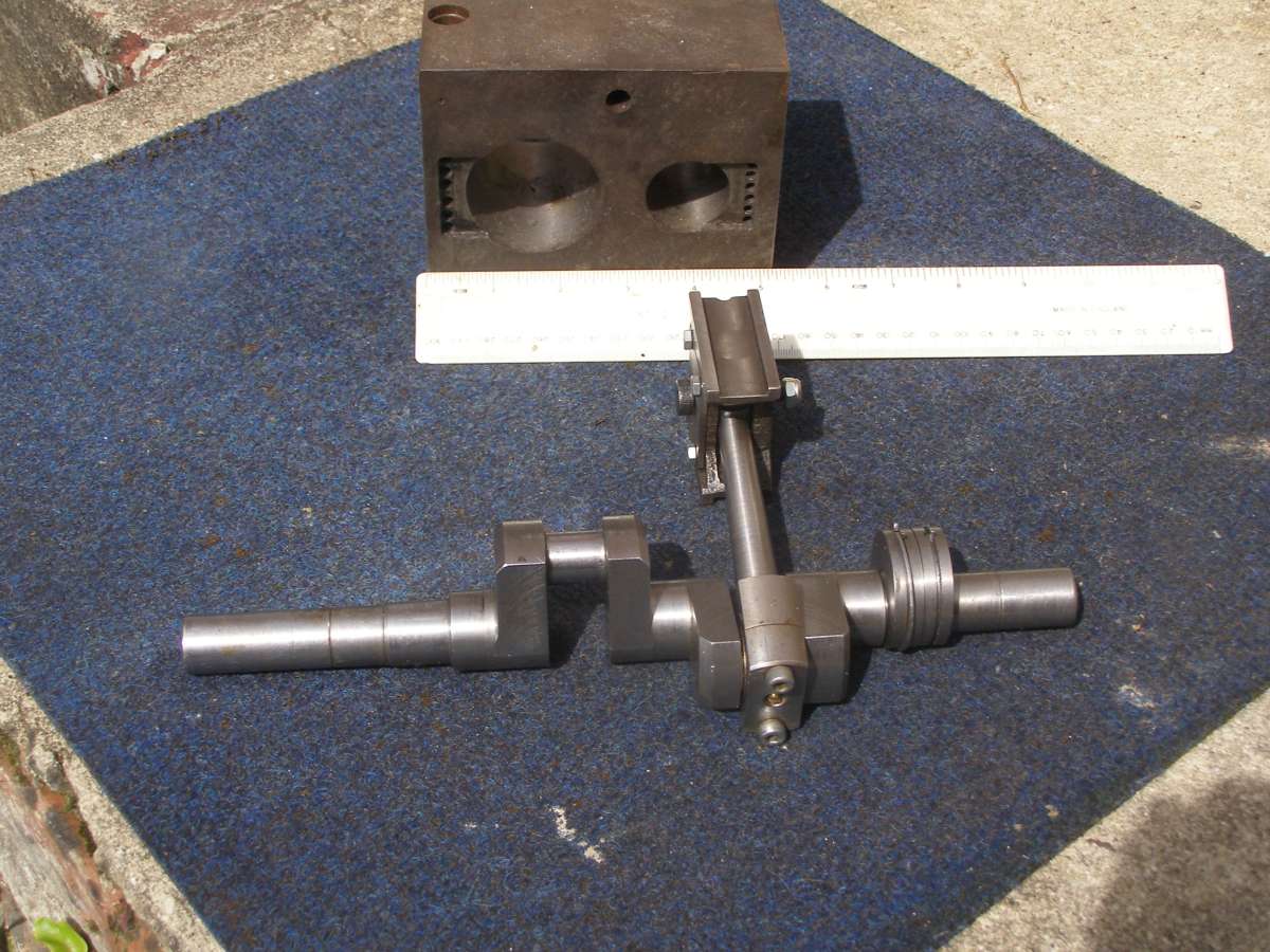

                                  These two photos might show some of the problems.
                                  The passages are drilled parallel to the surfaces as that was the easiest and safest way I had at the time, but this puts them close to the surface and gives a very narrow sealing area for the flat end-plates that hold the circular covers themselves.
                                  One option is to cut the ports faces right down to the passage floors, then machine sloping passages that meet the cylinders within the covers, and fit a new port-face to each with a ramp to create a new passage roofs.
                                  Those connecting-rods at 4.5″ centres are probably too short and I forget why I did that, given that I envisaged copying K.N. Harris’ Stephenson’s Link Motion designed for the ‘Maid of Kent’, needing connecting rods around 7″ centres. The little brass thing peeping out of the big-end is a grub-screw tapped through the turning-centre hole, as an anti-rotation pin for the half-brasses. An oil-hole is drilled down through the flank of the big-end, both for manual oiling and hopefully to collect oil trickling down the rod, at least when the engine is stopped.
                                  The cross-head castings happened to have been a pair in the waifs-and-strays tray on M.J. Engineering’s sales-stand! They were probably intended for a 7-1/4″ g loco. Those semicircular notches are oil-scrapers that divert “surplus” oil from the vertical guide-bars into holes drilled through to the cavity, to lubricate the small-end. The gudgeon-pin is a commercial item: one of those ground-shank socket-head screws intended as pivot-pins.
                                  I cut the crankshaft from solid, from a piece of old quarry tramway wagon axle! I did create proper drawings for this, one for the item itself, the other to guide how to make it from the “supplied” material. What I have not done is set it up between Vee-blocks to test for parallelism etc. Nor considered how it would drive the transmission-gears. I envisage possibly ball-bearing outer main bearings, but they can be plain bushes. The centre bearing will have to be split of course, leaded-bronze or cast-iron lined.
                                  The cast-iron eccentric sheaves are retained in the mild-steel straps by circlip-like sheet-steel rings (I may replace with brass). This allowed turning the bearing surface right across in a simple sliding cut. A gap in the ring allows access to the grub-screw. I thought I’d need prevent the ring from rotating but realised it would not matter if it does.
                                  I spent several hours on the project this afternoon and evening, towards completing the boiler ancilliaries. My aim is to complete the steam-making department first to a satisfactory point, then concentrate on the engine and transmission, though it’s not to a set schedule and I might well move from one area to another.
                                  HLDV 10-05-24 C-shaft + cyl 1
                                  HLDV 10-05-24 C-shaft + cyl 5
