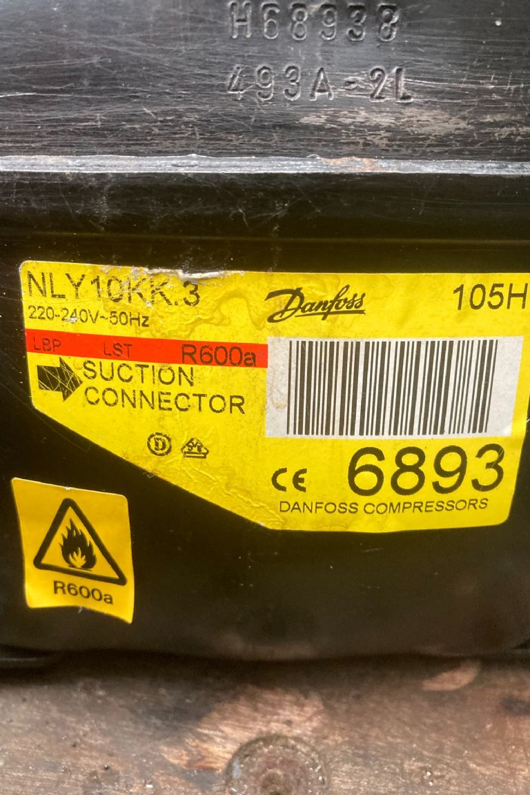

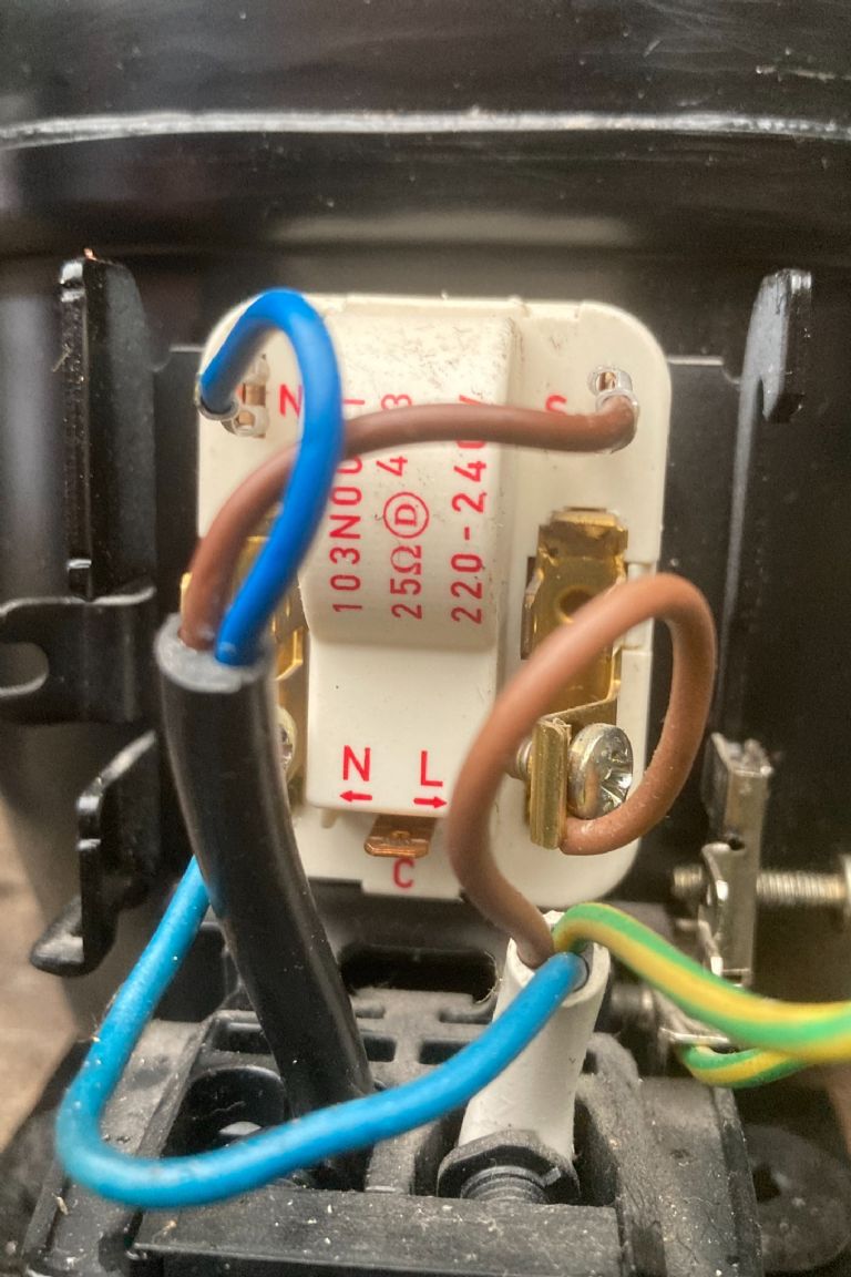

      Today I was given the compressor as shown below , As can be seen the power and earth wiring is in place as is the capacitor, however it will not run .
      i have done a basic test and there is continuity in the wires and no shorting .
      i am aware that it would normally have thermostat, door switch , lighting on its circuit , and these are not attached, so ! , is there a way of fooling it to think it’s got all its bits , in an effort to get it running ?
      Any advice or suggestions will be appreciated ( provided it concerns the topic in question smiley)

          Are all refrigerant lines and heat exchangers intact , and is refrigerant present and at correct "compressor off" pressure? Many modern refrigeration compressors will not run if the refrigerant is not present at the correct pressure. (at least on ones in North America that I have had dealings with)

            You need to connect a switch (or link) between Live and the C terminal (un-connected in your diagram)
            Manual is here https://manualzz.com/doc/53379116/danfoss-nly15kk.3-high-energy-optimized-compressor-r600a-…
            Note that these units need oil for lubrication. SAE 32 "hydraulic" oil as used in many lathes should be OK.
            They are also not suited to frequent stop / start cycles. They can produce significant pressures once running but won't start up against a high pressure head.

              Umm, don't hold me to it, but I think the tag above the live screw terminal should be connected to C.
              Normally the compressor is switched by a thermostat which is missing. I believe the thermostat is a simple on/off switch so a wire between C and L should turn the motor on.

                        SOD : there was a black wire connected to terminal “C” , will have a go with your suggestion , unless there are other definitive directions given .

                                Your pictures do not show clearly if the wires are connected to a starter. There were several types, some did not take kindly to stopping and restarting regularly or at short intervals. Noel

                                  The start relay would be the cream (off white) coloured device.

                                            Connect your pressure switch between terminal C (bottom middle) and live (spare tag above brown wire is good place). That is all you need.
                                            For testing just put a manual switch between C and live.
                                            The start timer and overload cutout are under the white(ish) plastic moulding.
                                            I first used a fridge compressor as an air compressor about 45 years ago.
                                            As I mentioned before they have trouble starting against a head of pressure. You will probably need a non-return valve between the compressor and air receiver and either a depressurisation valve or small leak between compressor and NRV. Some of the Bambis use a NRV and a small normally open solenoid valve with the coil in parallel with the compressor to depressurise. A possibility to avoid the NRV is a 3 port valve with common to compressor, power off open port to vent and power on open to air receiver. However not all designs of 3 port valve will hold back pressure on the closed port.
