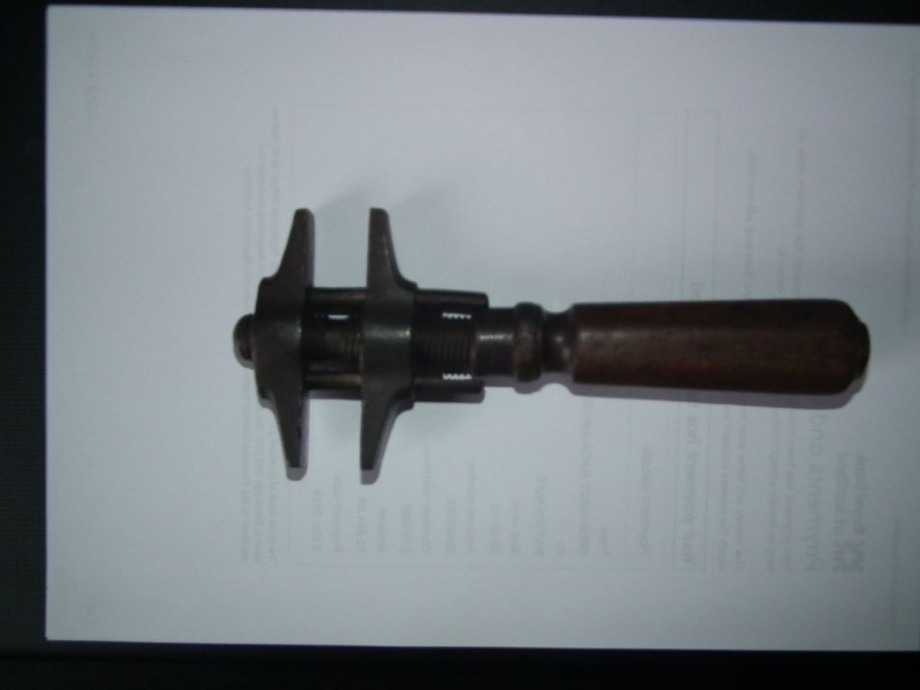

              Here's one I found locally (in France):
              Edited By Russell Eberhardt on 28/05/2023 14:16:11
              #646756
                O.K. Russell … Someone has to ask, so it might as well be me !
                What is the idea behind having two sets of jaws ?
                My first guess was that it’s a joke [i.e. one for use on left-hand threads, and t’other for right-hand]
                Then I realised it could be useful to put a similar-size nut in the ‘unused’ set … to keep the clamping parallel.
                Or does it in fact allow the spanner to serve another purpose ?

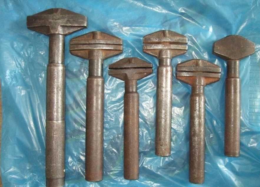

                Sonic Escape
                  @sonicescape38234
                  This was a common type of adjustable wrench in Romania. They are called "French wrench" here. But actually it was made in Romania. There were 3 sizes, this one is the middle one. When working fine it is my favorite wrench. They feel very solid and you can use it also as a mini vise or to clamp things.
                  When I was a child I used it to crack nuts. Unlike a pair of pliers, the nuts didn't crush too much.
                  I never used vinegar to remove rust. I think I'll give it a try. Does it matter if it has a lot of grease inside?
                  This is how the three variants looks like. The last one to the right is a different model.
                  Edited By Sonic Escape on 28/05/2023 15:01:48

                                #646945
                                  Thanks, Russell … If I ever find an explanation I must remember to post it here.
                                  Meanwhile: This should be of interest
                                  Edited By Michael Gilligan on 30/05/2023 09:02:30
                                  #646973
                                  Rolster
                                    @rolster
                                    As pointed out these are very basic wrenches, so the idea is just to screw one end in and out until one side of the jaws or the other fits the nut or faces you want to wrench on.
                                    The two jaws allows a half pitch distance to be achieved so you can get close enough to the faces distance. its not meant to be a precision wrench and used to be more oftern used on agricultural machinery with square nuts rather than modern hexagon types.
                                    Always expect to be corrected on this but was my understanding on these from a long time ago.
