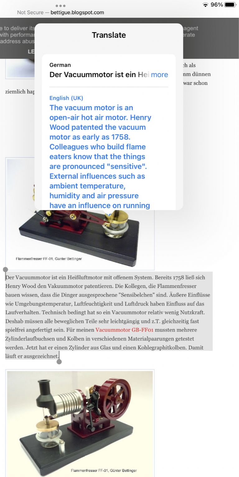

      Flame Licker Running a Generator and lighting an LED bulb. These small engines interest me a lot and they are capable of doing some work, a little different from my main hobby of toy steam and model steam engines.

          Contemplating the [very small, but clearly non-zero] power output of this engine somehow led me to find this site:
          **LINK** http://bettigue.blogspot.com
          It is full of wonders and I think you will enjoy a visit
          … The text is in German, but that’s no great problem these days.

              Here is a German patent from 2015 which cites Henry Wood, and briefly describes the working of the engine:
              **LINK**
              https://patents.google.com/patent/DE202015004768U1/de#
              The text is viewable in English
