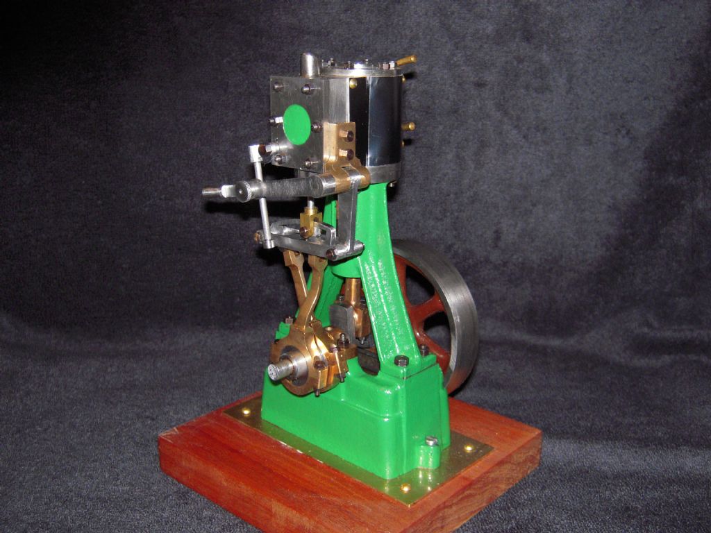

      Hi all,
      Looking for recommendations for a first model. Was thinking about one of the Stuart casting kits, possible the S10V, but wondered if there was anything else I should consider.
      I have a Warco WM 300, which will turn about 8” over the bed and has a milling head as well, so, with in reason size is not an issue, but it seems the cost goes up dramatically with size!
      Thanks in advance
      Paul

                          Is this your first use of the machines to make anything or just your first engine?
                          The Stuart 10V and S50 have long been the usual first engine from casting for those from the UK. having just taken delivery of a couple of Stuart castings the quality looks very good and at least if there is a problem with one of the castings you can easily get it exchanged if you bought it from the current owners,
                          If you want to try something that need no or just a couple of castings then I'll blow my own trumpet and suggest the Muncaster No1 or the Jowitt nothing too complex, inexpensive pile of materials and will give your mill a bit more of a workout.

                                      I built a 10v first, I’ve got an s50 on the bench now. Choose something that inspires you. Lots of great advice on here and my first model was definitely in the dimensioned to where it touches level of build. Second one much better.
                                      Stuart will sell you additional castings should the worse happen.
                                      #588257
                                      Redsetter
                                        @redsetter
                                        The most important thing is to build something you like.
                                        Having built a Trojan and several Stuart 10s and an S50, all using a lathe only, I think the Trojan is possibly the easiest, although there is very little in it. I built mine from scraps of plate and bar stock, and just bought the Reeves cylinder castings, and it makes a neat engine although it is quite small. The drawings are well detailed.
                                        The 10V is perhaps slightly easier than the 10H, but the latter makes a nicer working model as the motion is more visible. The S50 arguably looks best of all when finished, but is not as simple as it appears. There is no crankshaft to worry about, but several operations may be tricky for a novice. Also the main bearing design is poor and as a result it cannot be expected to develop much power.
                                        I would not bother with small oscillating engines. A slide valve engine has more parts, but is no harder to make and is a lot more interesting and realistic.
