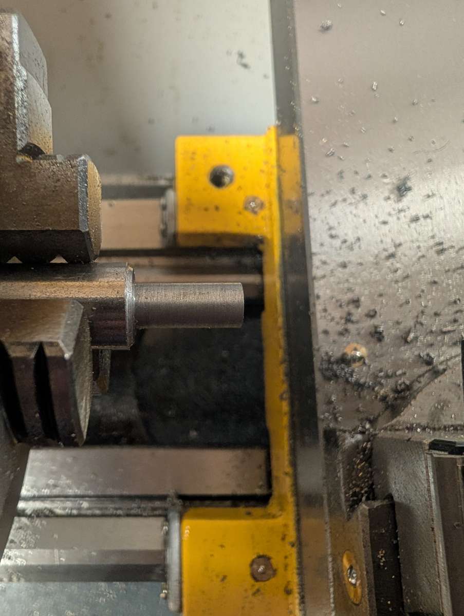

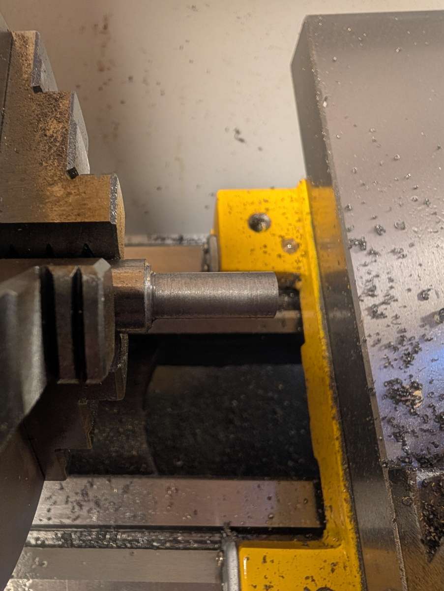

      I finally received today the metal I ordered couple of weeks ago (thanks Evri for loosing the first parcel.. 🙄)
      Cutting in steel was a complete disaster. I tried using the leadscrew feed, tightened everything I could, checked my tool angles, etc but no, no success. My guess is that the stock protrudes too much and should be supported by a center. Will try that tomorrow.

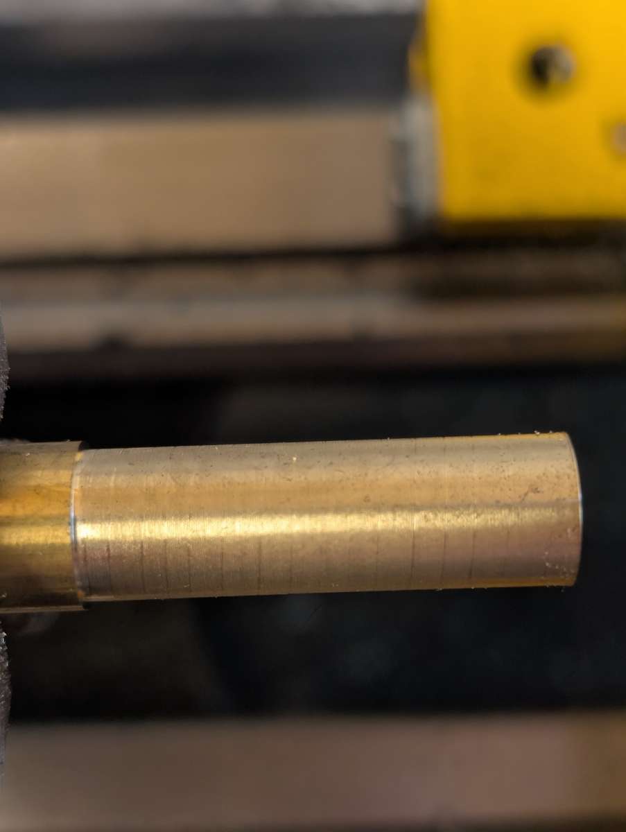

      I was a bit more lucky with brass. Using the leadscrew feed (via half but) gave an acceptable result.
      It is quite hard to manually feed at a constant rate without any stop.
      But was fun nonetheless!

        My own rule of thumb for material stick out past the chuck is an absolute maximum of 3 times it’s diameter Chris. Even after about 2 times for length, I’d probably still use a live center. Although the expected depth of cut also is part of it. Deeper depths of cut needs tail stock support sooner. What alloy of steel is that? Are you 100% sure your cutting tool tip was on the lathe center line?
        Then there’s part rpm. In general for most steels and with high speed cutting tools, that’s around 100 feet per minute maximum. Maybe 300-500 feet per minute with carbide. Measure your parts O.D. multiply by 4 as a round number, that’s your part circumference plus a bit. Divide that into what percentage of a foot or it’s metric equivalent is for your part, Use that 100 feet per minute or it’s metric equivalent, divide that by your percentage of that foot / metric for your maximum allowable rpm on the part. Although I prefer dropping that by around 15% – 20% because the cutting tool edges last quite a bit longer.
        Power feed or even hand rate is also important. Under power I look for at least .002″ of feed or higher per part revolution. But that’s not completely possible with very tiny parts. Going too slow will cause the tools to rub and not cut well. And any rubbing quickly dulls the tool cutting edge. Feeding too slow isn’t linear and may not produce the best surface finish over a higher feed rate.
        The hand crank on the hand wheels is mostly for large, quick and non cutting moves. Try using one hand on the outside of the hand wheels outer diameter and go far enough to then start to use your second hand to maintain that same feed rate. You then go hand over hand, or on smaller hand wheels use your fingers on each hand to do the same. Some steel alloys and especially some stainless will easily work harden in a literal instant. If the tool isn’t being fed into the work and actually cutting, it has to be withdrawn as quickly as possible. In less than a second if you can do it. The exact same is equally true even when drilling. It’s the heat produced while cutting or with abrasive materials that destroys cutting tools including carbide or even diamond tipped tools which you’ll probably never use. All materials have maximum limits for just how fast they can be machined without destroying the cutting tool edges. That’s a law of physics and can’t be broken with any chance of success.
        Industrial recommendations for maximum tool and part rpms usually assume extremely rigid machines and flood coolant is available. Since we don’t have it and our machines are far lighter, any of those recommendations need to be reduced, sometimes by quite a bit. With industrial machining, time is money. Tool life is less important for them than maximum part production speed. Our needs are usually the reverse of that, cutting edge life and cost is far more important for us.
        Learn to pay attention to the color of your chips when cutting steel. With high speed steel cutting tools, NO color change at all to even a very light yellow. The tool will still continue to cut at that color, but tool life will be reduced. With carbide, at most a light to medium blue color AFTER the chip leaves the cutting tool and not as the chip is being formed. Dark blue to purple is common on some Youtube videos, but that’s usually with much heavier lathes. And while impressive looking, it still reduces cutting edge life by quite a bit. The dark blue or purple colored chip guys never seem to mention that. With the correct cutting tool angles for the material being cut, the majority of the developed cutting heat should come off in the chip and very little created in the work piece itself. And dull tools always create much more heat. That should be enough to get you started.

          Post a photo of the cutting tool in the toolpost that you used on the steel, looks like it had quite a rounded end which is not ideal.
          As for handfeeding use TWO hands on the rim of the wheel turning with one while you reposition the othet then turn with that while you reposition the first. The crank handle is not what you want to use for a good finish.

                The finish on the steel is really awful but is nothing to do with stick out. I’d agree with John and suggest it is at least partly the material.
                The finish on the brass is poor too and there is a spiral where the tool has been wound back to the starting point. That implies the setup isn’t very rigid, or there is something wrong with the tool. If the issue was stick out then the depth of the spiral would get deeper further out from the chuck. The depth seems quite consistent so stick out is not the issue.

                    Looks like cold drawn, which can be a bugger to cut nicely even if in a ‘free cutting’ alloy

                      The digging and tearing put me in the mind the tool could be below centre, blunt, to deeper cut or the material is not for turning. Once you know or have some idea you will know which may be the cause. Buy some material you know will work eg free cutting steel and have a go. The book, Lathe work – a complete course, No 34 in the workshop series is a good start at about £8. It will get you started on the how’s and why’s.. If your bar ls 3/4″ (20mm ) Then run the lathe at about 500 rpm. Set centre height by offering the top of the cutter to the tailstock centre first then using a bit of short (1″) scrap with only 1/2″ stick out, face the end and see that it’s correct, To low will leave a pip, to high will try to push the pip off, adjust as necessary. Beer can Etc makes good shim to effect adjustment.  Good Luck. Noel.

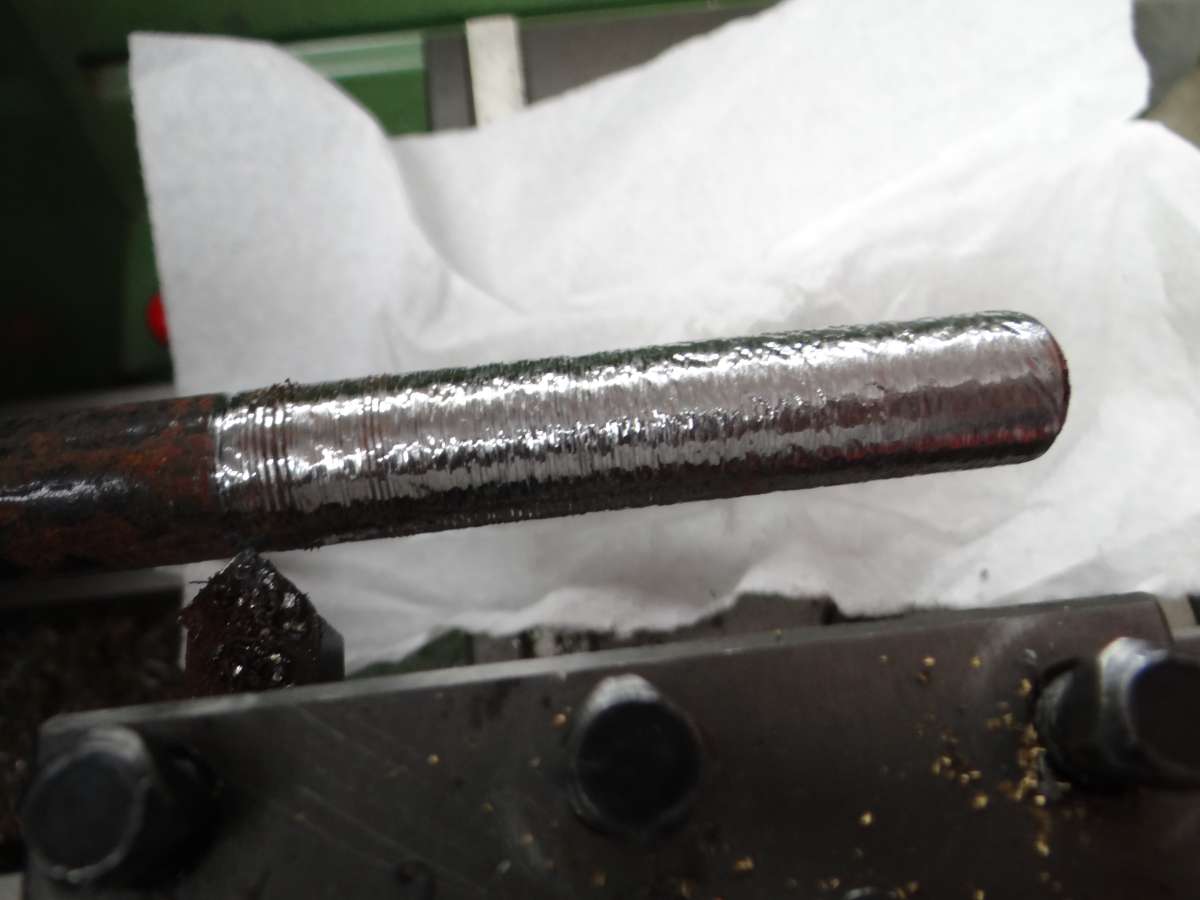

                        Don’t panic Chris!  This sort of result is a common beginner experience.  The lathe is designed to cut metal, including steel, but the operator has to get several ducks in a row!   For example:
                        • Suitable metal – many alloys do not machine well.  (EN1A should be OK)
                        • Correct cutter, sharp, and positioned at centre height (note advice above about rubbing causing rapid blunting, heavy handed is also bad – chattering etc.)
                        • Cutter and workpiece held rigidly:  minimise overhang, snug up gibs, lock unused slides, support with centres etc.
                        • RPM, Feed-rate and depth-of-cut balanced to match the cutter, material and machine.  I start with RPM = 10000/diameter, which is ball-park correct for HSS cutting mild-steel.
                        • Lubricate if the cutter is HSS

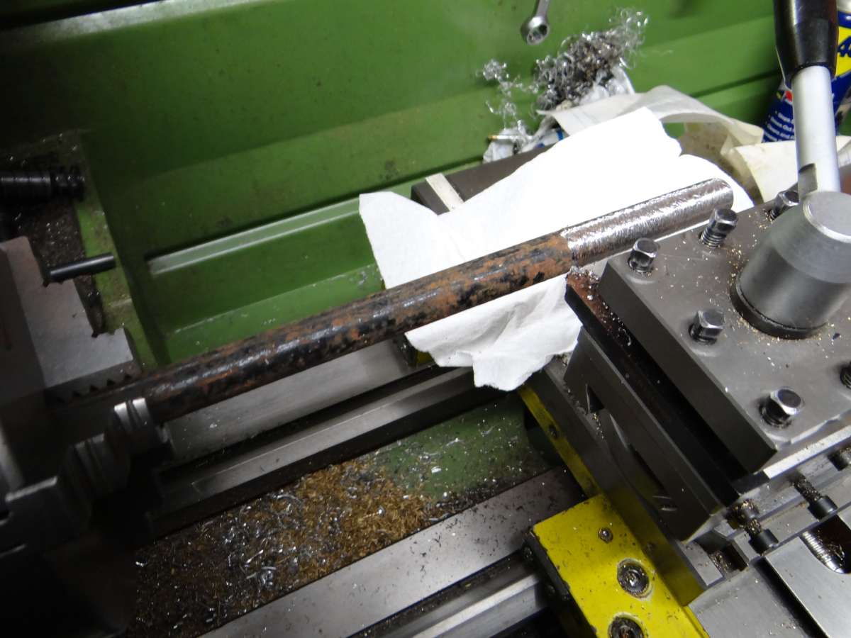

                        Next pictures result from me deliberately doing everything wrong to vibrate my lathe in an experiment!  The pipe doesn’t machine well because the steel tends to smear and tear, the work is grossly over extended and unsupported, and I used a carbide roughing cutter set  too low and run at the wrong rpm, feed-rate and depth-of-cut.  No lubrication, and I moved the saddle manually, not power traverse:
                        DSC06889
                        Result, appalling noise, and the pipe suffered a horrible mix of cutting, digging in, and unwanted burnishing:
                        DSC06890
                        I suspect Chris has accidentally hit similar issues is milder form!  A couple of things not quite right, easily done.  If photos and details are provided, the team will spot problems.  They’re often easily corrected.
                        For example, what sort of cutter, and how was set it to height?  Other gotchas: starting out, I bought a set of brazed carbide cutters that were vile: found much later these are often sold unsharpened, and need to be touched up on a green-wheeled grinder – no-one told me that!   And if you go with carbide inserts, my preferred cutters, the sharp type industry recommend for non-ferrous metals do a good job on steel at hobby metal removal rates.   Some insert shapes absolutely require a heavy rigid industrial machine, high-rpm, with a powerful motor!

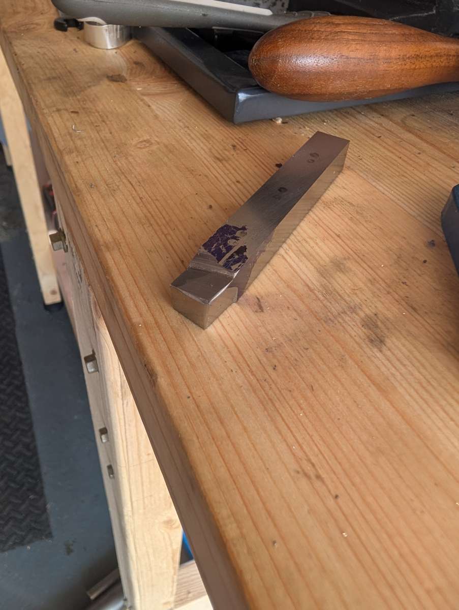

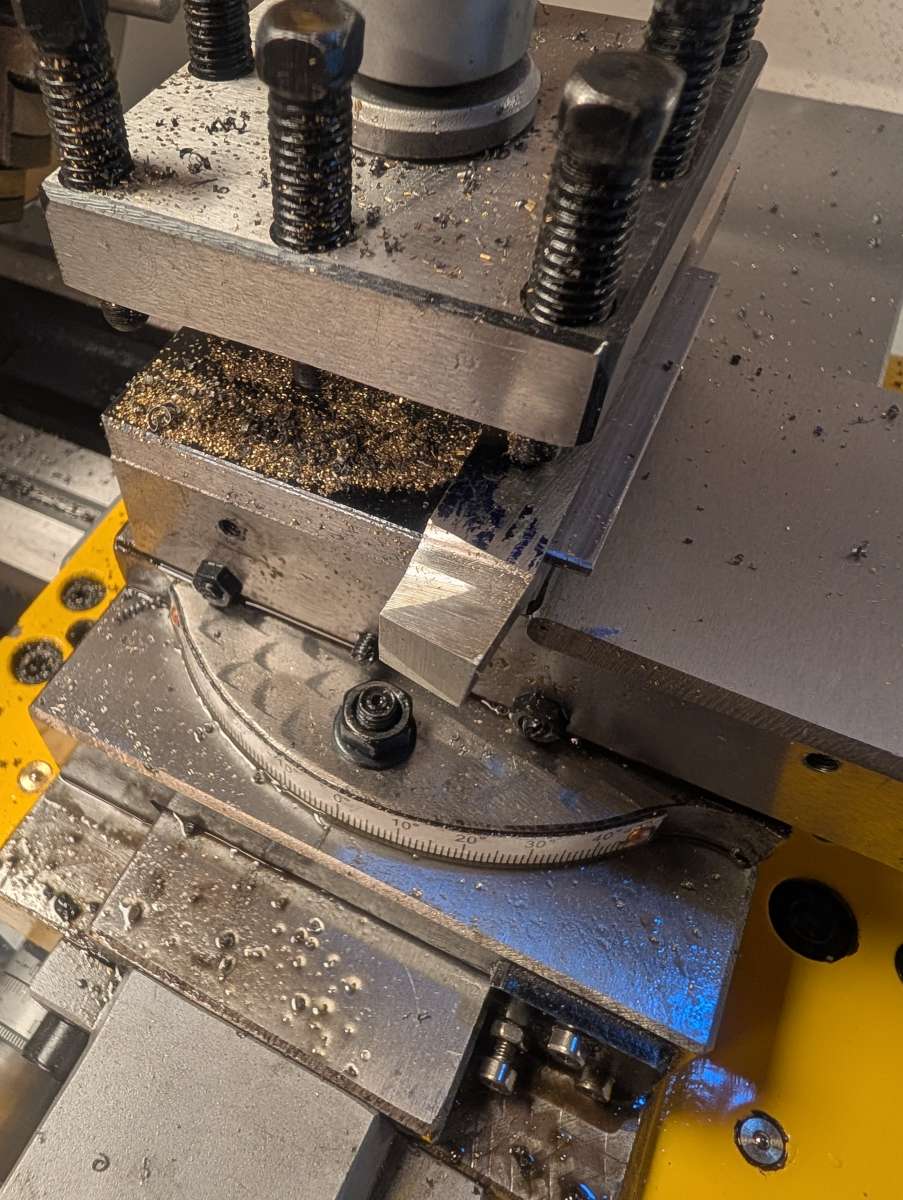

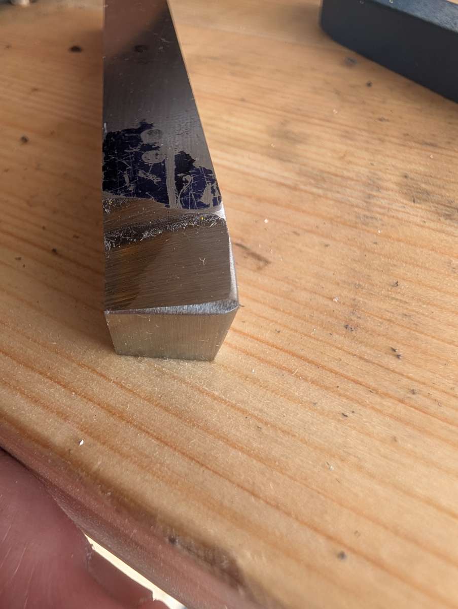

                              Here are some pics of one of the tool I’ve been using on steel : (I think the angles are okayish, but the cutting corner looks a bit dodgy..)

                                A knife tool, although sharp and set at centre height will still produce a very slightly rough finish.  A minute rounding of the nose will improve matters, but learn to walk before even trying to jog, let alone run or sprint.
                                Since the tool is moving along a rotating workpiece, the cut will actually be a spiral. A slow feed per rev will GENERATE a very fine spiral, a rapid feed will produce an obvious spiral.
                                The depth of cut will determine how obvious the spiral is.

                                #803377

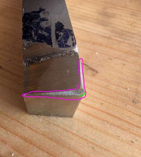

                                  Most likely that cutter
                                  The area I have marked around the edge in pink does not really look like it has been ground or if it has it is flat and that is why it cut the brass better. Try grinding again so that the main area goes right out to the external edges
                                  The very top edge of the rounded corner is also blunt (green)
                                  blunt

                                    The cutting edge of your tool is non existent I suggest that you grind back the front edge to achieve a sharp edge and the side angle if necessary then stone the ground edges then wipe the stone round the front left corner a couple of times to create a small radius as mentioned above by Howard. Best of luck.
                                    #803381
                                    Howard Lewis
                                      @howardlewis46836
                                      That tool is not sharp! Which will contribute to be your problems
                                      It is not sharp on any edge.
                                      Read your books for what they say about tool grinding.
                                      Regrind it until both faces have sharp edges, set it on centre height, and then try with a cut of say 0.005″ (0.0127 mm) with a slow feed rate. Things may well improve.

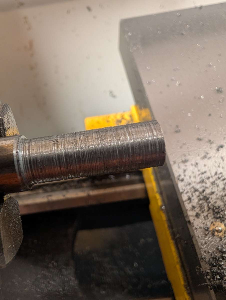

                                                Thanks all for your advices. So i re-grinded the tool, and this time didnt round the edge as i did previously. Just used an oil stone to remove the burrs.
                                                The results are promising ! (sorry the pics arent great. need to get some light at the lathe). The finish is still not great, but at least it is somewhat smooth.
                                                Something i would like to get clarified : in many of the books, they advise to slightly round the edge, or put a radius. Should that radius be put only on the vertical edge ?

                                                    You can put a radius, something like 1mm, on the vertical edge between the front and side faces.
                                                    The edge of the top face should be dead sharp all round.
                                                    Your chips seem to be blue, which means the spindle is running too fast for an HSS tool.
                                                    For cutting mild steel with an HSS tool, you need some cutting lubricant.
