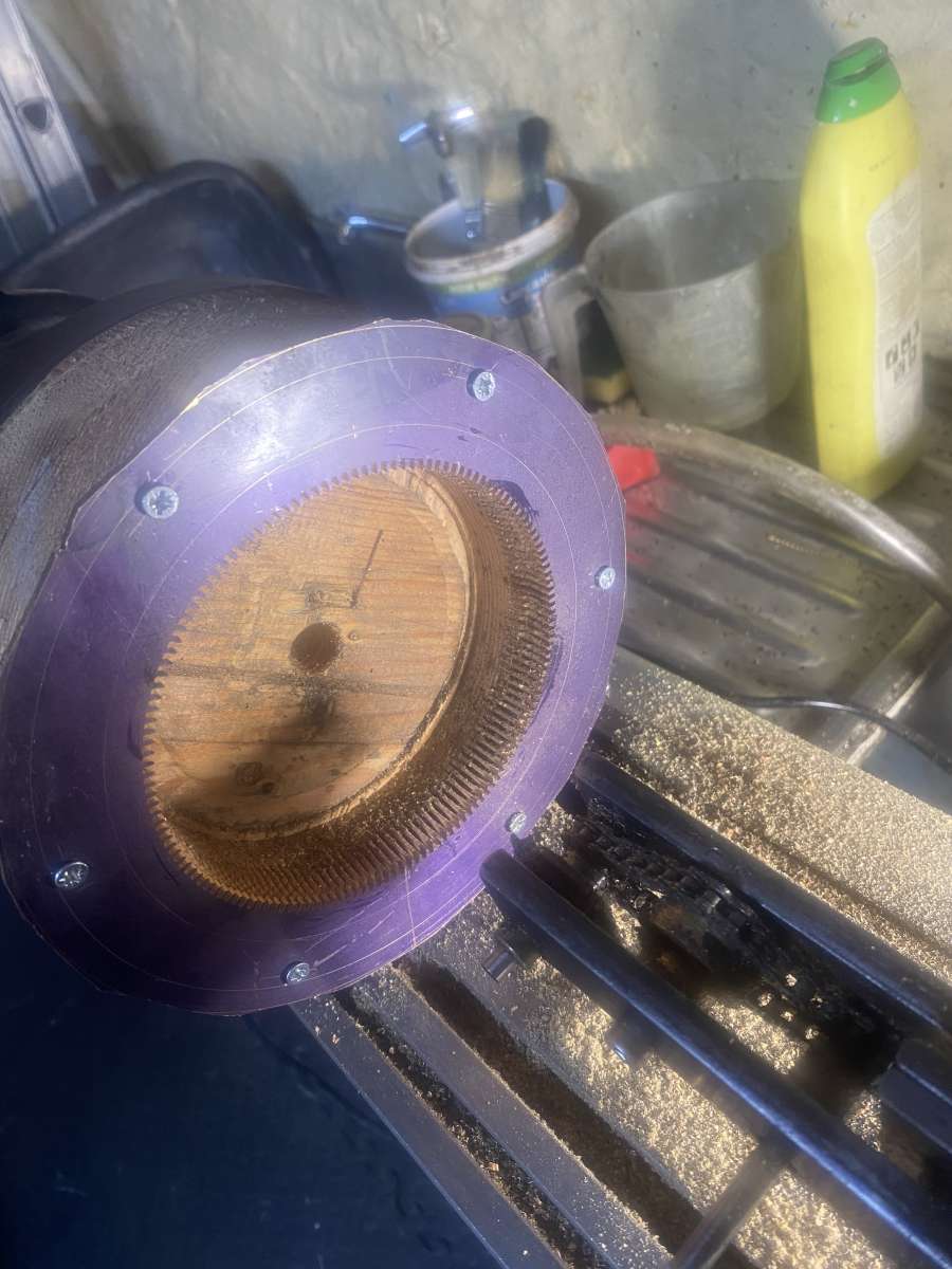

      Thank goodness for that. It’s been a bit of a struggle! Just as well I enjoy it ( I think )

        Clarification required. It appears to involve a chain driven cutter which is rather unusual.

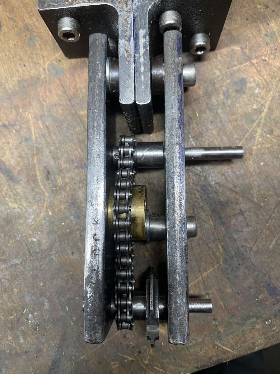

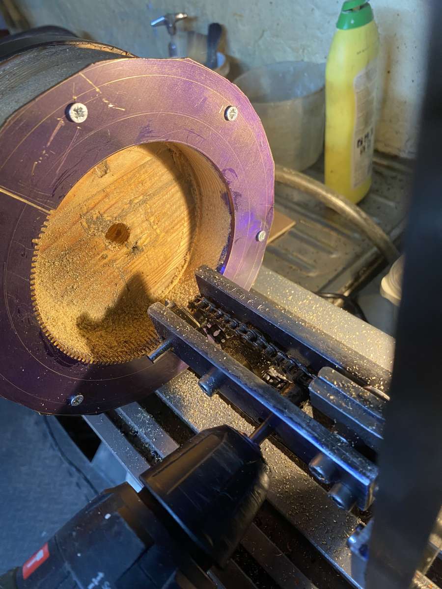

          Yes you”re right Bazyl it does look a bit random.
          I’m making an epicyclic clock which requires an internal gear wheel. I ‘invented’ the cutter assembly in order to reach inside the wheel. I tried using a round belt but I couldn’t stop it slipping so I changed it to chain drive. It has taken quite a while! Here are a few more photos which might explain it better.
          David
          IMG_0832IMG_0831

            IMG_0836

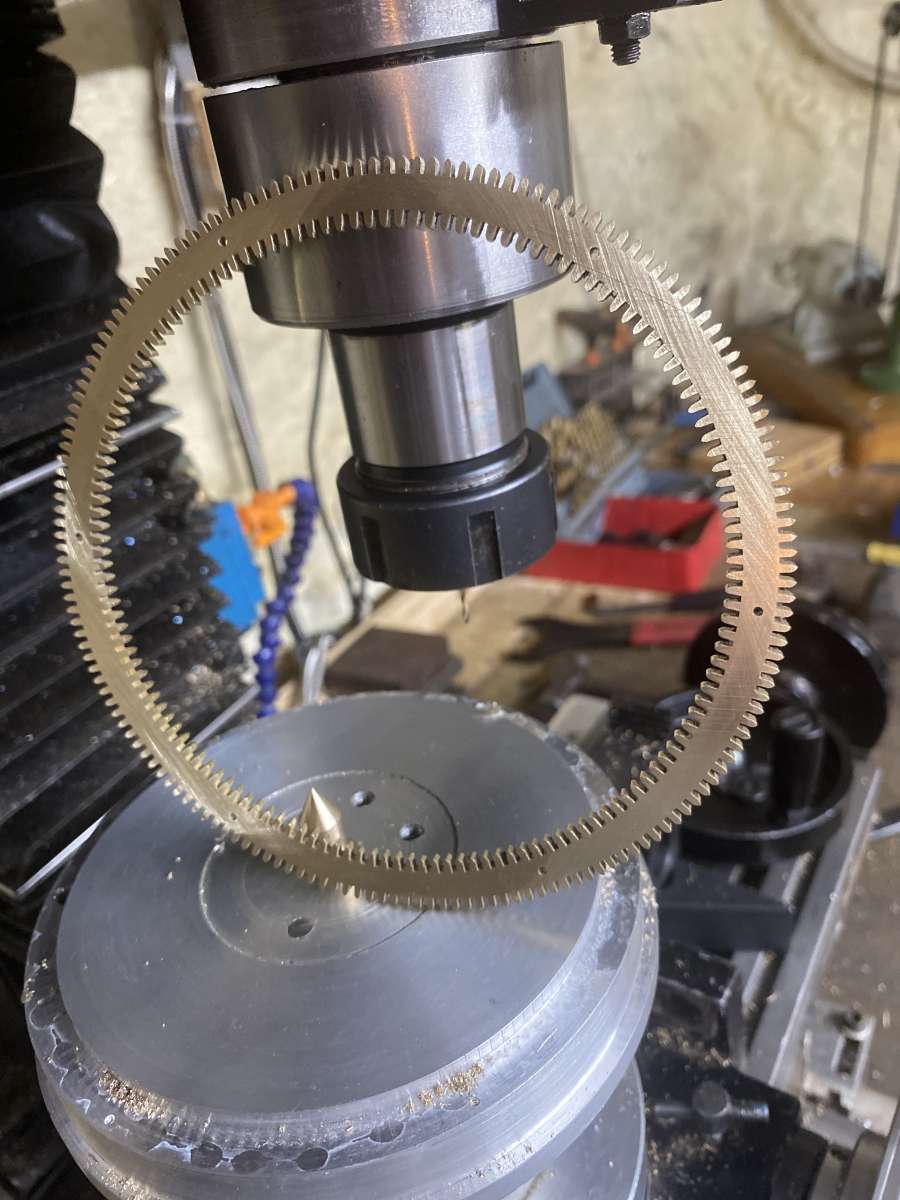

                    ‘ and here’s the finished item. Many thanks for all the help I’ve had on here.

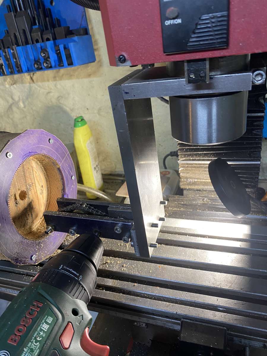

                          I take it the cutter holder is reciprocated by an eccentric – the chain drive simply placing the drill well clear of the work-piece?

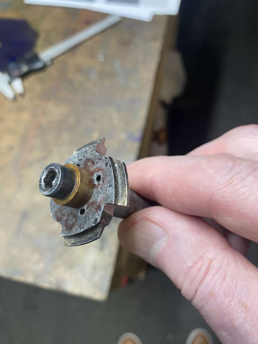

                            Nigel, the cutter is  home made but yes, the chain drive is just to clear the work piece. There is a brass eccentric but that is just a tensioner.
                            David
                            IMG_0850

                              Ah… Ooops! I don’t know how but had managed to mis-read the photos to interpret the tool as some sort of shaper rather than mill!
