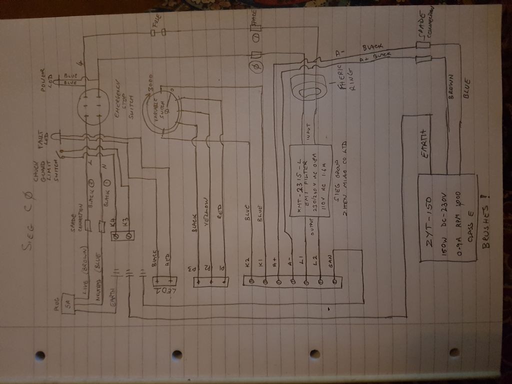

                Thanks guys but I think I will accept the challenge to resurecting this little girl.
                I stripped the lathe's electronics earlier to familiarize myself with them and to see if i could spot anything obvious. Ive discovered the control board are sold for @ £100 and not worth that IMHO. anyway Ive attached a link to a preliminary sketch of the electronic circuit. Its rough and not to any 'STANDARD' but may be of use to someone.

                    If you do want to pursue the restoration of this lathe then you can quickly check the speed control board by replacing the motor with a 80-100W filament bulb and varying the speed control pot. If the intensity of the bulb varies uniformly from dim/off to full brightness with the adjustment of the speed control pot then there is a fair chance that the speed control board is OK. Depending on how badly bent the lead screw and cross slide screws are bent there is a good chance that they could, with care, be straightened enough to check basic operations. What could be a problem is damage to the head, chuck spindle, chuck and head bearings though bearings are relatively cheap and can be replaced. The original sheet metal work can either be hammered into submission/shape or bits fabricated and bolted/pop rivetted in place.
                    If you do take it on as a project then good luck and I hope you get a working lathe.
                    Martin
                    ps:
                    The motor can be checked by connecting it to a low voltage DC supply, 12/24V, and if it spins up and rotates freely and evenly in both directions then it is likely to be OK

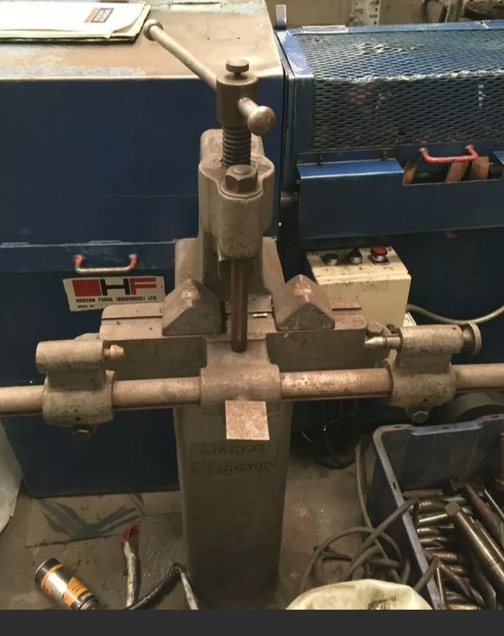

                      I saw a little John lathe on ebay last week, I've seen a few comments from an owner on here that highly recommended them as good quality machines, not knowing anything about them I read the write up at Lathe. UK to find out a bit more about them.
                      It mentioned a technique used to straighten leadscrews that had bowed after machining operations removed tension causing them to bow.
                      They used a Jones a Shipman screw press that has 2 V blocks the leadscrew sits on while the screw pushes down in the centre.
                      There's no reason you couldn't rig up something similar in your bench vice, as the leadscrew is very small, with a bit of care you should be able to produce a result that is usable.
                      #559473
                      Pete.
                        @pete-2
                        After looking at the specific press J&s made for this, they had 2 centres on the base of the screw press to hold the leadscrews, but you could no doubt achieve decent results with small V blocks in your bench vice.
