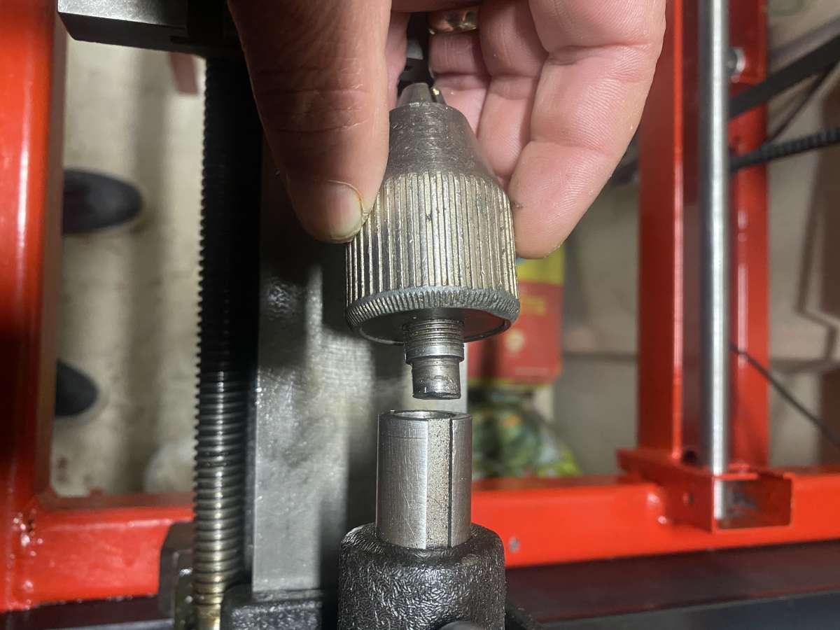

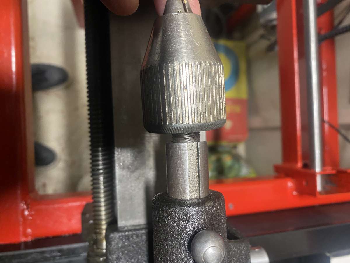

      Hi All, I have recently purchased an EW lathe. It had a chuck which appeared to be screwed in. Today it fell out and I realised it was only in about a MM and no thread inside.
      I assume the previous owner put it in, hit it to hold it in long enough for it to look like it was in place.
      It appears that it has a taper that measures 12mm but the depth to the bottom of the hole is 38mm.
      I see a morse taper MT1 is 12mm at the large entry hole.
      I assume it would be imperial so if anybody could help as to what I actually need please.

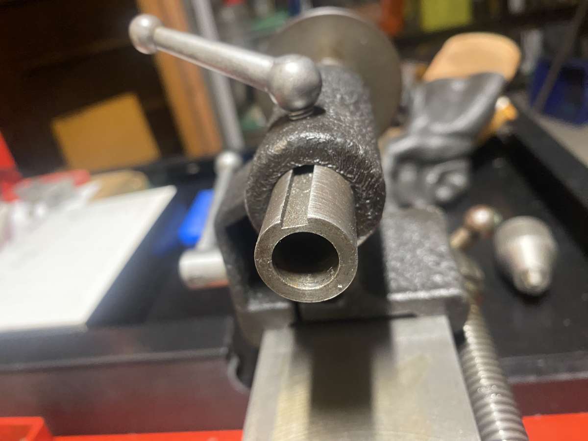

          Be aware that on some lathes, eg I think the Adept, the taper is not full length and that might be the thin bit or the thick bit.
          You description isn’t very clear about the situation. Try a photo perhaps?

            IMG_3784IMG_3783IMG_3782The chuck was just holding on the first thread. The stepped down part is only 10mm. The taper depth is 41mm fully retracted so is to release the taper?

              No. 1 Morse taper in both spindle and tailstock.
              A taper that meets the tailstock screw will give an ejecting effect but the longer the tool taper the shorter the drilling travel.
              I have just tried it with my own EW.
              I hope that previous owner’s bodge with the chuck has not damaged the tailstock.

                  What you have there is a drill chuck off something like an old breast drill and not suitable for a lathe tailstock which is what your photos are showing. What you need is drill  chuck mounted on a No. 1 morse taper shank.
                  I would suggest that you look on the lathes.co.uk website for information on EW lathes.

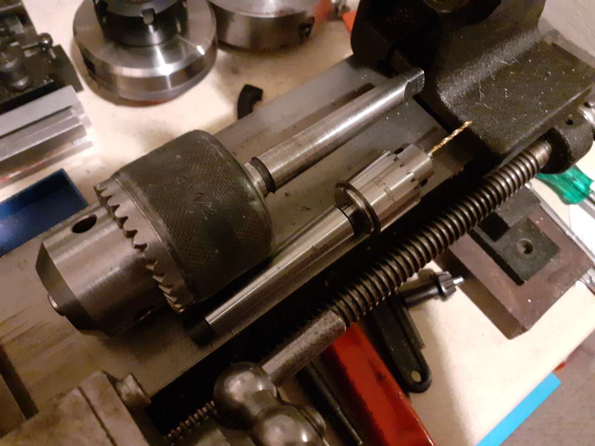

                    Looks like the taper part is missing. Mine fixes to the drill chuck with another tapers: yours would have a female screw that the male drill chuck matches.
                    DSC06941
                    The drill chuck pushes firmly home into the tailstock like next photo, where it’s gripped by the taper.  Ejection varies, either winding the tailstock back, or maybe tapping a rod in at the other end.
                    DSC06942
                    Options:
                    • find the missing taper.
                    • make a replacement with the lathe,
                    • identify the taper and buy a new drill chuck that fits.   Doesn’t need to match the old one, only the taper has to go into the tailstock.  Might have to cut it to length.
                    I’d buy new, but making one is a good learner project once the basics have been conquered.  Nice thing about lathes is they can make their own spares!

                      Yes – MT1 both ends…

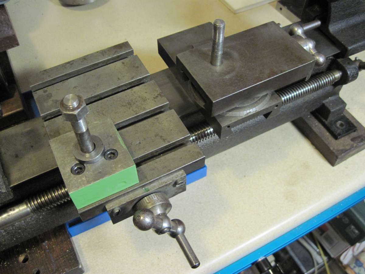

                      The topslide consists of two sliding parts, the lower (rotating part?) screws onto the top of cross-slide. The pictures below show the topslide attached to the ‘normal’ top part of the cross-slide but not mounted. I have a boring table alternative that I often use with a fixed mounting block and toolholder, which is the one shown in use. As the leadscrew is permanently engaged, it is quite possible to use the EW with just the cross-slide and it would be fairly simple to make a tool-block that raises any tool/tool-holder to the required 2.5″ centre height, assuming the cross-slide is complete. The EW is a very good small lathe.
                      Regards,
                      IanT

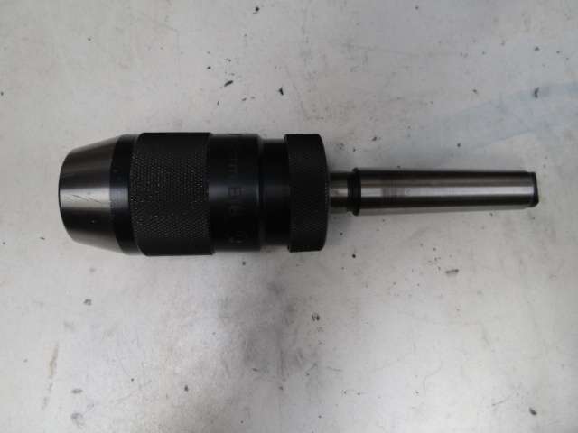

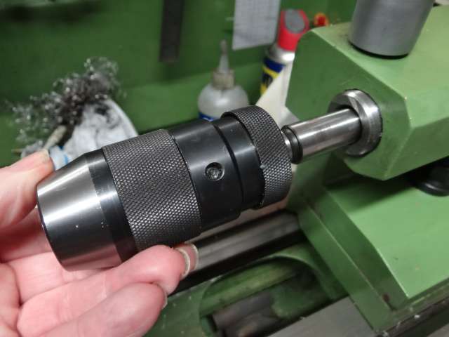

                          You need a ‘drill chuck on MT1’ taper. Lots on ebay at silly prices but I’ve seen one at £12 which is fine. Don’t get a keyless type on such a small lathe and don’t be waylaid by fancy makes until you know what is really what.
                          #818910
                          bernard towers
                            @bernardtowers37738
                            Why , Dont get a keyless??

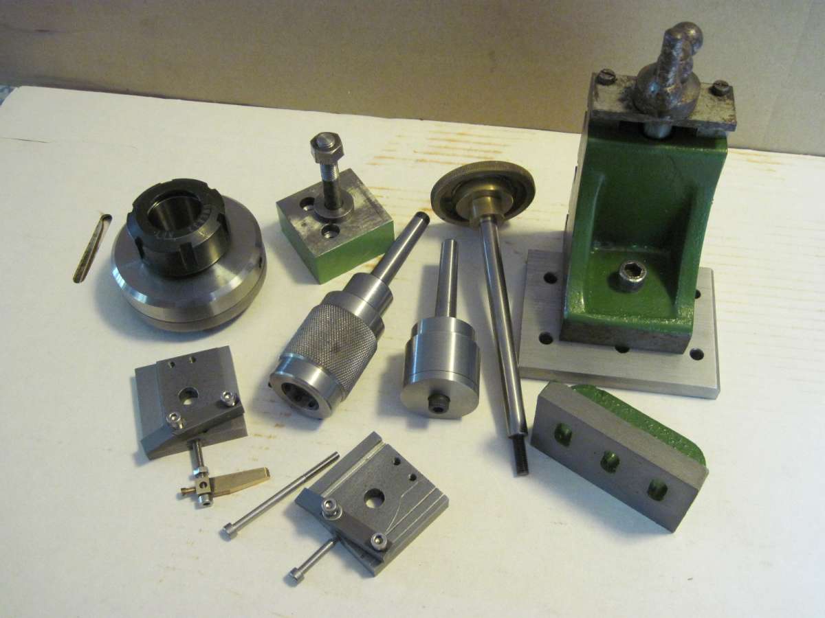

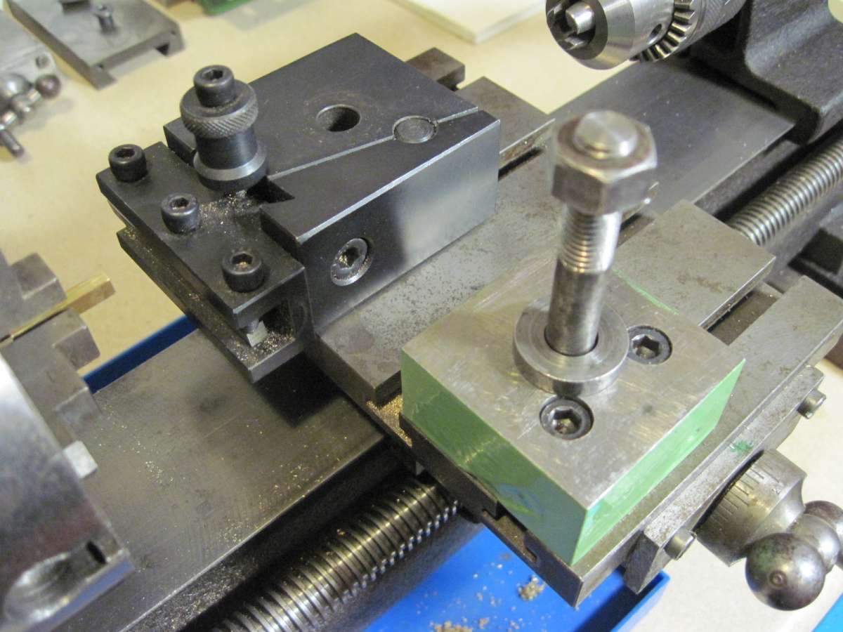

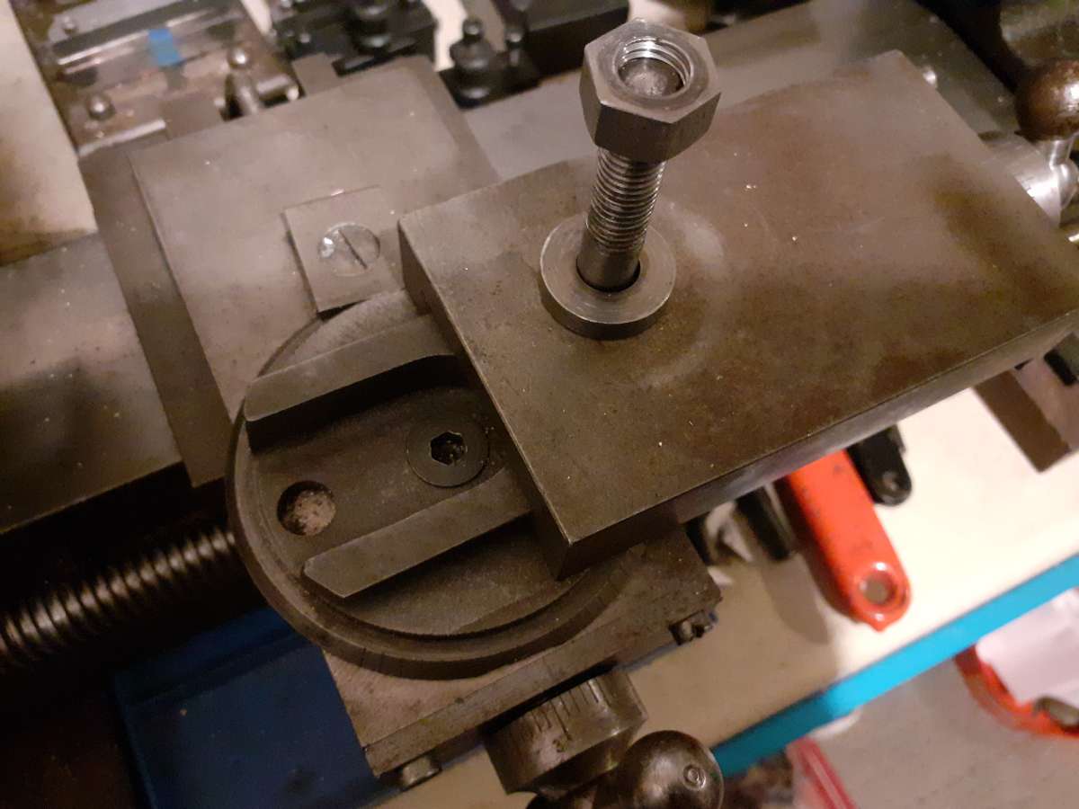

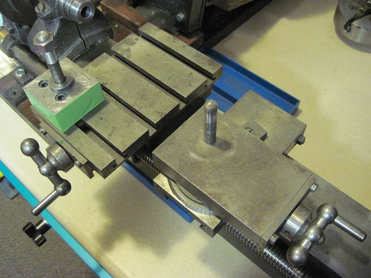

                              Here is a detailed shot of how the top-slide attaches to the cross-slide. A simple counter-sunk hex-screw with a ‘locking’ clamp on the perimeter
                              EW_Topslide_detail
                              I have two drill chucks, a larger 1/2″ one and small 0.3-4mm one. I rarely use drills over 8-10mm in the EW – if I need a bigger hole on the EW, I’ll probably bore it. You can purchase MT1/JT arbours and small JT chucks to go with them.
                              EW_Drill_Chucks
                              There are a lot of very useful small accessories that you can make for your EW. With some MT1 bank arbors you can produce a die holders, slitting saw arbors & milling cutter holders. A drawbar is essential when using cutter holders in the headstock. I have a small 3-jaw ‘scroll’ chuck, as well as 4-jaw & ER32 chucks. I probably use the 3-jaw the most but all are useful.
                              EW - Sept 2014 008  If the EW is your only machine tool, then some small flycutters are very useful – I have about four or five different ones that can be held in a chuck. You can use them with a small angle plate or (preferably) a small vertical slide if you can mount it.
                              I hope this is useful. I’ve had a lot of use from my little EW and although I have larger machines, I still use it a lot!
                              I hope you enjoy yours too   🙂

                                ” I’m sure my cross slide is complete but interesting that mine only has three slots for Tee nuts where yours has four ”
                                Then I think your EW has come equipped with a version of the boring table, as opposed to a top-slide. As I’ve mentioned above, the lathe is still very useable and mounting cutting tools directly on the cross-slide does make it more rigid in practice. The T-slots also make mounting angle plates, vertical slide, larger work to be milled or bored (and any other bits and pieces) much easier.

                                    They are longer and use up precious room between centres. It isn’t really that difficult to use a key and that gves you better control of the clamping force.

                                      The spindle’s through-hole does allow clearing swarf but is really to take a long length of material.
                                      My specimen’s boring-table and vertical slide have only three slots each: I did not know Stringer made a  4-slot version too!
                                      A tip on using the vertical slide on the EW…
                                      It relies in its standard trim on a single Tee-bolt to hold it to the boring-table. This can slip in use, and trying to over-tighten the bot risks breaking the top of the tee-slot.
                                      Ian T’s photograph shows one solution: mounting the slide on an intervening plate with several T-bolt holes.
                                      For mine, I made two L-shaped steel blocks (aluminium-alloy or cast-iron would work as well) each with two holes to fit tee-bolts in the broader stem of the “L”.
                                      These fit each side of the slide body, with the foot of the “L” hooked round the back of the casting; thus restraining the slide by its two sides and the back edge.
                                      To square the vertical slide to the cross-slide I wind it down so I can gently push the back of the moving part against the cross-slide edge while tightening all five bolts.
                                      I’ve also made a simple vice for my vertical slide: not particularly high-grade precision engineering but it does work! Its base is a 3/8″ thick steel plate that occupies the entire slide area, and held by two T-nuts and a T-bar, with counterbored, cheese-headed screws.
                                      I made some T-nut bars for mine: T-nut profile but of length equal to the slide width, and with tapped holes at appropriate places. This is easier to use and more importantly, spreads the load over more of the slide.
                                      NB: screws and studs used with Tee-nuts must never bear on the floor of the slot. If they do, tightening them can break the roof of the slot. The usual way is to ensure the nut thread does not run right through. Another is to use studs with that end having a short thread, ideally with a shoulder as well.

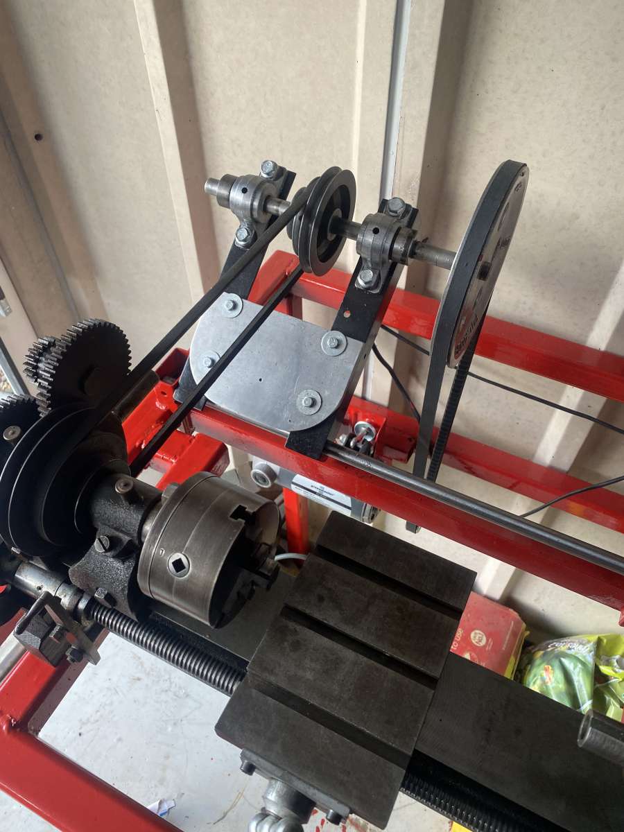

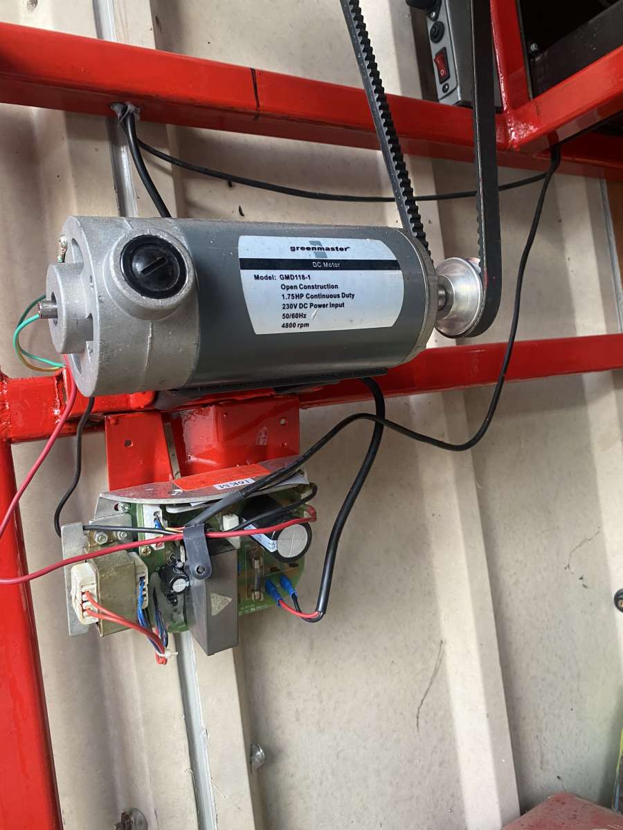

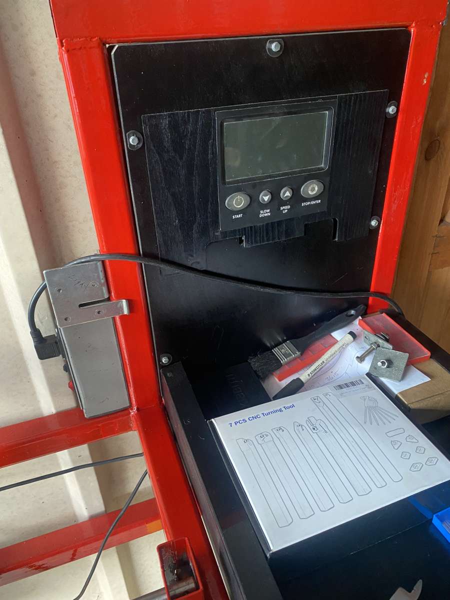

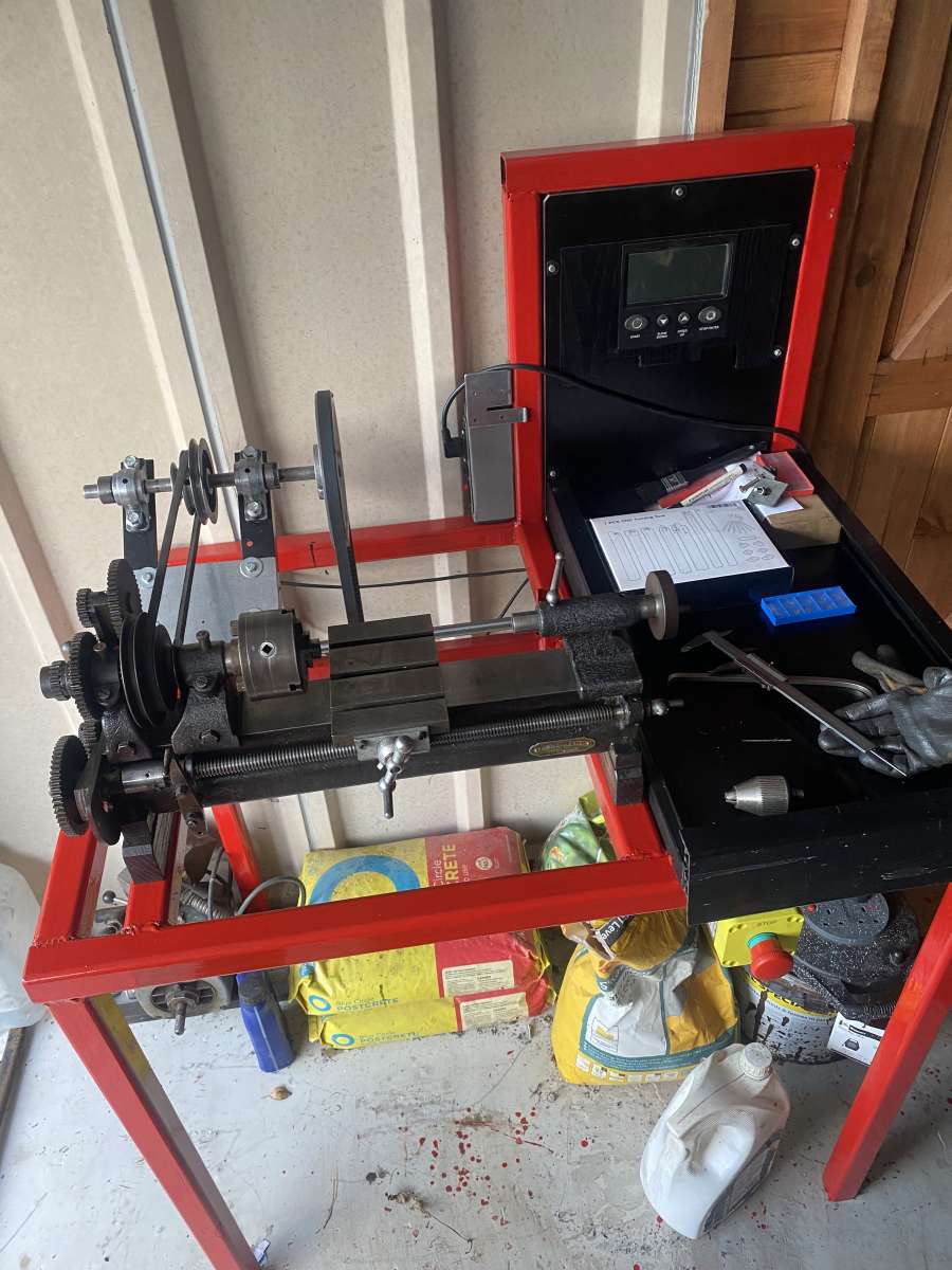

                                          IMG_3787IMG_3788IMG_3786IMG_3785Hi, The lathe came with a single phase motor made by Hoover.
                                          I didn’t really like the idea of it starting at full speed and making speed changes by moving belts onto different pulleys.
                                          I would need a 3 phase motor with a single phase to 3 phase VF drive which could get expensive.
                                          The treadmill at £35 pounds was a bargain. Took it to bits in the sellers shed and kept what I needed.
                                          Motor, Motor control board and the display/speed control.
                                          All you need is 240v input, output to motor(marked on board + & -)and the interface wire from the motor board to the display/speed control.
                                          I’ve chosen to use the display and the original buttons for now. I used the original mounting brackets for the motor and control board, Now need to make a cover. I just added an emergency stop.
                                          You have full speed control with DC motors, using the original display board or a potentiometer.
                                          I also used several other parts from the treadmill that are included in the bench I made.
                                          I am currently looking at another treadmill of the same type for spares that will hopefully future proof the bench(it’s at £70 so hopefully he’ll drop at bit)

                                            I would go for a 1/4″ or not over 10mm keyed chuck rather than keyless, they take up less length on a small lathe. And if the tailstock is self extracting, do some measuring tp find whether the small end of the MT1 can be shortened, which may allow the tailstock quill to be withdrawn further before it self extracts.
                                            You could do with a tray under the lathe bed to catch swarf and to protect the motor.
                                            #819092
                                            jarv
                                              @jarv
                                              The tray is there too and I have two Channels that need mounting, that will enable me to slide it in/out. I will get this and the motor board cover done before I use it anymore. Couldn’t resist a quick try.
                                              Your advice on the chuck is correct of course, I’ve just received my MT1 and heavy duty chuck 1-13mm and It’s way too big and heavy.
                                              I’ll probably keep it as I have it now but will order the smaller one.

                                                Changing speed by moving the belt on a small lathe like this is not a problem; but make sure the motor can’t start while you are in mid-move!
                                                Does the countershaft have a lock to hold it in position? It should, to avoid over-stressing the belt and bearings. The belt should never be fully taut: you should be able to depress the middle of the span a bit, by light finger-pressure, without anything else moving.
                                                (This applies to all vee-belt drives. A plate on my Meddings bench-drill specifically warns against exceeding the belt tension set by a built-in spring. Car service-manuals advise on setting the alternator, etc. belt. It is particularly important on a machine like the EW lathe whose spindle runs directly in the headstock castings.)
                                                Your countershaft is not original E.W. Stringer but clearly well-made. The original is an H-shaped casting pivoted at the base, the shaft through the tops of the ‘H‘, and adjusted by a threaded stay-rod carrying a knurled nut. Looking at your photograph I would suggest a spar joining the two side-rails above the plummer-blocks, to take a central, adjustable stay descending from that to a pivot on the bench frame below it.
                                                Although I have fitted ‘Newton-Tesla’ 3ph conversion sets to my other machine-tools I still use their mechanical transmissions in conjunction with the new motors. Such a conversion is not a be-and-end-all replacement for the belts or gears if you need use the machine’s full speed range; and on a little lathe like the EW running at modest power and speed, it is not really justifiable.
                                                That variable-speed d.c. drive, yes. Mine uses a modern, conventional, enclosed 240V 1ph. a.c. motor but I am thinking of a simple d.c. conversion – though overhauling its worn headstock and spindle is far more important.
