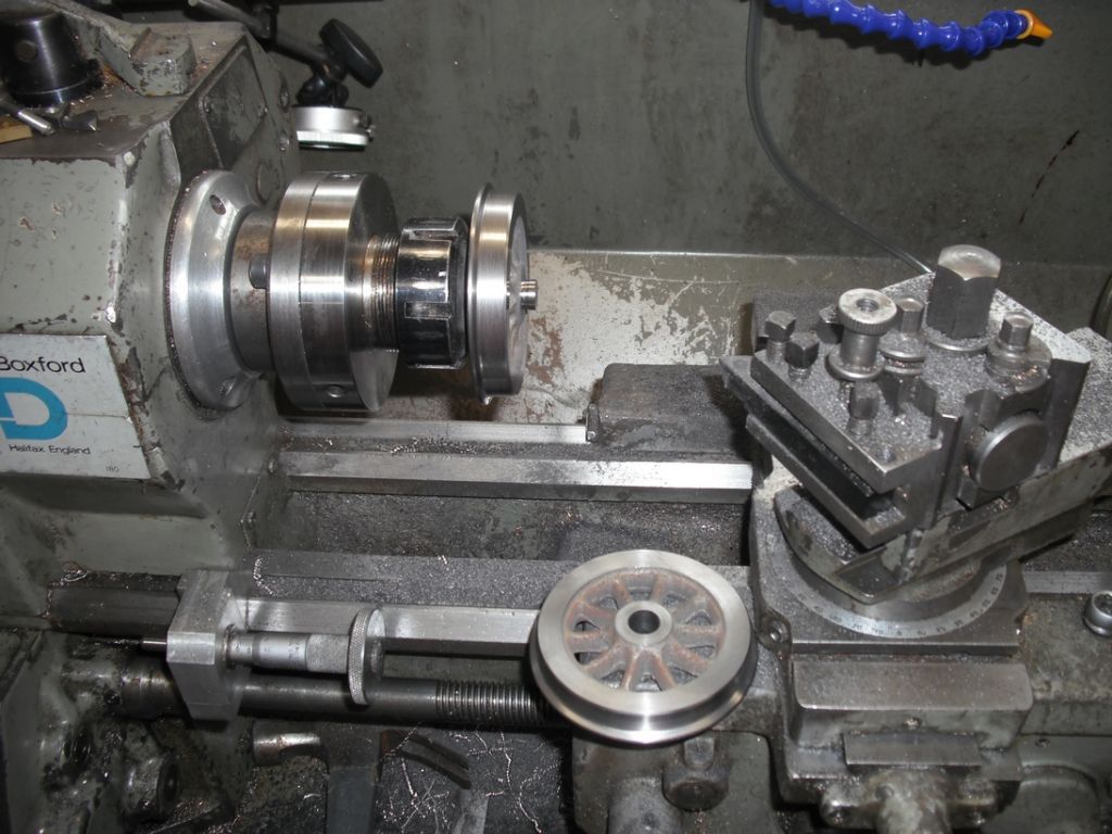

                  Bob Brown 1
                    @bobbrown1
                    I use an ER 40 collet chucks in my Boxford on back plate or in one of my milling machine and ER32 in the other milling machine.
