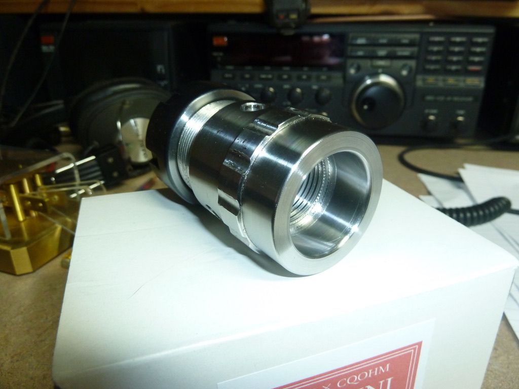

      Hello someone may be able to pick the bones out of this.
      Not wanting to buy a cheap Chinese ER32 collet chuck for my S7 I bought one from Luxembourg with postage about 85 Euro's, very disappointed it did not screw down to the register by about 2mm, after fixing the problem by boring the hole back a bit more the run out was 3 thou' on the body and the collet taper, ( My lathe I will add has a zero run out on the spindle) with the collet chuck screwed in place I retouched the the taper to a perfect zero and also the taper in the retaining collar nut, however, the chucks body is still running out and there is not much I can do about that, when a collet is fitted the run out is 2 thou' so I can only assume that the collet is being pulled by the non concentric body. Any thoughts would be welcome while I carry on producing my own and with any luck as it is being produced in place on the lathe should be perfect.

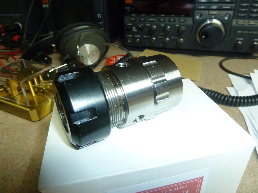

                              I have added a couple of pictures of the chuck, you can just see the serrated mark where I removed about one thread for the chuck to hit the register.

                                I really wish you had put the photos in your original post. As Emgee said, you really should have returned the chuck. Now that you have modified it I think you are truly screwed.

                                  In your case, you've presumably only removed some of the thread, rather than the diameter of the register.
                                  Really the thread only holds it on, and the bore sets where its sits axially. Have you had a play with some Micrometer Blue to make sure you have a good symmetrical fit, on the rear flat annular surface, the threads themselves, and the bore of the chuck?
                                  Maybe chuck up a length of straight ground bar and measure the run-out against a mark on it. Take the whole assembly off, with the bar still chucked up, re-fit and re-measure. Is the error still in the same place with respect to your marks.
                                  Keep the collet, bar, and chuck in the same orientation with respect to each other, loosen and re-torque, has anything changed?
                                  Keep the collet in the same orientation with respect to the chuck twist the bar and re-torque, has anything changed etc?
                                  Continue until you can replicate the exact same error, in both magnitude and direction repeatedly and then have a further ponder.

                                      Hi all, once again thank you all for the replies I have had so far re the ER32 collet chuck, I can say definitely that the problem with the chuck initially not reaching the register was that the thread on my S7 had been cut slightly too short at the register end, this caused the thread in the chuck to reach its limit before hitting the register, so, removing a tad of the chuck thread fixed the problem perfectly.
                                      I have picked up on John's post about a thread that referred to the tightening of the collet collar nut and how it might influence the collet position, I am after all now only looking for 2 thou', so, before I proceed with the chuck I have started to make I will unscrew the 4 jaw complete with the workpiece and give the problem collet chuck one last chance by giving it a damn good tightening and report back.
