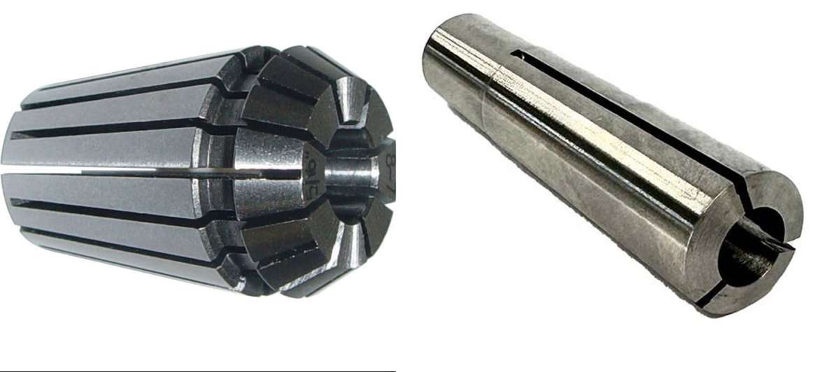

      Is there any disadvantage in using a Morse collet comparing with an ER type? I guess the Morse collet is more rigid since the total length is shorter. How about the clamping? Is it on the whole length of the cutter? Like for ER? I have an milling machine with MT3 spindle and I’m looking for a way to attach the tools.
      #788710
      Bizibilder
        @bizibilder
        Morse type collets will only hold correctly if the item being held is exactly the nominal diameter of the collet.  Each ER collet can hold over a range of sizes.  It is a very small range for each one but that is all you need.
        If you have a MT3 mill spindle I would suggest an MT3/ER collet chuck (I think ER32 would be the preferred size) and a set of collets.  You will also find the a set of half decent ER collets is far cheaper than a corresponding set of morse collets.  You only need a “metric” set as they will hold the appropriate imperial sizes, for morse collets you will need BOTH metric and imperial sets to cover all eventualities.

                          Morse collets are only split at one end and the piece being held must be a close fit with the collet.
                          ER collets are split at both ends and the piece being held is clamped over the full length of the collet. The piece being held does not have to be a close fit.   eg. ER32 collets have a a clamping range of 1mm.  ER collets protrude from the end of the spindle and reduce head room.

                              The fundamental difference is that a morse taper is self holding with a long shallow taper inevitably generating high frictional losses as the collet comes up tight. The mechanical advantage of the shallow taper helps offset the frictional loss but ultimately a morse taper collet will not hold as tightly as purpose designed tool holding collets at any given drawbar torque.
                              If you do jam a MT collet up really, really tight they can go well and truly into self holding mode becoming a total pain to remove. As MT spindles are generally associated with the lighter breed of milling machine going postal on the drawbar for removal is probably not a great idea.
                              A screw thread type removal device is vastly preferable to bonking the drawbar on an MT taper machine. I’d be very unhappy about using a machine not so equipped. The sharp rap technique is getting perilously close to the demarkation between “not ideal but if works given sensible care” and “to be avoided as its likely to damage things in the event of error.”
                              An oft overlooked issue with ER collets is that, being double ended with a floating nut, they require high tightening torques in larger sizes to achieve proper grip and the specified concentricity.  This table from Shars is pretty good.

                              At the core the differences are fundamentally down to the length of the gripping portion which is shorter for the smaller collets in the range. Oversimplifying to the point off absurdity grip is fundamentally down to force pre unit area over which the collet touches the tool shank. Smaller tool doesn’t cut so hard so it needs less holding force and has less grip area anyway so less torque to get to loading force.
                              With ER25 and 35 collets you will be struggling to get the required torque on larger sizes with the usual bent metal spanner thingy in the common kits. It’s surprising that the bearing type nuts actually need more torque in some sizes than standard ones as they are generally sold as needing less torque overall. I’ve no idea why less torque is specified for mini nuts.
                              Much, if not all, of the gripping on smaller tools is done under the nut portion of the ER collet system which has implications for concentricity. For obvious technical reasons the nut has to be made with sufficient clearance to float slightly as it pushes the tail end of the collet firmly into the taper in the holder body so things run concentrically. If the collet is not really accurately made it can take considerable force to generate concentricity. Theoretically it’s all self correcting at sensible torque levels but if the collet is not sufficiently accurate it may never run really true. Expensive collets are expensive for reason!
                              There is no doubt that for general purpose moderate duties on smaller cutters the R8 taper is the best of the commonly found bunch. Being single ended with a relatively steep closing angle frictional forces are lower yet mechanical advantage is sufficient to get more than enough holding power at 25 to 30 ft lb torque. There is a reason why about a zillion other designs of collets for more specialised machines follow this general layout.
