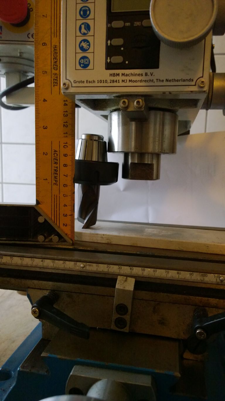

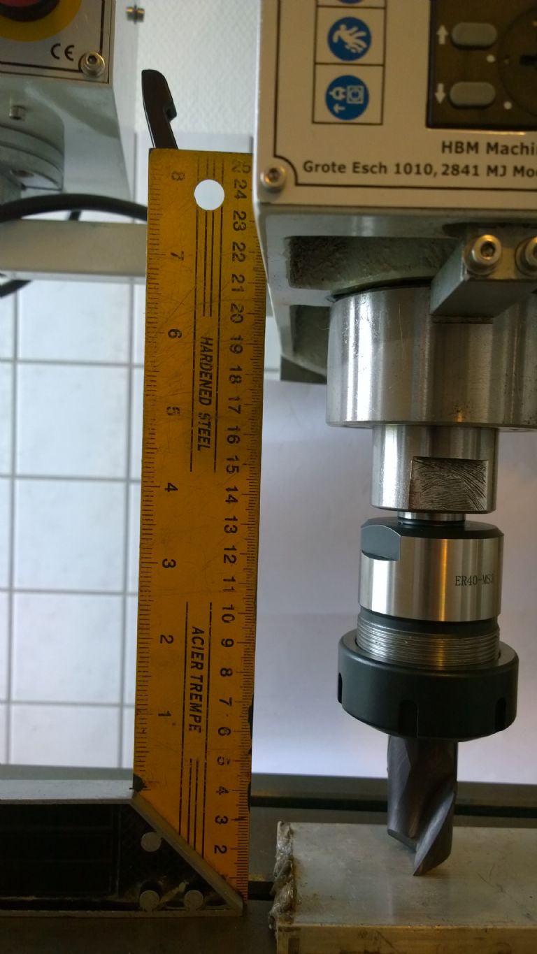

      The great John Stevenson thougth little of MorseCones for lathe noses and more of ER threads.
      I was playing around with my camera and my HBM BF 25 Vario milling machine with MC3 spindle nose (All my lathes bar first Myford and soon to be my sons WM250 have had MC3 as well) and some nice ER 40 gear.
      The machine will be cheaper,better and nicer with ER40 direct.
      The lower bearing is the 32007 (62/35/18)  and can be replaced by 32908(62/40/15) in the new ER40 spindlewp_20200926_011[1].jpg
      Edited By Niels Abildgaard on 26/09/2020 08:42:12
      Edited By Niels Abildgaard on 26/09/2020 08:58:49

        #497914
        David George 1
          @davidgeorge1
          Hi Niels are you going to make a new spindle with integral ER 40 nose or a different adaptor into the Morse taper.
          David

          Niels Abildgaard
            @nielsabildgaard33719
            Posted by David George 1 on 26/09/2020 09:26:29:
            David
            A new spindle to save heigth

              #498003
              DC31k
                @dc31k
                Have you considered how you will hold Morse tooling in the new spindle arrangement, particularly drill bits?
                I have never drawn it up, but what size Morse taper would fit within the confines of the ER40 collet cavity?

                Niels Abildgaard
                  Posted by DC31k on 26/09/2020 18:47:47:
                  No ,never
                  What I have done is to turn mistreated morse male cones cylindric and then hold them in ER collets.
                  I will try to scheme Your idea
                  An ER40 size collet can easily grip a MC3 and very marginally the thinnest half of a MC4

                  #498014
                  HOWARDT
                    @howardt
                    Why not change it to R8. You can hold most tools directly and use an ER holder if required. Putting a thread on the nose risks wear, although in the hobby workshop will outlast most of us.
                    #498017
                    old mart
                      @oldmart
                      Since the range of collet sizes is from 3-30mm diameter, to utilise them all fully would need at least 4 diameters accomodated from the face of the nut. A much larger lower half of the spindle would be needed to take a 30.5mm bore. The size of the clamping range of these large collets is such that it is doubtful if cutters in the smaller sizes would be held accurately or tightly enough.
                      R8 cannot accomodate bigger than 20mm cutters and then only with very limited depth which means that standard length 20mm cutters project a long way.

                      #498020
                      Niels Abildgaard
                        Posted by old mart on 26/09/2020 19:24:47:
                        Edited By old mart on 26/09/2020 19:29:24
                        The Quill is bored 62 for the lower bearing that can be 40mm inside.
                        #498022
                        Niels Abildgaard
                          Can You please explain another way for my understanding?
                          #498027
                          old mart
                            @oldmart
                            As long as the length of, say, 110mm from the end of the threads can be 30.5mm then that gives a decent choice of fitted lengths for the larger longer cutters. There needs to be room in the design for spanner flats directly above the nut. Some long spanners will be required as the recommended torque for larger cutters is 145 ftlbs.
                            I converted a Tom Senior spindle from MT2 to R8 last year and am very pleased with the results. R8 is still a very popular fitting and there is a wide variety of tooling. You would have to make special adaptors if you wanted to use shell mills with an er40 spindle, although there would be no need for a drawbar.
