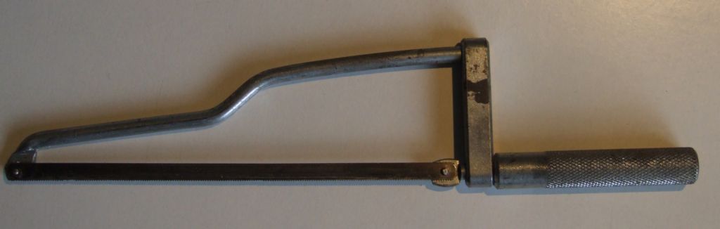

      odd shape frame

        One of these coping / junior hacksaw frames turned up in some tools given to the men's shed. I'm just wondering what the point of the odd shape frame is to make it better than a regular bent metal junior hacksaw frame.

          You can lock the handle anywhere around the frame so you can get into odd places
          #345414
            I think the explanation is in your link, Bazyle
            The handle is adjustable, and the frame shape is part of that adjustability
            Predictably, Jason beat me to it.

              yes but if you set the handle at the top of the frame – when could that actually be and advantage? Seems like one of those 'good ideas' that never actually finds a need to fulfil.
                dont know Who knows what awkward situation might present itself ?
                Actually, I think the handle is most likely to be set somewhere around the curved region of the frame.
                Interesting, to me, is that the catalogue illustration shows the blade inserted as a pull-saw.

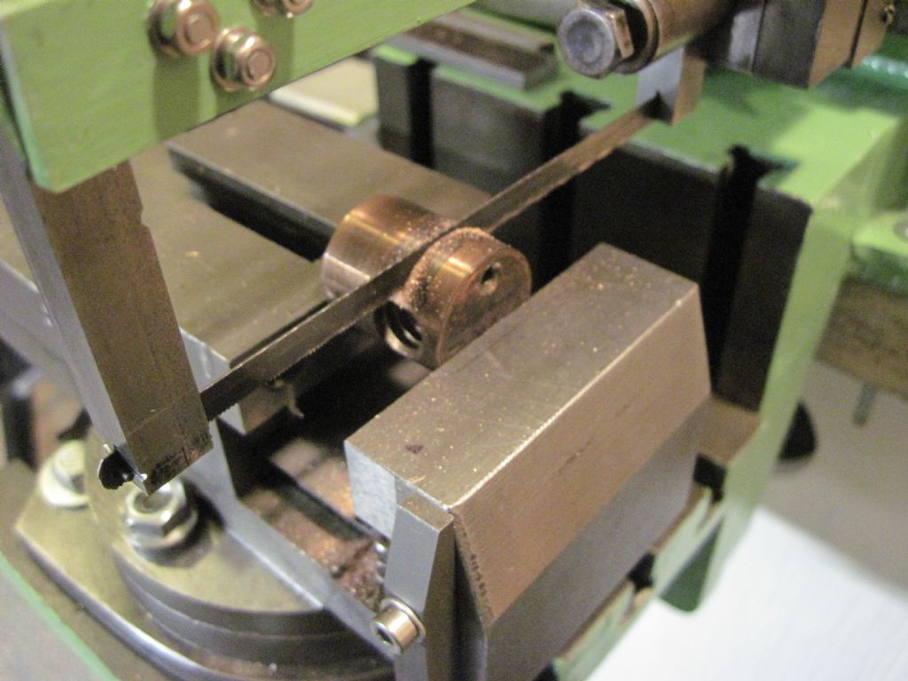

                        I've always had problems getting the blade to cut straight in both large and junior hacksaws. I'm sure with practice this could be improved – but frankly life it too short. So I still "hack" (and often also chain drill) with the larger saws – but where I need a truer cut (and my slitting saws are not suitable) I now use this saw frame in my Adept hand shaper. Didn't take too long to do and it works well – so was well worth the effort in making.

                              Very interesting vice you have there Ian as well as the saw frame. More pictures please.
                                  That vise looks to be far too small for that shaper! Especially with the shaper in manual form! Perhaps just robust enough to prevent it being ripped away on the power stroke.
                                  I want one, too.smiley​
                                  Edited to ask if the down-feed is gravity, somehow, or manumatic?

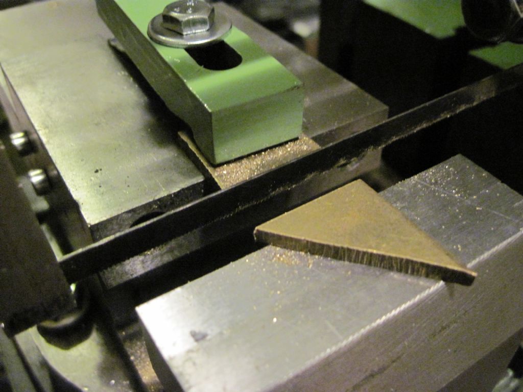

                                        NDIY – well in my view – it's really too large (or at least too tall) but I'd previously been using a (much smaller) old Myford vice and I really missed the rotary action of the shaper vice on my Acorn 7". I saw this topslide/vice at the Brooklands MEX a few years back and the trader accepted a silly offer (it wasn't priced too high to begin with) – so I had it. I suspect a lot of folk were puzzled by it – but I believe it came off a Chronos combined Lathe/Mill.
                                        It's very accurately ground externally – but most other (internal) surfaces were pretty poor – so I re-surfaced the (reference) bottom face in the Acorn and also added some tapped holes to take various different clamping accessories – either to hold small work pieces directly or to hold positioning/toe pieces to help stop things moving under cut. Since I didn't pay too much for it, I forgave myself any vandalism undertaken.
                                        Bayzle – here are a couple of photos of the saw/vice being used. I wanted to remove some backlash in a feed-screw, so I needed to halve the nut fairly accurately (it was done in two cuts, with packing shims on the second cut). The other photo is just some 1/8" brass where I needed a small bit for a fabrication. The saw wastes very little material and the cut face cleans up easily. The cut face you can actually see was a much earlier 'chop' with a hacksaw – and is not nearly so nice. The T-slot on the top off the vice makes clamping really easy..
                                        I won't put anything more up here – as Neil asked me for an article about Hand Shaping last year, which I wrote covering some of this same ground. At the time I was thinking there hadn't been too much written about Shapers in recent years. Bill Morris beat me to it with his series about rebuilding and using his powered shaper, so I guess my article will now appear sometime after that finishes. I was trying to keep it short (which is really hard for me!) so I'm afraid my 'Words & Music' are a lot more 'terse' than Bills excellent articles. Shaping is quite a large subject to try to cover quickly…

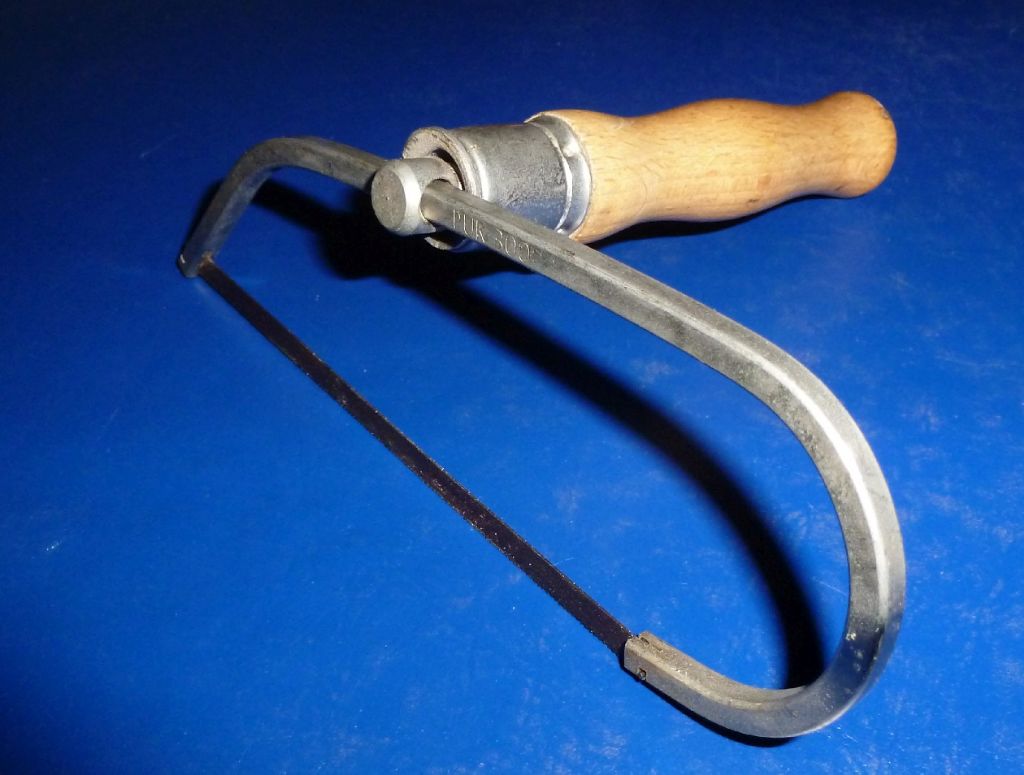

                                                RE: "I nearly jumped to buy one at that price ^^^ But the one in your link is the fixed-handle variant"
                                                My apologies (note to self – must read the small print !).
                                                I certainly paid much less than ca. 20 Euro when I bought one from a French supermaket a couple of years ago but checking now, it's marked with "PUK" so maybe a Korean Elora copy.
                                                The other feature of those saws is the ability to put the handle at 90 deg to the frame which has saved grazed knuckles a few times.

                                                  Thanks for the photos Ian. I might make something for my Drummond. It has a vice with a vertical bolt through the movable jaw so I could also use a longer bolt to work with a clamping bar. Never though of that before.

                                                      No need for apology, it was a nice thought !!
                                                      If you look at the page in the catalogue that I linked earlier, they are called PUK
                                                      … I presume that it is equivalent to 'Junior'
