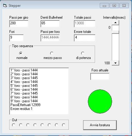

                                          Ten years ago, though I didn't have a specific need, I liked very much the idea of the J.A.Radford headstock indexing attachment and thought of putting a stepper motor on its worm shaft to spin it.
                                          The stepper would be driven using an old laptop via the parallel port () and I made a small Visual Basic program, using a DLL (IOPort.dll, I think to recall) to output the signals ( these had to be "strengthened" in some way before sending them to the motor, naturally).
                                          Here is an example of how it worked: the three input data are:
                                          – motor steps per revolution: 200
                                          – bullwheel teeth: 65 (I own an ML10)
                                          – holes to be drilledteeth to be cut (9 in this case)
                                          Dividing 13000 steps by 9, gives 1444.4 period, so each position will be 1444 steps apart from the previous one, and we will have to spread 4 "orphan" steps on the whole revolution (this is done 3 times, on holesteeth 3,5 and 7, the 4th step is not added, though now I see that it could be added to the first or the last step…).
                                          Hitting the button started the sequence, the 8 outputs to the Data pins of the port were monitored in the Out frame, the DLL provided a choice of the kind of sequence used to drive the motor and it was possible to change the interval between one sequence and the next, to adapt it to the stepper.
                                          As with a lot of my projects, I didn't proceed further with the hardware part, due to lack of time, but who knows… (today I think the motor command part is even simpler)
