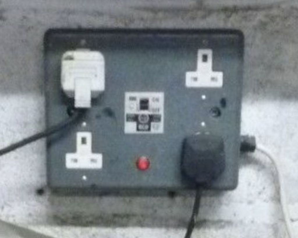

      Regarding the item picture below:
      What is its correct name / description? (google return no match for either image search or misc. word combinations)
      Are they 'retired' or readily available?
      I have been searching for such for some time.
      Regards
      Frank C.

          This is getting close : **LINK**
          https://prolight.co.uk/product/penn127

          DC31k
            @dc31k
            Use some or all of the following terms in your search: 'metal clad', '4 gang', 'socket' possibly with the addition of 'industrial'.
            It would help greatly if the photograph allowed us to read the text on the RCD in the centre.
            A similar, modern, domestic version can be seen at Screwfix 3241F. This is eight gang, but it gives a manufacturer, BG, and Schneider, another manufacturer, pops up in the sidebar.
            You will need to look through the catalogues of mainstream, name-brand electrical manufacturers for further inspiration.

            Emgee
              @emgee
              The centrally located switch appears to be a Wylex RCCB, no doubt to provide fault protection for the socket outlets.

              Chuck Taper
                @chucktaper
                The picture is a clip from a background of another picture. It's all I have.
