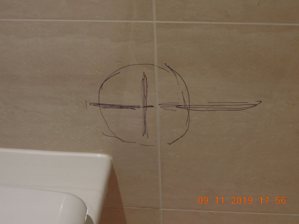

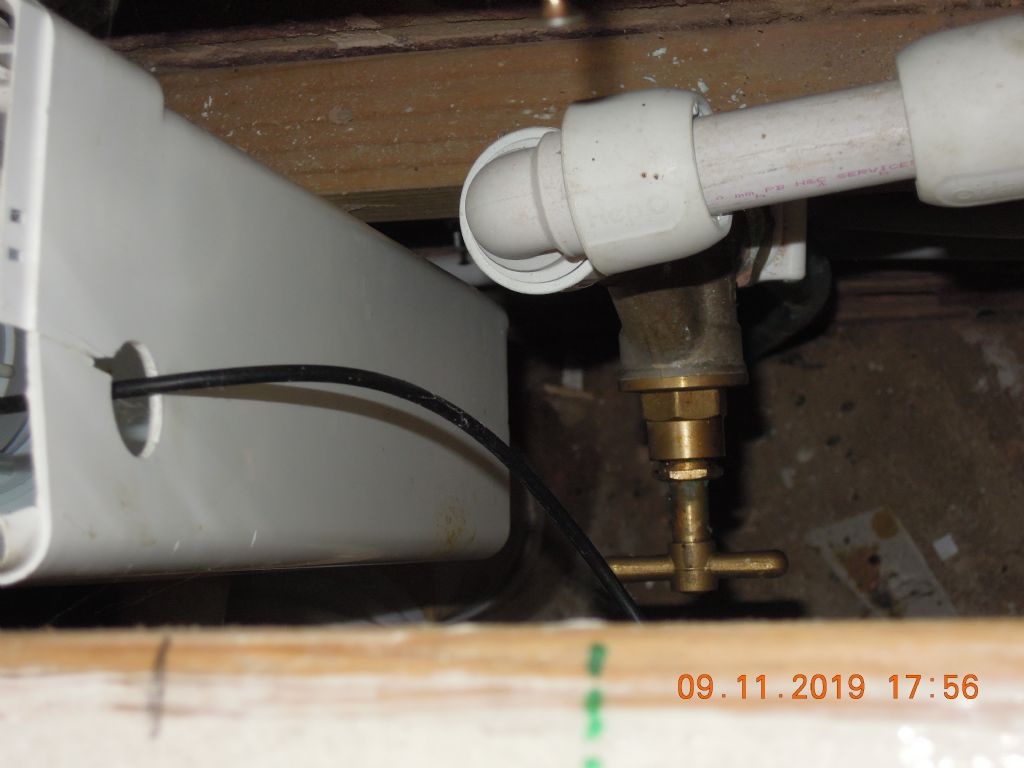

      After some guidance again… A builder, god bless him, has done a superb job in boxing in my mains stopcock with tiled panels. He obviously thought access through a very heavy removeable granite cover and a long reach down at a funny angle would be a piece of cake. I knew 6 years ago this was going to be a pain and now that I have leaking ball-cocks and other things to attend to I find that is definitely is..
      My plan is to make a hole through the tiled panel to gain direct access to the tap. I'll machine up a plastic cover for the hole when not in use.
      I'm thinking I need to get a big SDS drill and a diamond toothed hole saw. The tiles, I know from experience of drilling holes for other brackets, are very hard and 10mm thick.
      Is a hole saw the most sensible solution or should I do things differently ?

          Diamond coated holesaw will do it in a cordless. Cheap enough from the far east, I use Richon
          Use it to drill a hole through some 6mm ply or MDF then hold that against the wall to guide the holesaw until it has started the cut, slow speed and keep wet, I just dip the end into a bucket every 20secs or so.
          You don't really need it big enough for your hand, make a tool with a forked end to sit over the stopcock handle with a tommy bat on the opposite end. Plastic cap from a cardboard tube may suit to plug the hole.

            If you have a spare tile or can acquire one, perhaps give consideration to removing a whole tile and making a new tile sized access panel. Good chance of cracking a tile with a diamond hole saw especially if hand held and you are going in across two tiles in your picture so possibly more damage.

              The hole you have marked out seems a tad big to drill out, could you not manage with a smaller hole & make yourself a tee bar/tube with a slot in to cover the tee piece handle of the stop cock, say 3/4 – 7/8 ( 19 – 22 mm ) & use that to operate the tap?

                For cutting I'd suggest a diamond core drill rather than a hole saw. Difficulty is holding it in position. Make sure the drill has a clutch, if the bit snatches it will break your arm without.
                As an alternative could you cut a slot in a toothed pulley, slip it over and clamp on and then use a belt to turn the pulley? To be fancy a slot half way through on one side could engage with one side of the valve handle. maybe even a shaft and drve pulley across the top of the "wall"

                    Or if you have sufficient clearance and reach cut two opposing slots in a socket with an angle grinder and use a ratchet. Failing which weld a suitable 'u' section to a bar and you may loosen it sufficiently to finish by hand – reach??

                        You could try a ShureStop valve after the existing one, then you only need a 1/4" hole for the air tube

                          Holding the guide in place is not easy, especially on a slippery tiled surface. If time is not pressing, glue the guide on 24h in advance using hot glue or silicone.
                          I agree with the others that a small hole is all that is necessary. With a bit of careful measurement, you can drill on centre of the tap, expose the screw holding the handle on, remove the screw and handle and use a square socket on an extension to turn it. Remember when finished not to leave it fully open.

                                    After careful thought I went for making a big hole. It was a kind of 'in for a penny in for a pound moment' with the advantage that I can put my hand in to attend to some other things as well, as they become necessary.

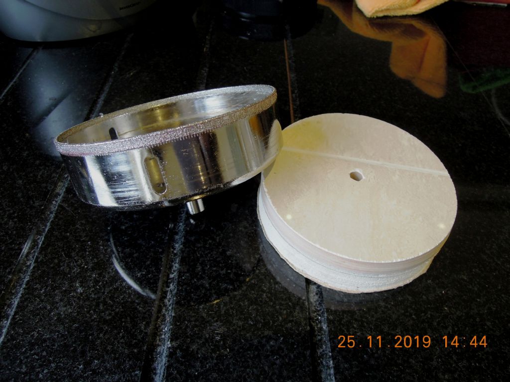

                                    Jason B – Thanks for the Richon link. What an interesting site that was too! I ended up buying a 105mm diamond core saw and it took about 10 days to arrive. I cut a piece of ply and fixed this on the tiles with single a screw. The saw cut through the tiles went beautifully with only the tiniest of chipping at the edges of the hole. The cutting part took about 10 mins and I wasn't trying.
                                    I have a sheet of white acetal for the cover. I'm hoping a soak in some coffee should give it a coloured tint to help it blend in with the tiles.
