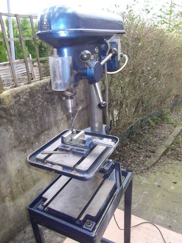

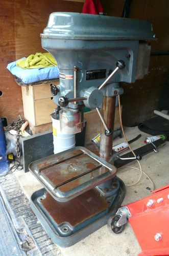

                              The Merry Miller
                                @themerrymiller
                                Don't forget the Meddings progress drills.
                                Bought a MK 2 from e-bay last year in very good condition apart from a little surface rust, for just over £200.
                                This one had a MT2.
                                The Meddings people are also very helpful to deal with.
                                The one below I didn't win sadly.
                                Edited By The Merry Miller on 21/07/2014 19:26:13
