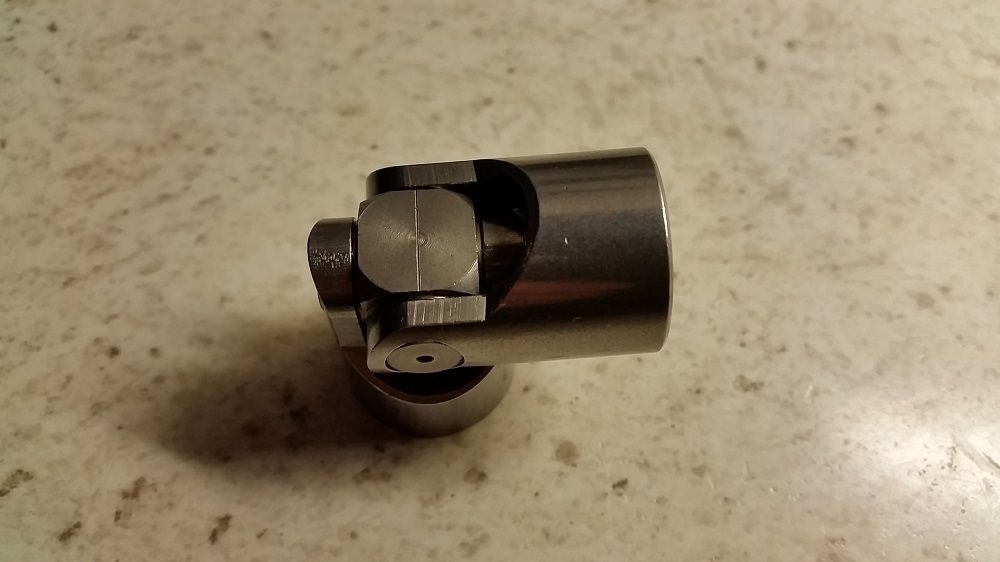

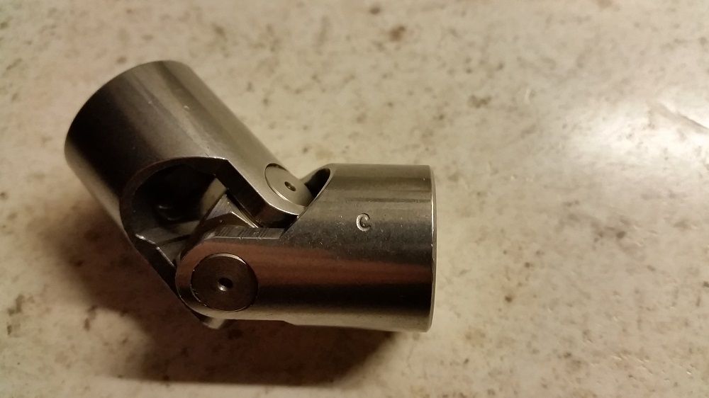

      uj2.jpgHi,
      I have purchased a metric UJ from RS Components and need to undertake some machining to make the bore and OD suitable for my requirement. The slightly protruding trunnions have made me give up trying to hold the UJ in either 3 or 4 jaw chucks). To that end I'm seeking advice on how to dismantle the UJ please. The centre block has a line etched across one face and I'm thinking that would be the continuous trunnion and I'm planning to drift it out. However the opposite housing piece has a letter "c" engraved on it which could also mean continuous. I've got a couple of snaps. Any advice most gratefully received! Cheers, Vernonuj1.jpg

          I may be wrong, but: I think you would regret dismantling it … it will never be the same again.
          I would turn a split collar to increase the effective OD; modify the bores, and then re-mount on a mandrel to modify the OD.
          … I'm sure you will get a variety of alternative suggestions

            I agree with Michael that is not a good idea to try to dismantle the UJ. I would have thought it was possible to grip them in a 4 jaw chuck with the jaws at 45 degrees to the trunnions.

                  The reason I've had problems mounting one end on a 3 or 4 jaw chuck is that the trunnion ends are slightly proud of OD of the main body and at least one always interfere with at least one of the jaws. I had thought of grinding the trunnion ends down below the OD and then trying to mount it in a chuck and I guess I'd have to go that way if I sought to use a split collar.

                        Make a collet to suit the o/d, then counterbore aprox. in the middle to clear the pin ends. The slit in the collet should allow enough clearance to pass the pin ends ?

                          Circlip – I've tried at length but can't avoid all the trunnions.
                          Gordon – I think you've put me on the right path. I can see how that would work. Thanks

                              The original installation had the shaft pinned to the lower UJ and was a sliding fit with the upper drive shaft which featured a keyway. I'll use a slot drill to cut the keyway because it's straight into the shaft.
                              Plan now is to turn the end of a 1/2" shaft to force fit into the UJ. Drill and taper pin. Place shaft in chuck and turn OD of one end of UJ body to 15/16". Fit and pin shaft with keyway to other end of UJ. Cut first shaft to length to suit knee housing gearbox. Apply new gaskets. Fill gearboxes with oil. Stand back and admire my work.
