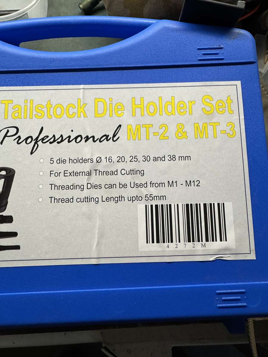

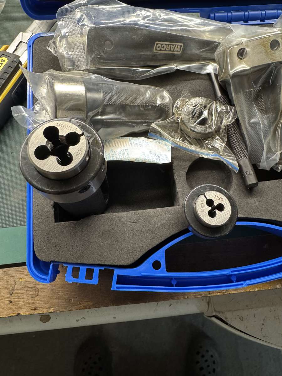

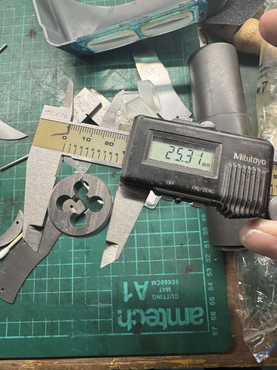

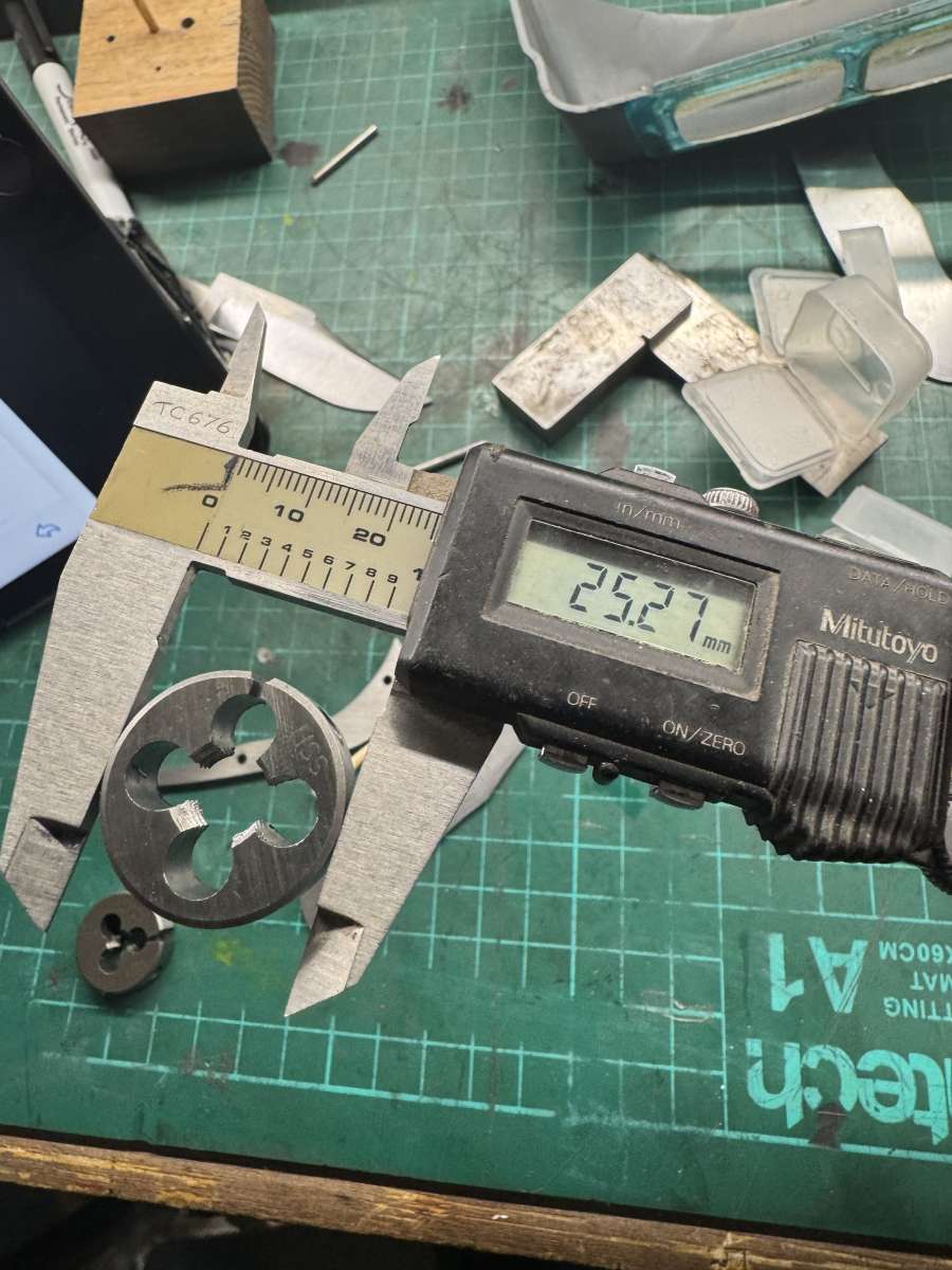

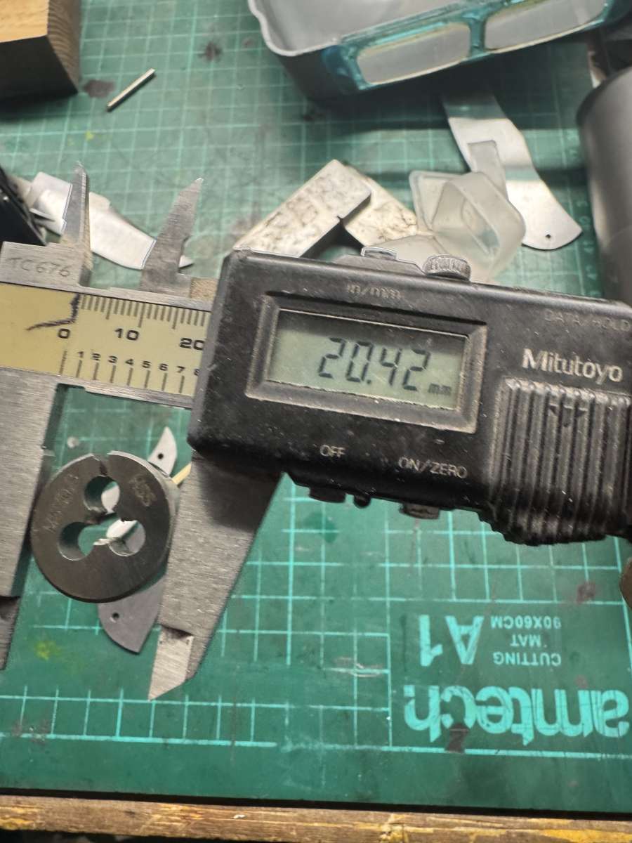

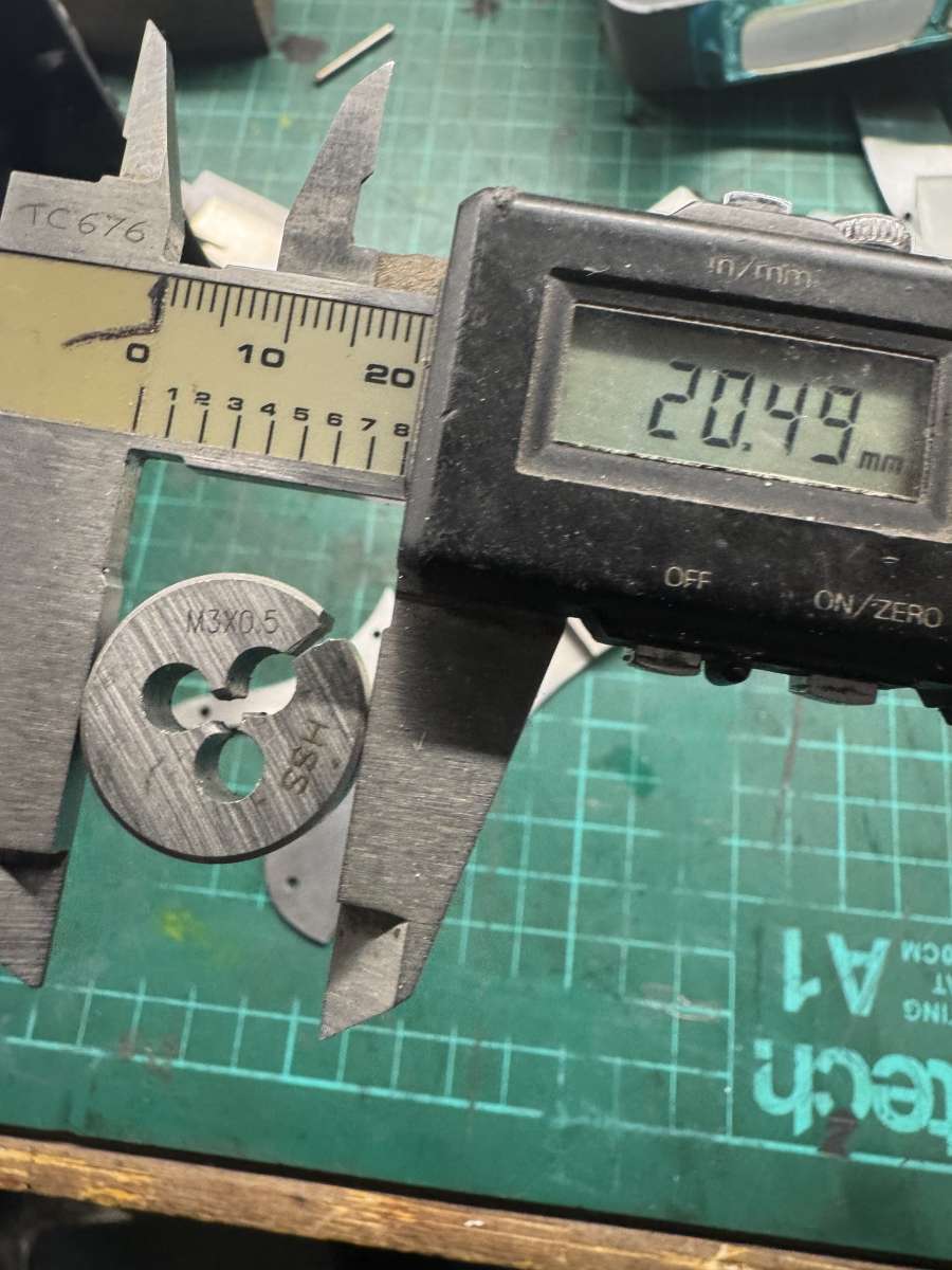

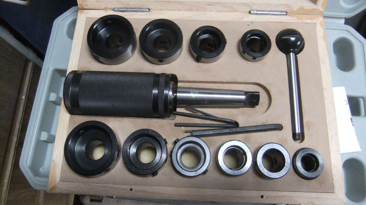

      Ive just bought a tailstock die holder and some metric dies for some threading I wanted to do this weekend. Unfortunately the dies I’ve bought won’t fit into the die holders. When I measured the dies they all seem to be over size. Is this normal or am I missing something or bought the wrong dies????
      IMG_1855IMG_0828IMG_1856IMG_1857IMG_1858IMG_1860IMG_1859
      #820445
      duncan webster 1
        @duncanwebster1
        Common size for dies is 13/16 and 1 inch, which looks like what you have. What size is did holder?
        #820447
          I would say you have imperial OD dies mascerading as metric or at least an inaccurate metric description.
          the ones that are just over 20mm are most likely 13/16″ nominal and the ones just over 25mm are 1″ nominal

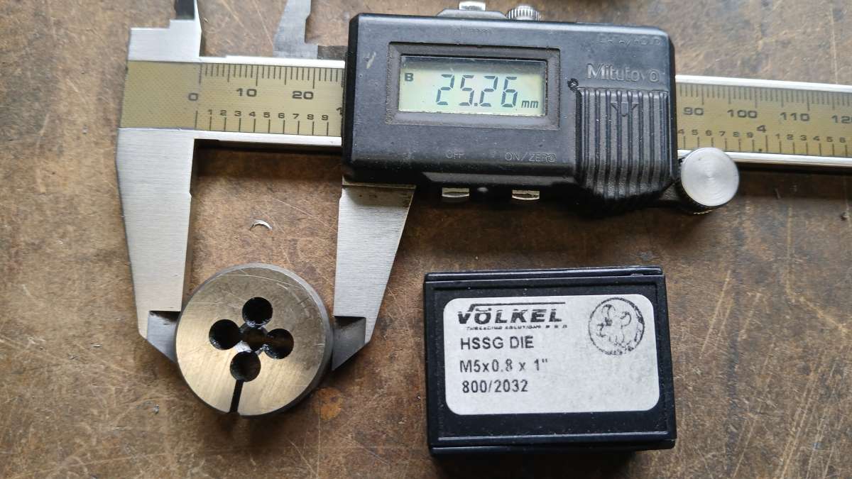

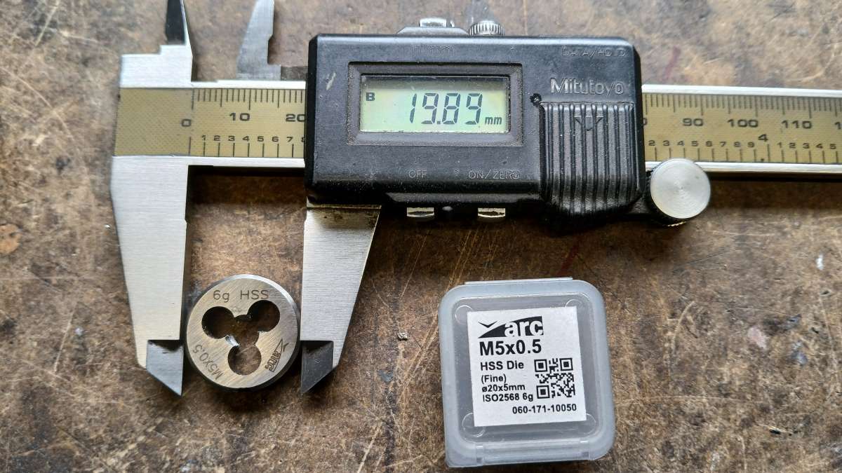

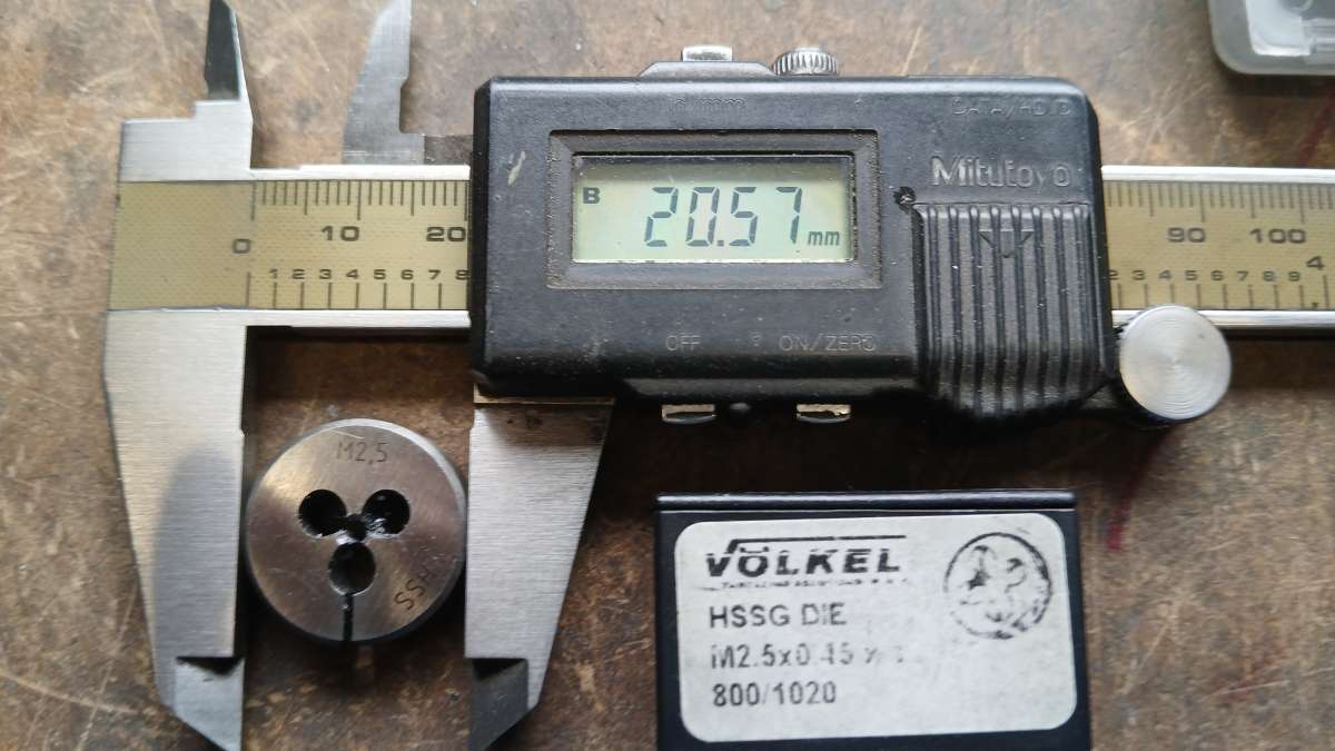

          #820449
            This is a 1″ die
            20251016_132742
            This a 13/16″
            20251016_132907
            And this a metric 20mm OD
            20251016_132822

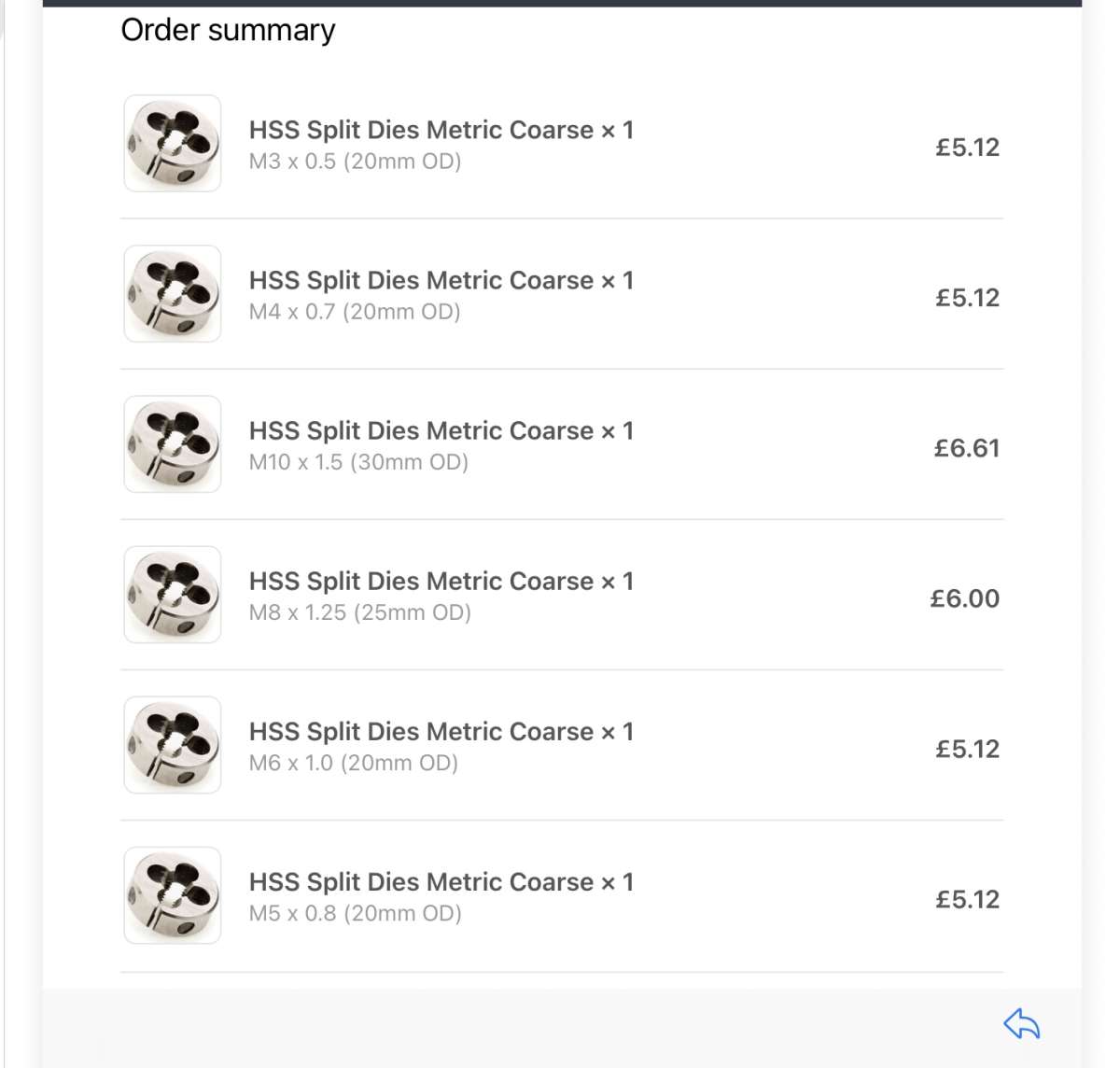

              Thanks Jason, is this normal or should I send them back?
              #820454
                Imperail OD dies are quite normal and can be used in imperial sized holders. However you have bought what is listed as metric OD when they are not so would have a good case for return particularly as you hove a metric holder to put them in.
                An alternative would be to change the holder for an imperial one and make sure you don’t buy any more imperial OD dies. This may be the better option if you also intend to make things where imperial threads are specified as imperial thread dies tend to almost always have an imperial OD but metric dies can be had with either metric or imperial OD.
                The other option is to make some imperial holders to suit your tailstock die holder and then you are covered for any future dies you buy.

                  I’ve emailed the company I bought them off so I’ll wait for their response. Many thanks.

                    All the holders are metric sizes as advertised on the box lid.

                      This is something to watch out for I think. Most of my Dies are metric threads and have imperial bodies to fit my Die holders.
                      How long have they been making metric bodies and metric holders?

                        If it were me I’d just set up the 20mm and 25mm holders and bore them out yo 13/16 and 1″.

                          My tail stock die holder came with both imperial and metric holders.

                                          I took the precaution of buying a set which has both imperial and metric die holders, at least that should cover me for the sizes I use
                                          Tailstock Die Holder

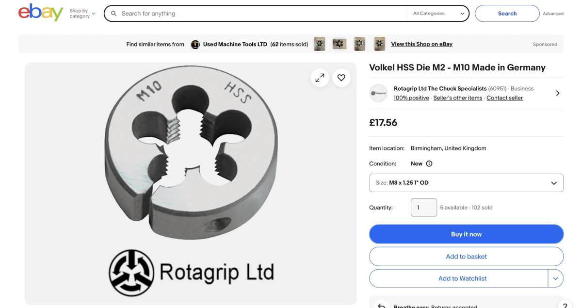

                                          Vic
                                            @vic

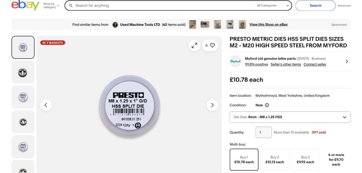

                                            Only a quick look on eBay but the Volkel dies I saw were imperial OD, just like the Presto ones, only a lot more expensive.
                                            IMG_5873
                                            IMG_5874
                                            #820576
                                              Confirms what I said
                                              Volkel make almost exclusively metric OD dies but they do make a few with imperial OD for legacy users who have imperial tools particularly the UK market as mainland Europe tend to be metric which is why I bought their imperial OD ones and why the likes of Rotagrip stock them.
