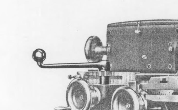

                        It is a metric machine (Schaublin 12) so indeed probably MOD
                        #408150
                        Adam Harris
                          @adamharris13683
                          #408151
                            Adam,
                            That looks like an ideal application for a circular pitch rack [be it Imperial of Metric]
                            … measure carefully

                            Adam Harris
                              @adamharris13683
                              I will revert tomorrow in the daylight with measurements
