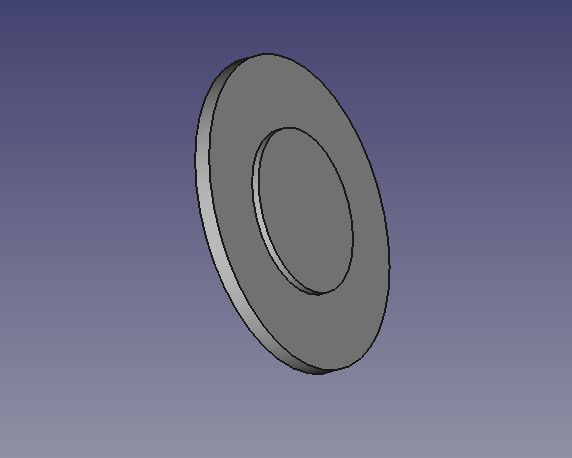

      I have a piece of BMS plate 1/8" thick and using it I want to make a cylinder end cap.
      The cap needs to be 34mm O/dia and have a spigot 20mm dia and 1mm long to fit the cylinder bore.
      Any ideas on how to hold and machine.

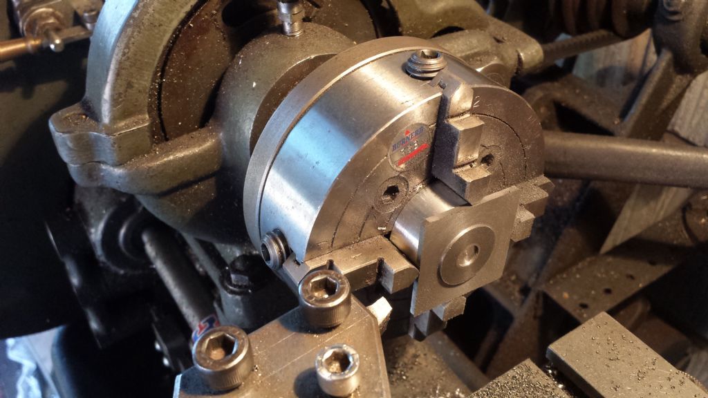

            If you mean like this:
            I'd saw a square out of the plate and take the corners off with a file leaving a rough octagon big enough to make a 34mm disc. Then I'd super-glue the octogon to a round bar held in the chuck. I'd turn the 1mm deep spigot first, and then round off the rest of the cap.
            Take it gently and the super-glue will hold the interrupted cut, (may not be necessary to file the octogon first, but it reduces the clonking!)
            Super-glued parts can be separated by boiling, blowlamp, or soaking in acetone (aka nail varnish remover).

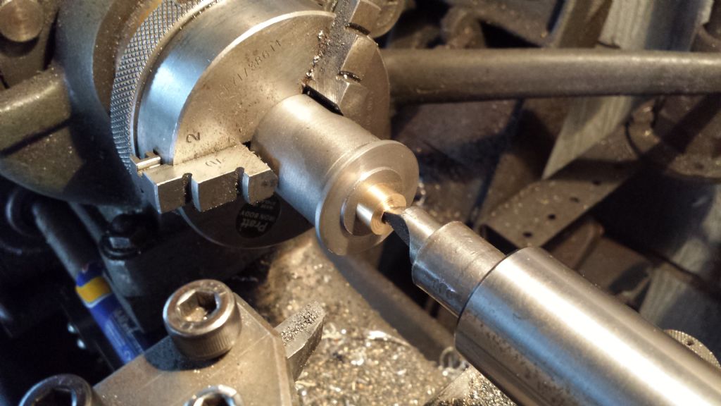

                  Same as Dave and Rod, if you have any doubts about your glue the tailstock can be used to hold a pressure plate against the part while turned. I tend to use Mitre bond or the small 5mm bottles of Loctite superglue

                    Hi Geoff I would hold in 4 jaw turn boss leaving outside till later and counter bore a 10mm conterbore as deep as the boss for a centre support. I have a piece of 10mm dia. silver steel with a centre in it to push against jobs. Take out if 4 jaw chuck and hacksaw of corners clean up and glue to a bar with super glue. Hold in place with centre support and Finnish outside diamiter and face.

                          As soon as you glued it to a boss and mounted into a chuck etc, bring a rotating centre up to bear onto the plate for extra support.

                            Will use the tailstock for support. I like Davids idea of using a shallow counterbore.

                                No big deal this but as you guys were kind enough to offer advice I thought I would show the results.
                                I was surprised just how easy, by heating, it was to break the superglue joint between the cap and the boss. 20190430_075056.jpg
                                Jobs a good 'un, thanks again Geoff
