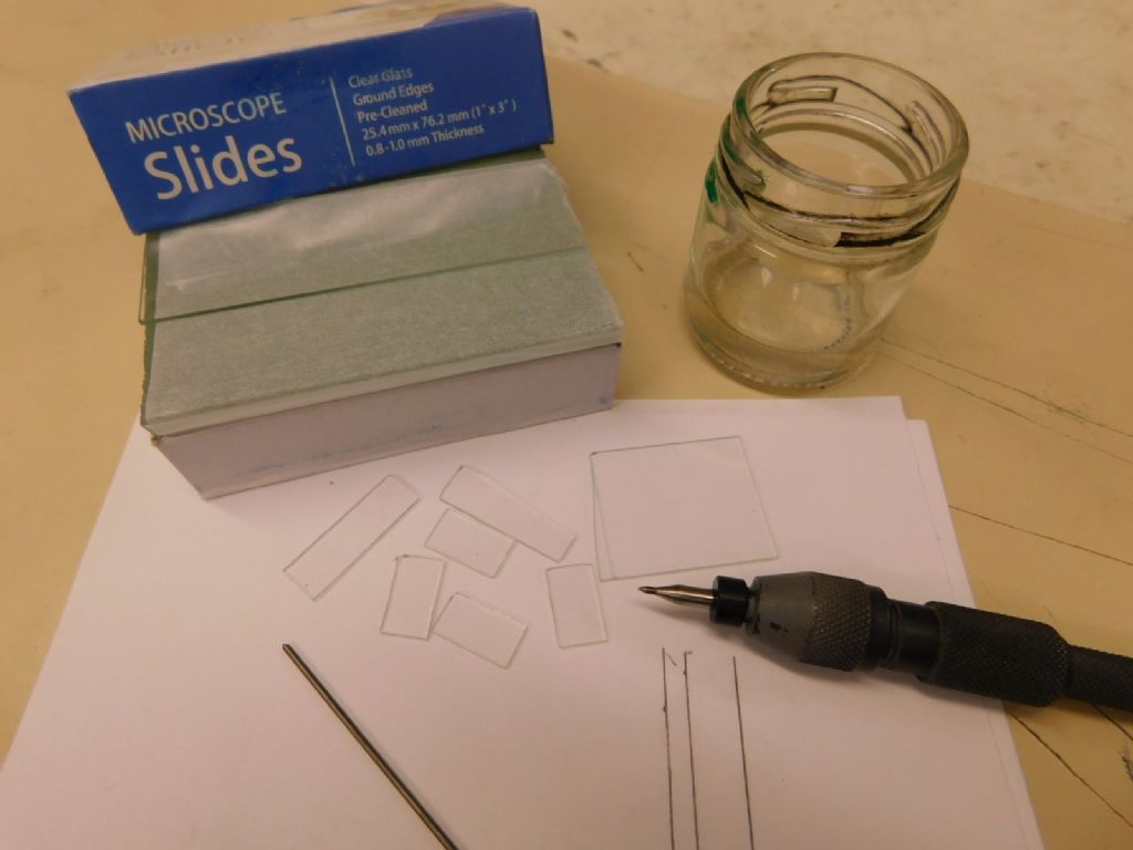

                                            Hi guys – as promised an update on trying this for the first time.
                                            When the slides first arrived I had a tentative go on the corner of the bench using the diamond – no luck but a carbide scriber did appear to be an improvement however three shattered slides later and only one piece the size required I decided to put all away until a more controlled approach could be entertained.
                                            Well, setting up on a nice clear bench this afternoon I used the carbide scraper and white spirit as a lube. The glass was laid on about five sheets of plain copy paper for some 'give' under the scriber. Amazingly I got five 8mm wide strips from the one slide and four of these were cut to give the 11.5 mm dimension. I did need to scribe more than once on each but held with the line over the wire after scribing the glass cracked easily under finger pressure.
                                            This is the remaining waste glass

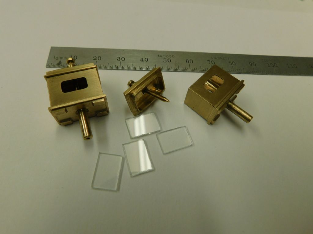

                                            And these are the pieces required along with the receptacles. These are two oil reservoirs for the main bearings on a stationary engine. The glass will be epoxied in place each side
                                            My thanks to everyone who responded to my question including 'br' who offered to do it if I had issues – I took note of what was said and it has proved of great help. No one is more surprised than myself for the low scrap rate today so good on you guys.
                                            Ramon (Tug)
