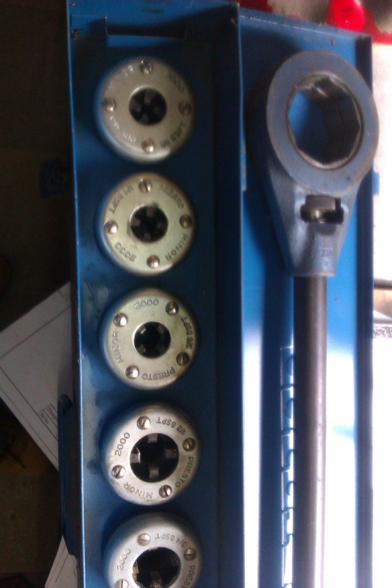

                    #188302
                      With the big hefty pipe threaders there is no need to put a taper on the pipe but if its a small split die then even 3/8BSP parallel needs quite a bit of elbow grease so cutting a small taper for BSPT will just make the job a bit especially on stainless.
                      Also worth remembering that the pipe threading kit tends to have a guide to keep the die head true which you won't get on a split die so again a bit of a taper will help things along.
                      This is what I sometimes use on the models especially exhaust pipes on the hit & miss ones, this is 3/8BSPT
