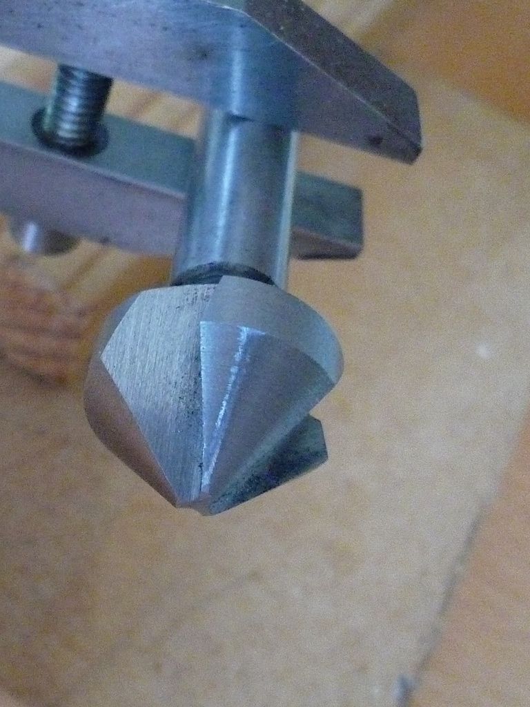

      Just been countersinking some mild steel and been rather surprised by the exceeding poor cutting ability of the countersinks I have – set of 3-flute HSS from RS. I’m countersinking a 7mm hole to about 12mm overall (for an M6 CSK).
      It was all very nasty with considerable chatter. Given that in my Wabeco mill i can use a 2.5 inch facemill without it dropping speed at all, runout is imperceptible,  and i can drill/mill up to at least 12mm (so far) with fabulous accuracy and surface finish, I’m going to blame the countersinks. It was all rock solid in a decent mill vice too.
      I also tried a Nine9 indexable 90 degree spot drill (brilliant for chamfering!), but to be fair i was at too great a diameter (over 75% of the diameter of the insert) and this didn’t like it a lot either.
      In the end, I  used the 21mm countersink at high speed (2500 rpm) and just faced off a fraction at a time to get a decent finish out of the rough countersink I had already got. It’s good enough now but not an experience to repeat.
      I did notice that on the 3-flute 21mm csk, one of the flutes actually showed a slight scuffing on the ground section a couple of mm behind the cutting edge – in other words looks like that particular flute isn’t even ground such that the edge is actually cutting!
      Now folks, can anyone advise me around a solution to this? Am i missing anything? Or is it just that i need to go buy a really decent countersink? In which case – suggestions? (Guess the RS stuff these days is Chinese…)

          You are running way too fast, put it on the slowest speed and use a little cutting fluid
          As for makes then Hall or Ruko are both good, Try J&L or even Screwfix do some of teh Ruko ones

            Agree entirely with Jason – 2500rpm is a ridiculous speed to run a
            countersink at! I would have thought that 250rpm was as much as you’d
            ever need, and even that’s a bit fast for some bits.

                  300 is still faster than I would run a CSK bit at that dia in steel I’d be looking at 50-100rpm

                    Get the TiN coated single flute made by M A Ford in the USA, J&L sell them.
                    I once spent over £200 buying one of many different types for a large job so i could test them out. The M A Ford ones out performed all the others, even solid carbide ones.
                    I have a twin spindle drill and one spindle is driven by a geared motor at one speed, it can’t be changed.
                    This spindle does 70 rpm and is used solely for countersinking and counterboring.
                    some of my jobs require countersinks of 30mm diameter and these cutters do this with no problems.

                        RJK, I have to agree with all the guys above, countersinking is one operation that defies the normal laws of cutting speeds of materials and needs to be carried out much slower than you are doing – most times as slow as possible to achieve a reasonable finish.
                        Countersinks come in many guises but all will chatter to a greater or lesser extent if run too fast. This normally produces a ribbed surface radiating outwards all round the counter sink. By reducing speed to the slowest possible, if you have a controlled fine feed, this can usually be removed by using very slow down feed. If however it is hand fed ie on the drill machine this becomes far more difficult as the C’sink ‘rides’ the ribbing. This can however, with care, be over come by tearing a piece of emery cloth into a small square  big enough to cover the hole then with the emery surface uppermost  and again at slowest speed bring the C’sink down firmly into contact with sufficient pressure to allow it to cut through the emery. The emery somehow takes care of the ribbing effect and allows the C’sink to cut evenly. This tip was shown to me many years ago and has been used many times both at home and at work to ‘reclaim’ a poorly formed counter sink.
                        Regarding speed for this op my Fobco drill press has a low speed of 400 or so rpm which is far to fast for all but the smallest of holes. To overcome this lack of slow speed for this operation a second motor is bolted to the wall and this drives the drills motor pulley at a reduction which in turn is set at its slowest speed. I can now get about 40 and 80 rpm which is perfect for C’sinking  and tapping.

                              Thanks guys. Looks like a decent SINGLE flute is the preferred route?
                              I’ve tried others from this set i have, and three of them work ‘fine’ – or at least as fine as i will get from them i suspect. No terrible chatter and reasonable finish etc.
                              With the duff one, no amount of slow speed and lube will make me want to use it – it’s just too vicious.
                              Thought you’d be interested in this one that led to the thread: photo attached. If you look at the ‘land’ i have photographed, you’ll see it’s buffed hard well back from the cutting edge. I’ve only used this one once.
                              Worth me sending back do you think?

                                  This looks like a definite candidate for replacement if they will.
                                  As you have photographed it there appears to be sufficient backing off but obviously there is some kind of land that is rubbing and ‘picking up’. If they wont change it perhaps a stone rubbed across that point to reduce the area might improve matters.
                                  FYI I have several types of CS – single, three, and multiflute as well as the type that Ian SC mentions – No real preference they all do a reasonable job but the hole type does cut very well though the cutting area is somewhat limited  compared to other types subsquently the need for several to cover various diams.

                                                      If the picture is the countersink you ran at 2500 rpm, the dull edge is the result.  2500 rpm is way too fast.  The resulting heat softens the tool and the edge is quickly dulled.
