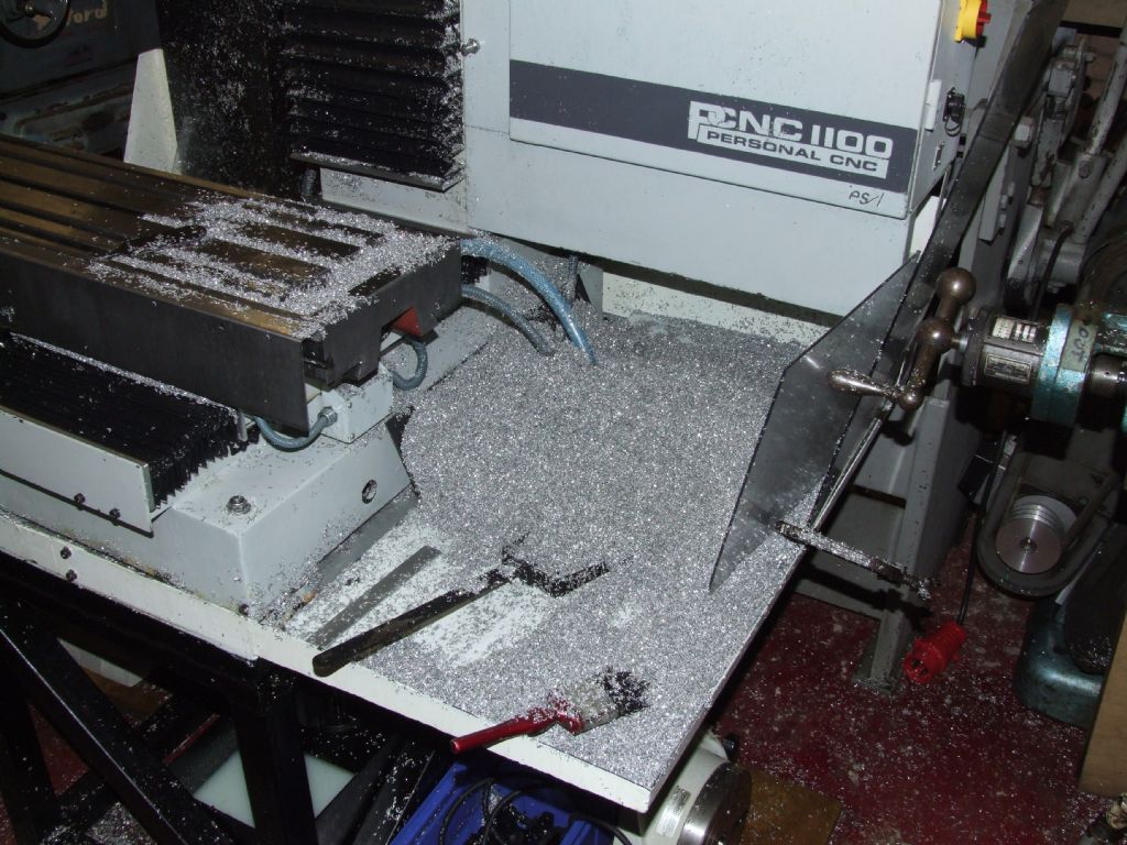

          I mostly turn and mill dry, albeit it with carbide tooling. When I use HSS tooling on the lathe and horizontal mill I use flood coolant, ie, enough to provide cooling without the excess flow being sprayed up the wall or over the floor. I use a water/oil mix; to cool you need flow, drops here and there don't do anything worthwhile. An exception is the CNC mill. On that I use flood coolant at full flow for all materials except cast iron, brass and plastics. On the CNC mill the flood is as much to wash away swarf as it is for cooling. While not industrial quantities the CNC mill can generate a lot of swarf:

            I too usually turn and mill without using coolant. When using HSS tools without coolant I run at a somewhat slower speed than the tool manufacturer recommends as their speeds are for industrial machines with flood coolant.
