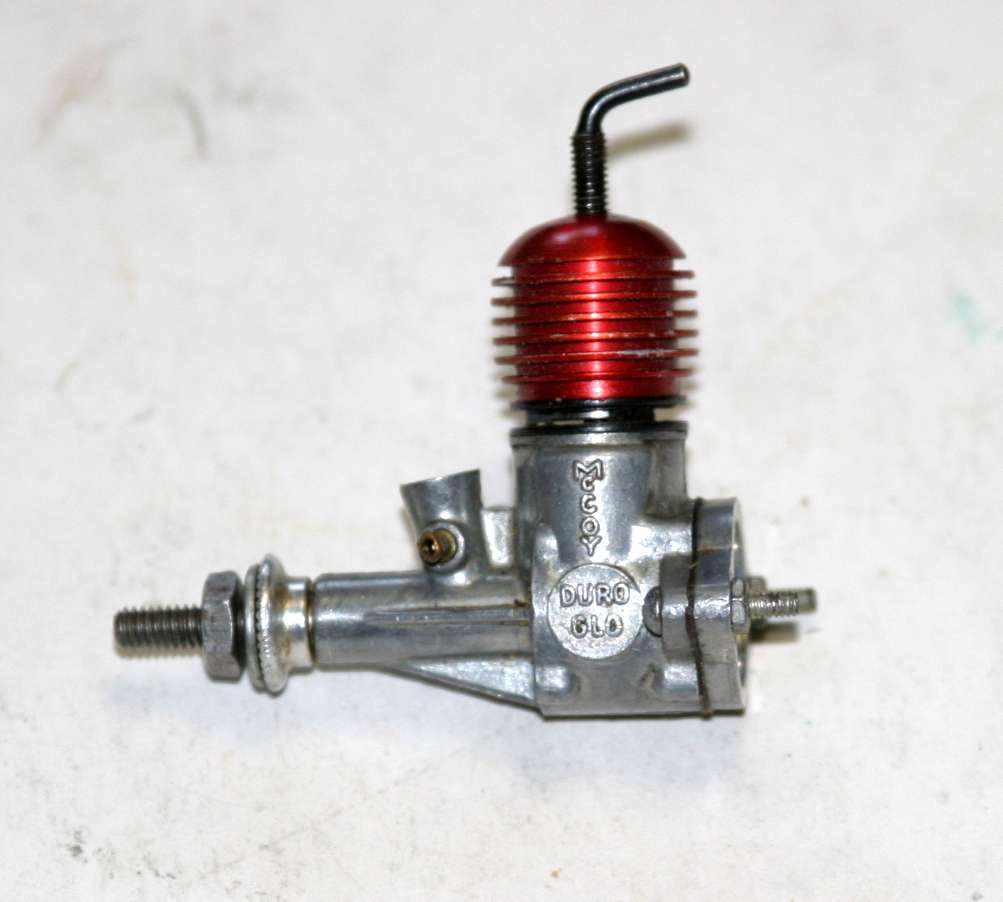

                                I have a .049 McCoy diesel that has a steel liner and a steel contra piston sealed with a “O” ring. Not sure what type, it’s white. The engine is circa late 1950s. Never did get it to run!

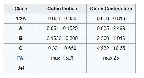

                                  Off topic but….Why are these engines .049 instead of a nice round .05? Was it some kind of daft tax limit?
                                  #839845
                                  Diogenes
                                    @diogenes
                                    ?..racing classes.. ?
                                    #839848
                                      Yep
                                      classes
