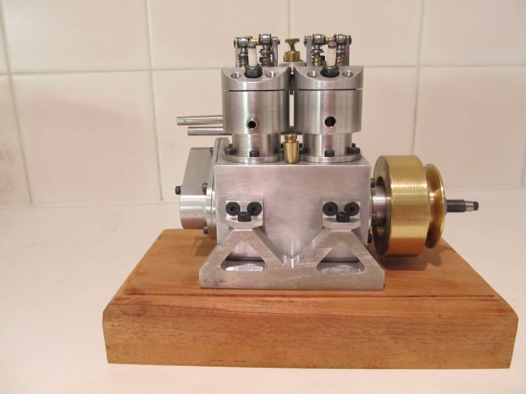

                          BobCat part build
                          Some idea of progress to date. Cams in embryo form, first polishing prior to separation and hardening. Whole box of piece parts as well, rockers, rest of gears, rocker shafts and stands, cam followers etc.

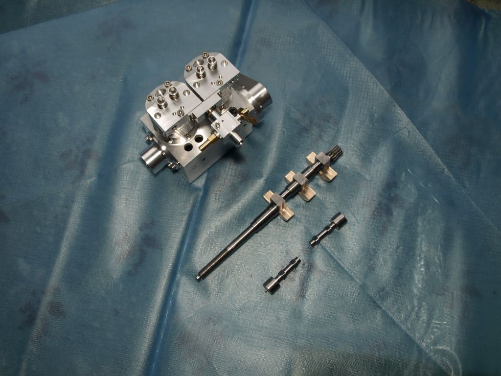

                                        I've made a bit of progress over the past week or so. finished the cylider heads, crankcase, crankcase nose, sump, timing baseplate timing case.
                                        now just a case of making the bits and bobs to go inside
