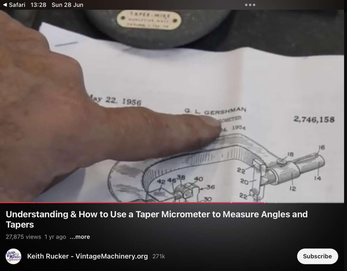

              Thanks to Keith Rucker’s rather lengthy video … here’s an object of desire
              IMG_1766
