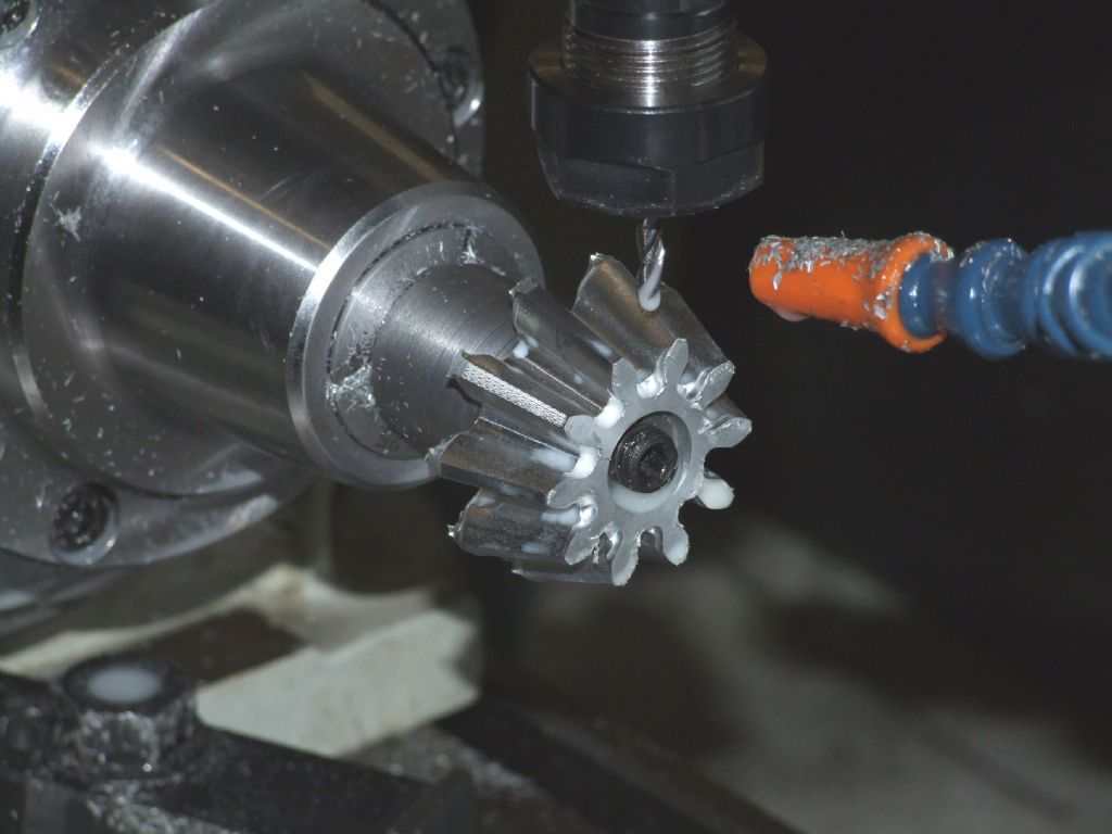

                                                  I have some concerns with the statements that have been made above concerning DH's versus RT's.
                                                  Since when has a DH not allowed the free form production of a radial surface or a slot? (Jason) When a DH will swing through -15degrees up to vertical and beyond (again by a further 15 degrees), this is despite attachments to the mill which allow a inclined table. The handle can be rotated with the plunger in the 'park' position and radial slots and surfaces can be produced.
                                                  How does a stepper controlled RT deal with step 'dead bands', also the step position is accurate only within the range of the step feedback or encoder resolution, or even the electronics bit conversion function. Analogue is infinitely more accurate than digital (SOD – Computers don't get sums wrong – 'altogether now' – Oh yes they do! Try dividing 10 by 3 and then multiplying the answer by the original divisor – guarantee you won't get 10 as an answer). Also how do steppers deal with backlash? Do they 'dither' in the same way as a Moog valve?
                                                  Using a RT as a DH for producing such items as splines or gears is problematic in that the cutter is liable to foul the table, unless the component is hanging a long way out from the table, that requires a tailstock to support the overhang. Also how do you produce a bevel gear on an RT that will only align to H or V? – answers on a postcard please. All my RT's are only designed to be used horizontally, they are designed for that purpose. My DH's are all designed as either simple indexers, universal indexers or compound indexers. The later can be driven off the table drive for spiral milling or they can accommodate ANY division requirement by gearing the index plate to the head rotation; thus giving a compounded angularity by movement of the index plate reference point to the handle movement.
                                                  Sorry to ask these questions but there needs to be 'accuracy of statement' spoken to novices otherwise they will get 'fake news'! And that leads to 'Confusion'!
                                                      Use a CNC mill:
                                                      After Final Cut
                                                      Unlike with a dividing head and involute cutters the above method produces a true bevel gear.
