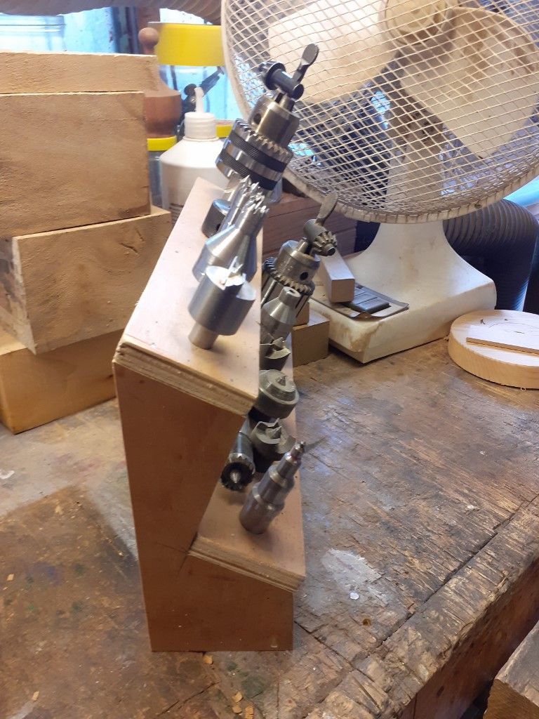

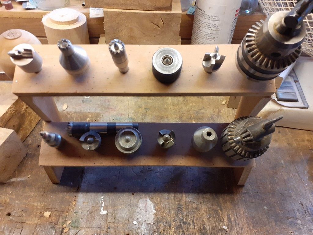

                      I made this for my 1 and 2MT bits and pieces for my woodturning lathe the hole is just a straight hole and holds everything just where I want it(mind you I think I need to enlarge it as run out of room).
                      As can be seen, angled each level for easy access to each one. Top row 1MT and lower 2MT
                      I need to make a second one for all the morse taper drill bits that I have
                      May need to modify for taller pieces.

                              Just back from experimenting in the workshop. Phil P's suggestion of drilling a long hole with a diameter to suit the small end of the taper and then counter boring with a larger hole to suit the thicker end of the taper, works a treat.
                              No sticking and very little slop, if any. A perfect solution and easy to implement too. A little more work than Andrew's method of a single hole in a sheet of MDF, but much better vertical location.
                              Thanks to all those that replied, pity I didn't think of this solution in the first place!
