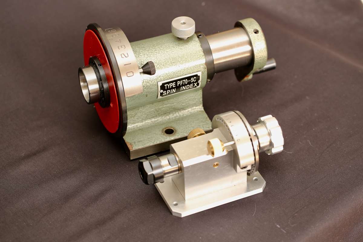

                                        Yes Paul “enjoy your Machining” is definitely what its all about. Heres the Er16 versionS11A6637
                                        #760695
                                          The smaller ER16 version does have the advantage when working with small/short cutters of the spindle mounted chuck not hitting the indexer nut. I get round it the other way by using an ER16 in the spindle as I mostly use my 5C collets in the indexer.
                                          One advantage the blocks have over the spin indexer is that you can work on the part when it is horizontal and then change to vertical and keep things at right angles. Handy for cross drilling clevices and then milling a slot across the end or gudgeon pins and then the hollowing out of a piston.
                                          What is the red disc on the big one?

                                              Swarf guard for the index holes Jason!!!, which is why the ER16 version was built the other way round.
