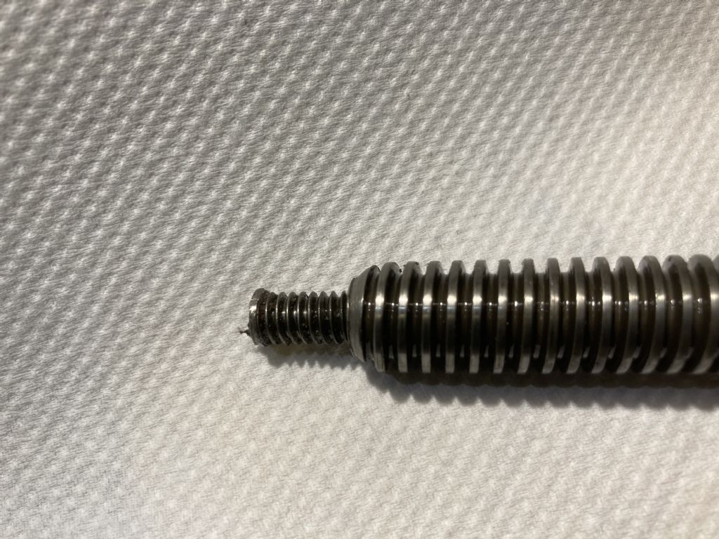

      Please can anyone enlighten me on how to adjust the point at which the tailstock ejects a Morse taper fitting when the barrel is wound back? At present, mine ejects at about 1/4" projection of the barrel, I'd like it to be below the zero point.

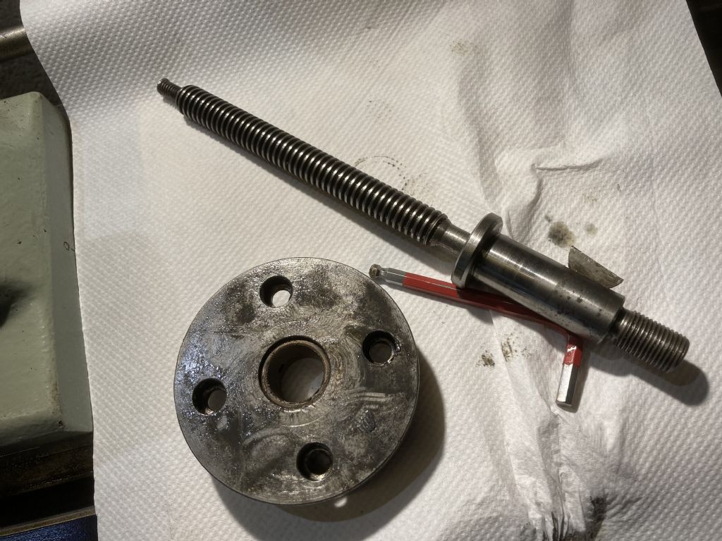

                          img_0138.jpgFor completeness, here is what I've found for adjustment on Mk1 Bantam.
                          img_0140 2.jpgI wound in the 1/4"unc screw in the end of the barrel screw to achieve an ejection of MT fittings at approximately 1/8" below the zero point on the barrel.

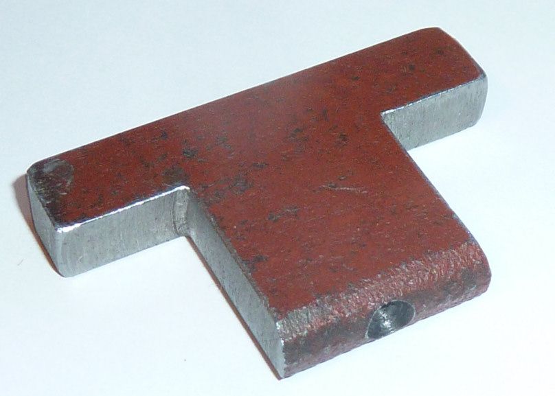

                          #515708
                          Macolm
                            @macolm
                            Belatedly, I came across the spacer piece I made to eject short MT parts on my Bantam. It slides across the slot, then the smaller section is offered against the offending item, and the normal ejection made with the handwheel. Make it a close fit, very similar to photo. While anything that fills the gap might assist ejection, it may get wedged and be very difficult to recover, particularly if ejection fails.
                            It was made from an offcut, and turned between centres.
