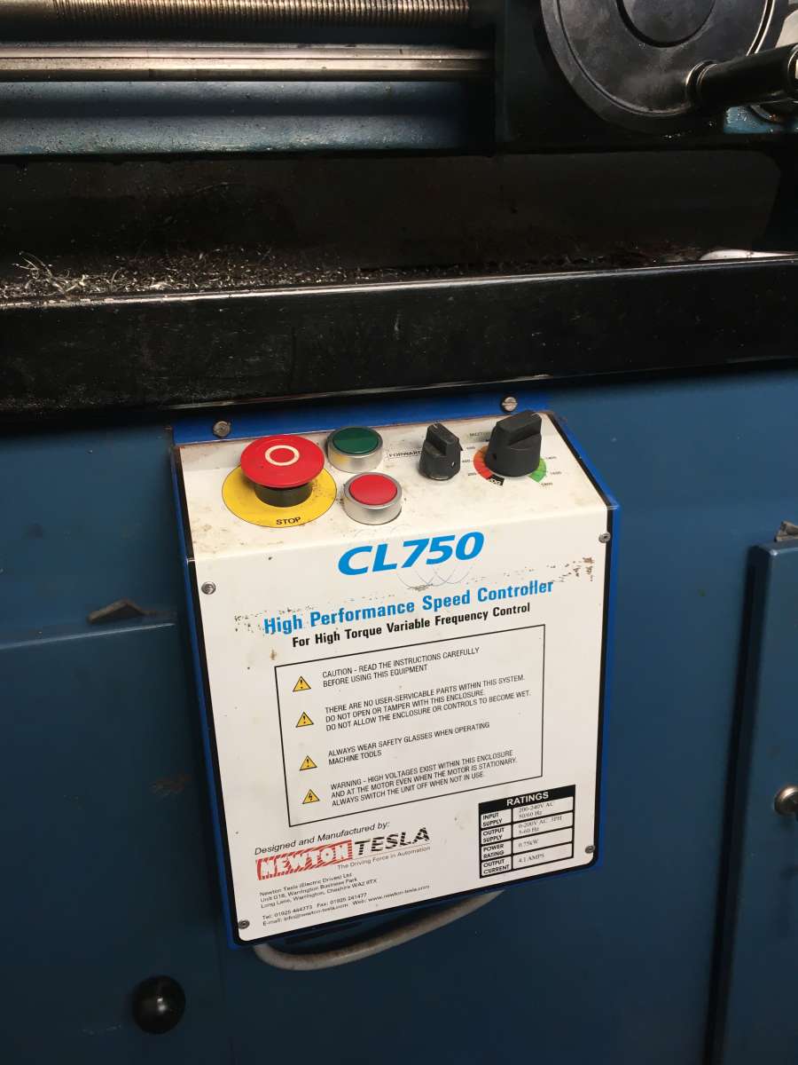

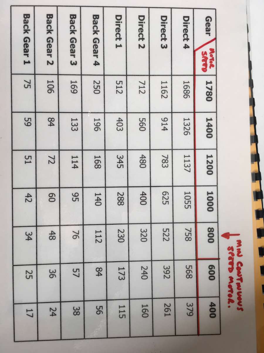

                Richard B
                  @richardb44403
                  I also have a Newton Tesla pre wired VFD on my Denford Viceroy.
                  They supplied the motor and new slim line control panel to mount on the lathe front – replacing the original.
                  I have retained the original emergency foot switch but not the gear cover switches. They advised how to connect it, however similar to the Emergency switch supplied on the control panel it should not be operated regularly – emergency only.
                  VeIMG_0645IMG_0643ry low motor speeds should only be used for shorter periods. I’ve made up this speed/pully chart attached.
                  It has transformed the lathe especially as it was previously a little underpowered and the variable speed control means often I don’t need to change pulleys.
                  I  can confirm they were very helpful throughout and I can highly recommend the system I bought quite a few years ago now !
                  I’m in North Somerset if you want to view.
