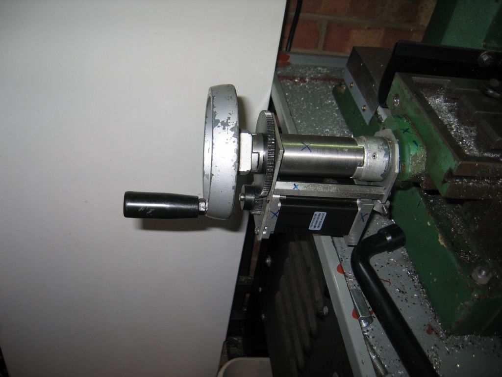

        FWIW I have a Colchester Bantam lathe and a Rong Fu ( like a Warco ) round column mill which I have fitted with a simple CNC, retaining the handwheels – so as to have either NC or manual control.

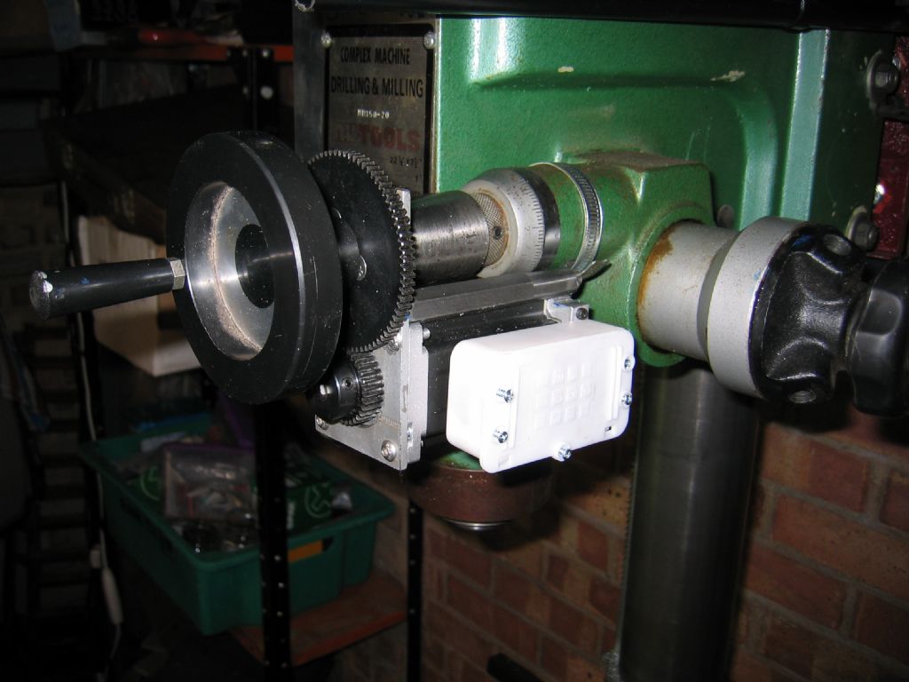

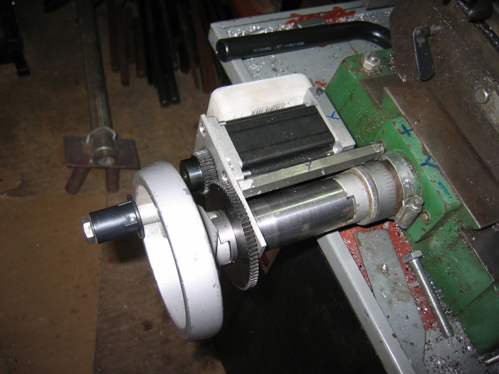

              Hi John welcome to the forum. The CNC upgrade sounds interesting can you give us a picture or two and how do you disengage the motors when you use handwheels and vice a versa.

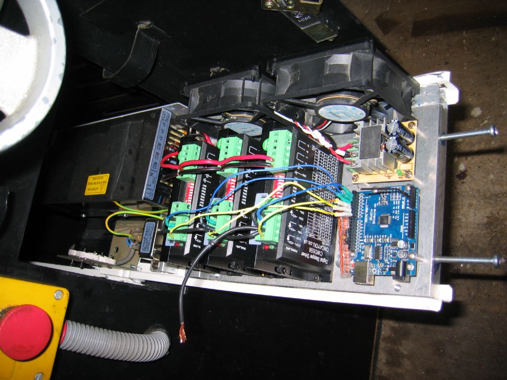

                David, Everybody,
                thank-you for the interest in the RF CNC project.
                I've shamelessly copied a design from YouTube driving the axes leaving the handwheels in place. With the stepper drivers switched on – you can't move them by hand. Drivers off – you feel the steppers cogging over giving slight resistance to motion. The X&Y leadscrews are replaced with ballscrews which would rotate under axial load without that resistance. I'm told that the steppers probably generate backEMF which may not be good for drivers , i haven't had problems.
                 photos  are probably self-explanatory
                The Z acts on the quill. The original quill rack-and-pinion mechanism gives more backlash than i'm happy with.
                Controller is GRBL running on Arduino – works very reliably – I am impressed.
                Arduino step-and-direction output goes to hefty drivers bought with the stepper motors from cnc4you – works fine – photo shows all the bits – subsequently moved to proper enclosure-
                In use for 5 years for shape-simple and shape-complex machining.
                hope that's helpful,
                johns
