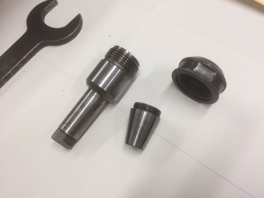

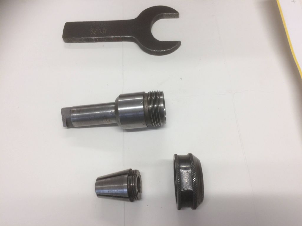

        I have recently found this chuck. The box is labelled Clarke Precision Chuck. It comes with 3 collets which screw into the nut and the arbor is 0.75in diameter. It might be useful but I don't know what for! I wonder if it would be used on a lathe or milling machine and I am a bit surprised that it doesn't have a taper of some sort on the arbor. Anyone seen one before?
        Thanks

          I presume you mean CLARE, if so quite well known. Google is your friend.

            Never seen the like but I have heard of Clare collets with Morse taper arbors.

              Well spotted it is Clare. My mothers maiden name was Clarke so I just read it as that!

                Posted by Bob Sillitoe on 02/07/2023 11:58:46:
                ThanksBob
                Why should it have a taper? A lot of these holders were used on capstan lathes where the turret tooling was made to take parallel shanks, one inch diameter being very common but also 3/4 and of course 5/8 which is used by Myfords for their capstan turret.

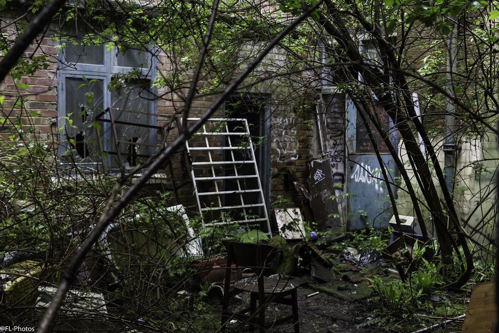

                  and here is a picture of the factory where they were made,, sadly some years after it closed
