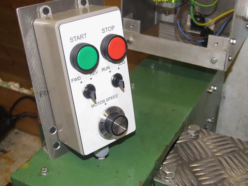

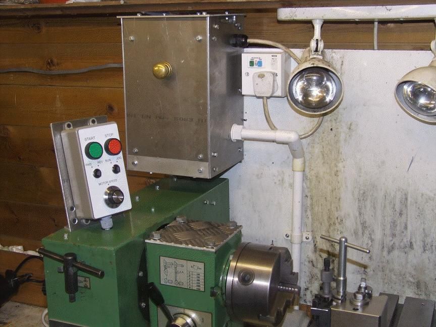

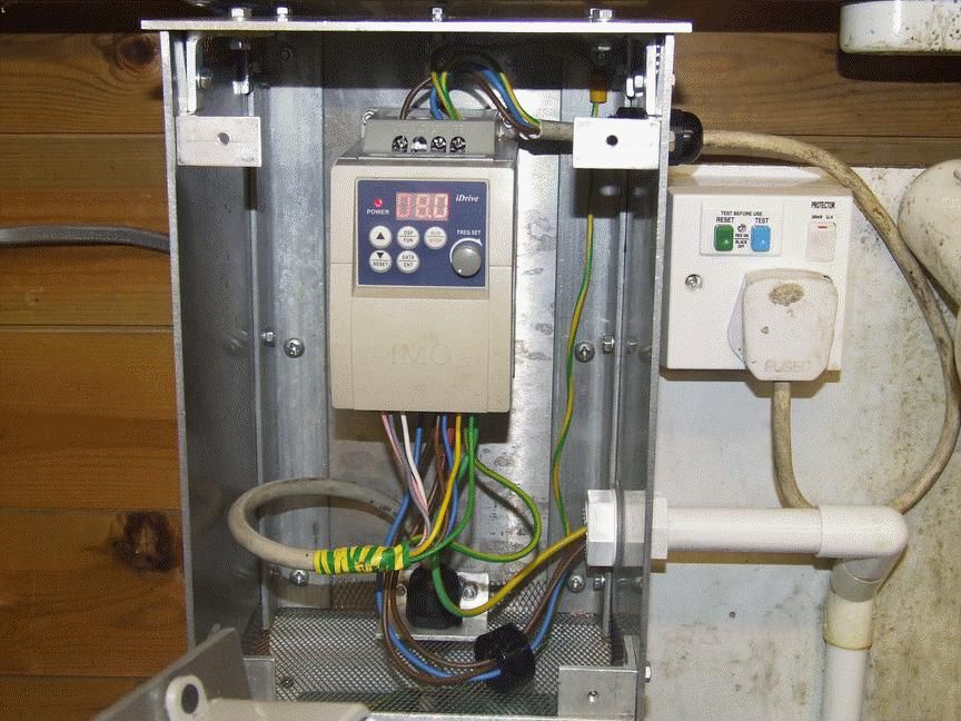

                  #78577
                  martin perman 1
                    @martinperman1
                    Neil,
                    I dont envisage any problems fitting a three phase motor, at the moment , the inverter is going into its own box as I want to fit a potentiometer to control the speeds plus an EM Stop. The unit is fan cooled so the box will also have filter inlet and outlet ports to stop muck getting in, a bit OTT you may think but I work with these units in my job and they will run for ever if you look after them.
                    The reason for change is the flexibility I will get, thread cutting wont be so frightning because of the fast lowest speed I currently have, DC Braking etc.
                    As it comes together I will keep you in the loop.
                    Martin P

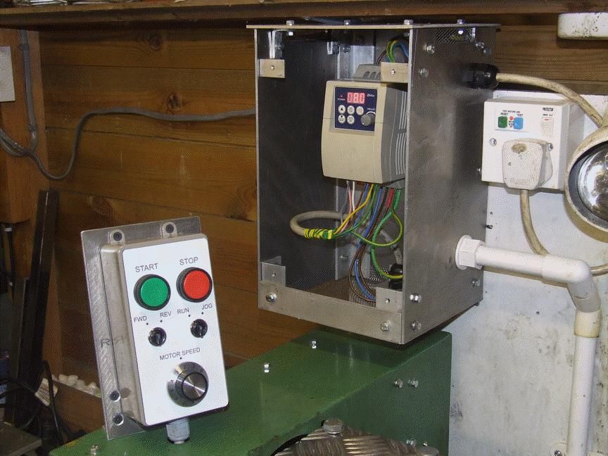

                          #79721
                          John Thorne
                            @johnthorne49048
                            HI
                            I have just fitted a IMO Inverter and 3 phase motor to my Warco WMT300. It was a WMT300/2 until I bought a “proper” mill earlier this year. Very pleased with the results.
