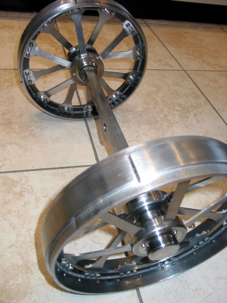

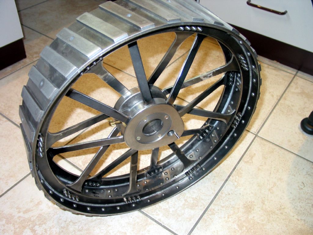

              Fred Nightingale 1
                @frednightingale1
                Hi Chris
                Like yourself I decided I wanted to build a Traction Engine, the only problem was I had very little experience in metalwork but had just purchased a Myford S7. I then spoke to a lot of people on what I should build and they all said "build as big as you possibly can", so I decided to go for a 3" Fowler A7 from MJ Engineering who can supply Drawings and a build manual.
                The good thing about our hobby is there are a lot of nice people like Jason out there who are prepared to answer questions and give advice.
                Since I start about 18 months ago I have purchased a Warco Mill and a ten ton press and things are progressing quite well
                Fred
                PS I have attached a couple of Pics to show my progress.

                  Yes that M300 looked nice but you don't need to own a big lathe to make a big engine. Remember most of the parts are smaller and within the scope of your myford and you can go to an evening class to machine the half a dozen big bits.
                  Did you notice the 3 engines steaming outside at Sandown, all 4in? One Burrell was significantly shorter than the other. There is such a lot of designs it it difficult to get a full appreciation of the differences if you are only looking at one at a time. With such a significant investment in time and money I suggest building up your reference information off the web but hold off a decision until you can get to the Guildford TE rally next year to see 30+ together.

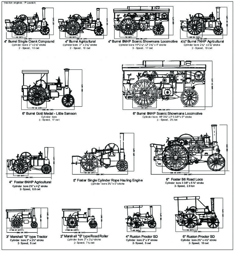

                                    Chris Pattison 1
                                      @chrispattison1
                                      The issue of which TE to model has also been a question I have tried to answer for myself. Clearly, the combination of prototype size and scale have a strong influence, but to my mind the real rule of thumb would be the finished weight of the engine.
                                      The finished weight of the model would dictate how easily the model could be transported and stored. Once this is determined and a suitable weight decided upon, then the decision of which engine can be made – be it a large scale of a small prototype, or a smaller scale of a large prototype.
                                      I would also be keen to see a table of commonly built TE's.
                                      ChrisP

                                          Paul Lousick
                                            @paullousick59116
                                            Neil,
                                            These are a profiles of traction engines. They are drawn to scale to see the comparison between models.
                                            If readers would like to send drawings of other engines, I can add them to the drawing.
                                            Paul.

                                            #181258
                                              That's useful, Paul – clearly shows how one machine in 6" can be smaller than another in 4" scale.
                                              I imagine that the benefits of 'chunkier controls' in 6" scale are useful too.
