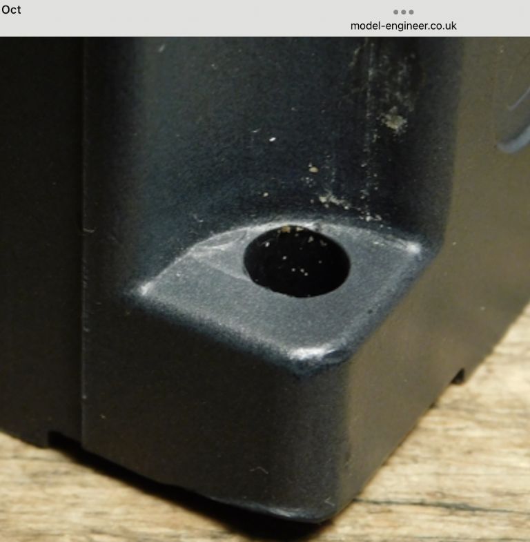

      I am mounting 2 XSY-AT1 VFD's using the 5mm bolt holes provided.
      I measure them with my new 200mm dial caliper.
      I drill them using 5 micron DRO scales for precise location.
      I go to insert a bolt and it doesn't fit. No room for the head.
      Curses, foiled again face 22

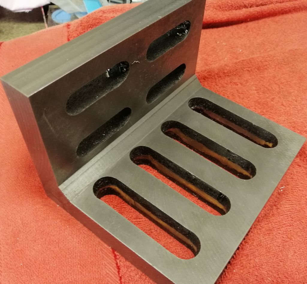

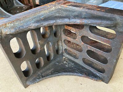

                      I think its a bit unfair to blame the Chinese for this! The HuanYang inverters are a low cost commodity item and not perfect although the hole location is a bit of a howler. I can see also that if you have carefully prepared tapped holes than getting any standard M5 fixing is going to be a bit challenging. Judging from the picture I would say that if you reduced a slotted or Pozi head to 5.60mm diameter it would do the job.
                      I have an expensive set of British made cast iron, machined all over (apart from the slots/holes) angle plates. A large proportion of the slots lengths are unusable because of the fillet between the internal faces. I cannot get to take a picture just now but have grabbed this picture off Google images that shows exactly (Well its 45 degree fillet on my plates but you get the idea).
                      I see the same sort of out of proportion features, like massively wide slots on many pieces of workshop tooling and workholding items like lathe faceplates and machine vises.

                        If you don’t mind my mentioning this, Robin
                        That hole appears to be ‘wrong’ in more than one way
                        Aside from the position, it appears to be oval
                        Are they all similar, and similarly orientated, or has each been ‘dragged’ differently ?
                        … How did you decide which ‘centres’ to measure ?
                        #617082
                        Robin
                          @robin
                          The holes are round.
                          Viewed from below there is a strange slot next to each mounting hole, possibly a mould opening fix which displaced it.
                          I think I may have to make up some kind of counterbore to make way for a reduced bolt head. I have been playing with burrs in my Dremel but I am not very good at the arty farty, freehand stuff sad

                            Posted by Robin on 12/10/2022 23:33:38:
                            Then count me “astonished’ by what I see in your photo
                            … I only had a small glass of Talisker

                            Anonymous
                              Posted by Michael Gilligan on 12/10/2022 23:43:37:
                              Me too – it certainly looks like it's been "drawn"

                                          A hole too close for the bolt head: a school-boy error, which we all make from time to time !
                                          Use a side cutting tool bit* and 'slot' the holes diagonally out towards the corners, keeping the width of the slot the same as the diameter you require, but thus allowing room for the bolt head and a washer.
                                          (@MG: The picture of the bolt hole might look oval, but that is almost certainly owing to the distortion caused by the wide angle lens of the camera and the angle the shot was taken from.)
                                          *I don't know the correct term.
                                          Edited By John Doe 2 on 13/10/2022 10:14:43

                                          Martin Kyte
                                            @martinkyte99762
                                            Posted by Ian P on 12/10/2022 21:33:51:
                                            Ian P
                                            Why would you use a fixing that would fill the slot? Smaller diameter bolts not only don’t wedge
                                            but allow for some sideways adjustment when setting up, turning up some hefty thick washers is the name
                                            of the game.
                                            regards Martin

                                              #617136
                                                Posted by John Doe 2 on 13/10/2022 10:11:54:
                                                possibly JD2 … but the general shape of the casting looks pretty convincing dont know

                                                  Posted by Michael Gilligan on 13/10/2022 12:19:19:
                                                  But is it a casting? or just the corner of the plastic moulded VFD casing.
                                                  Ian P
                                                  #617156
                                                    Posted by Ian P on 13/10/2022 15:03:25:
                                                    Ian P
                                                    Presumably the latter, Ian
                                                    I was concentrating on the geometry and probably used the wrong term.
                                                    [ shame on me ]

                                                    Ian P
                                                      @ianp
                                                      Posted by Martin Kyte on 13/10/2022 10:27:02:
                                                      of the game.
                                                      regards Martin
                                                      I dont think I would ever use a bolt that fits the slot, all the work fixings I use on the mill is far smaller than the slot width. I use mainly M6 to M8 to the odd M12 (and imperial equivalents). I have just measured the lot width on my set of four Eclipse 302 angle plates (picture below) and its 17mm at the face, narrowing to about 15.5mm mid thickness.
                                                      Setting up jobs can be quite fiddly, if I use M8 or M10 bolts the washers have to be specials to span the 17mm slot and the bolts then can be a long way from the end of the slot (so I have flats on the washers). As manufactured the slots do not suit any standard bolts unless one sacrifices some of the slot length.
