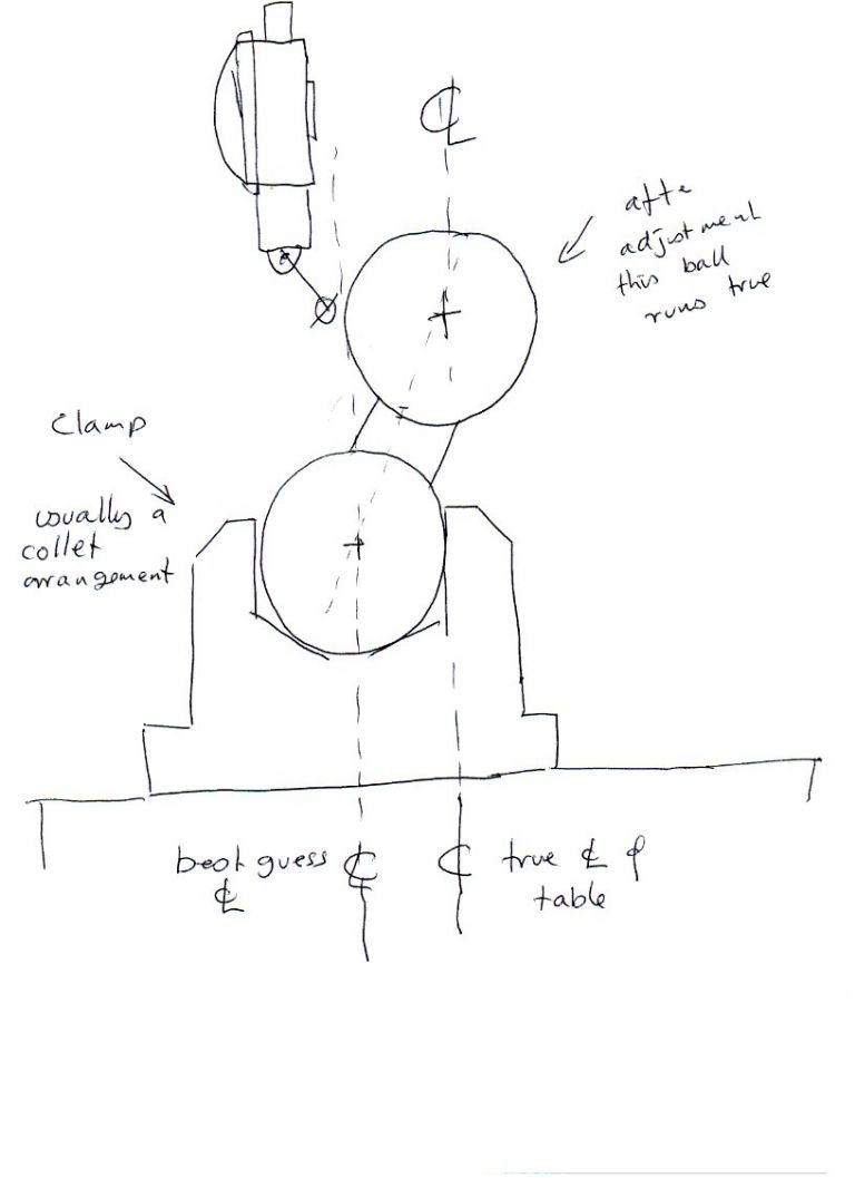

                                  Some of you however might like to try a little super precision and modern technology by making a setting ball .
                                  A setting ball consists of an accurate ball mounted on a short stem and with the stem mounted into one of several different type of base unit to suit particular applications . The stem is mounted in such a way that it can be tilted by a few degrees in all directions and then locked . Tilting the stem effectively means that the ball can be moved a little relative to the base unit C/l .
                                  In use the base unit is mounted on the table or in a chuck and centred by eye . Using a dial gauge the table is rotated and the ball nudged around until it runs true . Ball is then locked in position .
                                  You now have an absolute reference exactly on C/l of table and the whole setting takes about 20 seconds .

                                    I'm having a bit of trouble visualising that – how about a photograph?
                                    How too to produce an " accurate" ball and what size?
                                    N

                                      I see what Michael is getting at. The adjustable "ball on a stick" doesn't make any assumptions that the centre hole in the round table is actually on centre. In an extreme example the "stick' could be mounted on the periphery of the table and the ball adjusted to be over the centre. as long as all the errors are taken out using the DTI as the table is rotated the ball has to be directly over the CL.
                                      Tonight I tried the ball I had lying around. It's about 40mm dia. It was really easy to set up the table and quill on centre and the vice on the table. Clocking the ball with it just laying in the centre hole of the chuck, not clamped in the jaws, and rotating the table gave me less tabout 1 thou variation in 360degrees. That will do me.
                                      Pete

                                        Setting ball

                                            I guess thats pretty much like a ball and socket camera tripod head LINK then with an additional ball attached in place of the camera. Interesting but a little too refined for my humble efforts I suspect!
                                            Thanks
