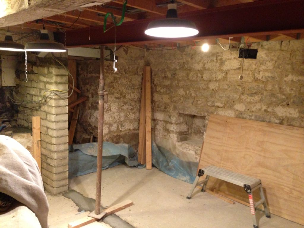

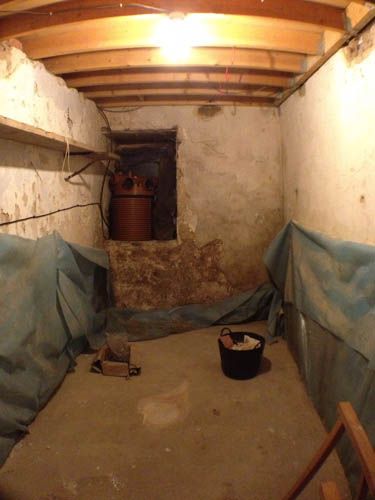

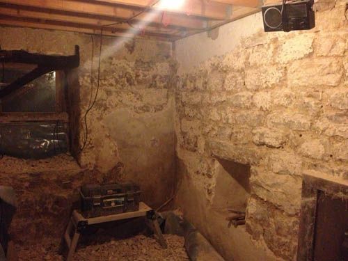

        I have finally redistributed the junk that was in the cellar elsewhere (garage) and am having the cellar tanked . The photos show half the space , the wall on the left is coming down to reveal a similar space. Overall it is about 4metres square.
        I would like a bench with shelves , drawers etc along the right hand wall. Can anyone recommend good benching solutions. I have seen not a bad one in costco , and various ads for custom sized garage solutions.
        Also not sure how to postion the lathe , the window visible is the only one and faces east . I spose i should point the headstock at it but the light from it isnt great anyway.
        The two pictures show before and during removal of the damp lime plaster.

                          Wall is now down and replaced by 8×5 RSJ.
                          I have been looking at
                          http://www.bigdug.co.uk
