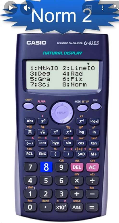

      Anyone here have a Casio fx-83ES Scientific Calculator, and can tell me this, please?
      How to set it to give answers in ordinary decimals.
      Despite down-loading the manual and trying everything it suggests (except the one I want ‘cos it’s not there), plus viewing one or two videos, I could not change it from displaying answers in vulgar-fractions to decimals.
      It is stuck obstinately in vulgar fraction mode, but in the past it did show decimals. I probably mis-keyed something, giving it a peculiar control code.
      Even decimal inputs give fraction outputs:
      3.142 X 3 X 3 = 14139/500.
      Type that in as an ordinary division, and it shows the same improper fraction.
      While [square-root sign]10 merely returns exactly that. Not 3-point-thingummyjig.
      I.e.  The answer to √(10) is displayed as √(10).  (I wasn’t sure if this forum can display a mathematical sign.)
      Err…. Not very helpful.
      Does anyone know how to switch it to decimal answers, please?

        Nigel, Is this any good?…. https://www.youtube.com/shorts/z_V4CAVo4nI ….40 secs long.
        There is a Mute button top left.
        Casio fx 83ES

          There is an answer to the same query here
          They suggest “Change “MathIO” to “LineIO” by pressing the buttons [ SHIFT ] followed by [ MODE ] and then the number [ 2 ] for “LineIO”.”

              Thank you Chris, Peter.
              Sorted now. It gives the result in exponential form (N X 10^x ) but at least it’s a decimal of sorts.
              This seems to fox a lot of people!
              I must have accidentally pressed that S<>D key at some point without realising it; but it is strange that if the Casio manual is to be believed, vulgar fractions are the default setting.
              I think that video is one I looked at.
