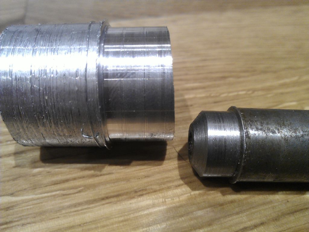

      Having played with a both carbide and HSS tools on my Flexcispeed, now that it is up and running, I confess that I prefer the HSS. I sharpened a tool using a new, healthy bench grinder and wheel which I used to turn the oilers which I made using nylon. I then tried the same tool on aluminium and on steel. I have no idea of the angles on the tool, but it does have a knife edge and no rounding to the end.
      I am pleased with the results and am confident that when I regrind the tool with proper angles, a rounded tip and set the tool height more carefully, I shall get a really good finish.
