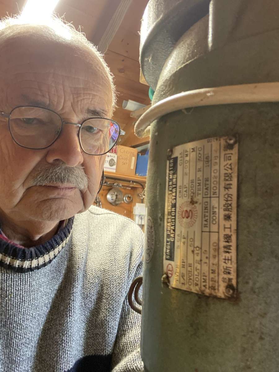

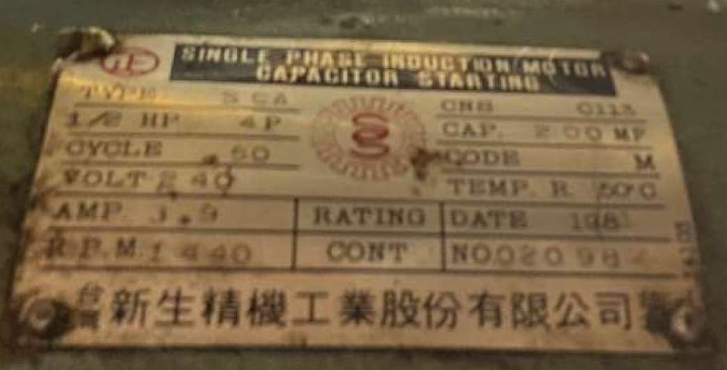

                  Just a bit more info – Motor of Chinese origin 30+ years ago. 1/2 Hp 4phase ?
                  MillMotor
                  #838170
                  larry phelan 1
                    @larryphelan1
                    4 Phase ??????
                    #838174
                    bernard towers
                      @bernardtowers37738
                      I think thats 4 pole
                      #838175
                        Here’s the plate, showing 1/2 HP 4P
                        Screenshot From 2026-02-18 08-25-12
                        I think that’s P for poles not P for phase.   4 poles at 50Hz is 1500rpm, consistent with the 1440rpm on the plate.  (1440 due to slip)
                        Popping an RCD implies an earth leak, and a faulty capacitor could well cause that.  Fingers crossed, because that’s not hard to fix.  Might be damaged insulation in the motor, due to overheating, damp or vibration.  Have a look at the centrifugal switch if there is one – dirt, chafed wires etc.
