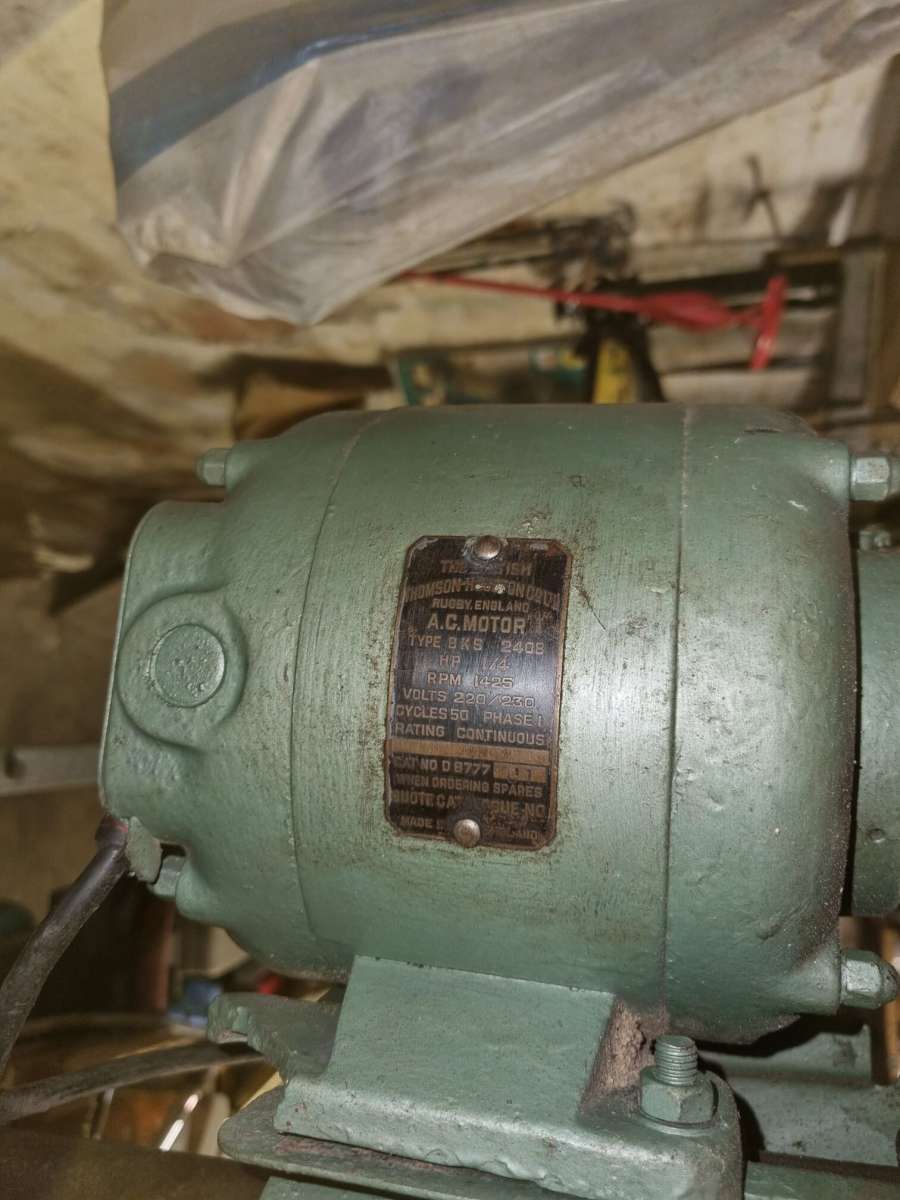

                              Hello
                              I am just looking at renovating my old Startrite Mercury Mk2. Bearings in the motor are noisy (https://streamable.com/q7ch5y – this link/clip will expire in two days) and probably those in the spindle need sorting (I’ll worry about that later).
                              There is obviously some play in the motor shaft  – probably because it has had a too tight v-belt for the last 40 years (I think it was PZ1000 Wedge Belt). I bought a longer belt (PZ1020 Wedge Belt), but it still seems too short and pulling at the motor – so i’ve just ordered a longer PZ1030 Wedge Belt.
                              Anyway – before I dismantle to motor, as the label doesnt mention the bearings, does anyone know the bearing codes?
                              and does anyone have a .pdf of the Manual?

                              #826023
                              Diogenes
                                @diogenes
                                Don’t know the bearing sizes, but (and with sincere apologies if you know this already) worth approaching dis-assembly with some care – it probably has a centrifugal switch at the outboard end, they can sometimes require a bit of fiddling to dismantle..
