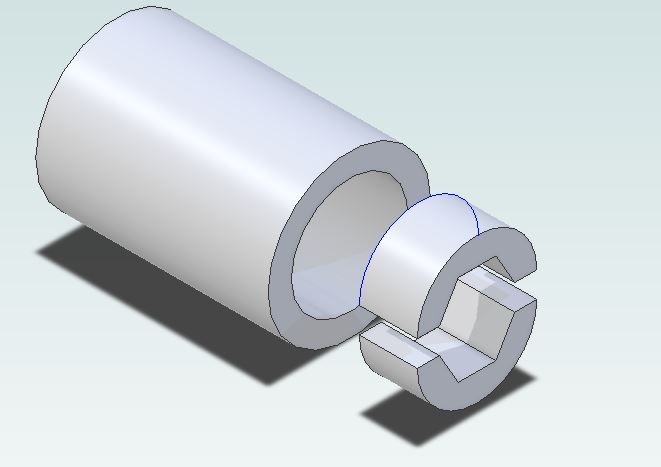

      Hi all
      Is there anyone on this forum that could cut a 11mm hexagonal hole in a piece of mild steel rod either by broaching or other method ?
      The rod is small enough to post approximately 6” and anyone willing and able to do it if they could PM me.
      Bellow a picture of what is to fit in it ,although the hole needs to be approximately 3” deep the hex only needs to be 1/2 to 5/8” deep.
      Thanks in advance Dell
      update I have a 11mm rotary broach with a 16mm shank but the holder is to expensive for just one job.

          Do you have a pillar drill or milling machine Derek? You can make a basic broach driver using some scrap stock and a ball bearing. Simply drill an off-set counterbore in the stock and load it in your drill/mill then make a similar one for the broach but with the hole central, and put the ball bearing between them with some grease for lube. I've broached a couple of things like this.

            Just thinking outside the box a bit – if a rough and ready tool would do for this job rather than a beautifully finished custom broached job, here's an alternate idea. Buy a cheap deep hex socket from a hardware store or auto supply. Turn and bore a shank of mild steel, or find a piece of pipe the right ID and OD. Cut the square drive section of the socket off with a cutoff wheel in an angle grinder or Dremel type tool. Weld or silver solder remaining hex portion of socket to shank / pipe. Tool made.

                the tool I want to make is a clock mainspring winder to get the mainspring out of the clock barrel for servicing and or replacing so I will be using it quite a lot .
                although I will be using the tool I made regularly I hopefully won’t be using the broach more than once that is why the tool company said I should get the 16mm shank broach and it SHOULD be strong enough to press in , but I would prefer to do it or have it done with rotary. Broaching as I understand it would do a better job job.

                  Another option is to just mill half a hex into a semi circle of steel which is quite easy to do and solder or even loctite two of them into a hollowed cylinder.
