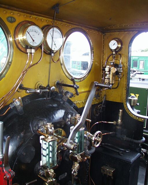

                                        #91586
                                        julian atkins
                                          @julianatkins58923
                                          A1X newport cab
                                          #91587
                                          Robert Thompson 3
                                            @robertthompson3
                                            Wow Thanks for that Julian
                                            Bob T
                                            #91588
                                            julian atkins
                                              @julianatkins58923
                                              have a look at
                                              http://www.bluebell-railway.co.uk/~uhaa009/bb/pics/terriers.html
                                              which is where the above pic came from.
                                              as might be expected the Terriers underwent numerous detailed changes over the years, as crosshead pumps were replaced by injectors, and vacuum brake ejectors fitted in addition to the westinghouse air pumps, but essentially Stroudley's original arrangement and design was retained. Boxhill has been faithfully restored to original condition in the NRM. note also in the above link of pics how the martin evans reverser is nothing like fullsize, and note the rectangular firehole with 'Webb' type door, and the large radius to the backhead. the curved cover over the backhead actually acts as a saddle and has the tanks bolted to it, taking their weight, which is why there are no brackets to speak of underneath the running boards. note also the 'quadrant' type water valve handles in each corner half way up the front spectacle plate… these originally controlled water from the tanks to the pumps, and were re-used when injectors were fitted.
                                              cheers,
                                              julian
